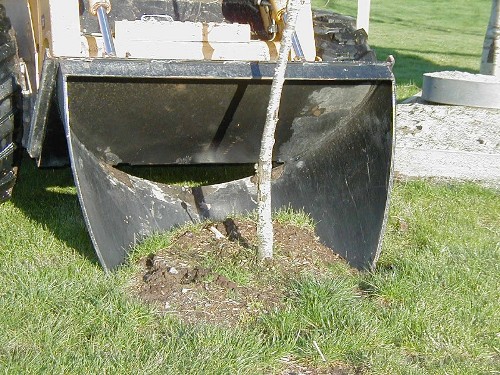

I'd like to find an affordable way to make a "tree/shrub scoop" -- I have plenty of little saplings I'd like to transplant...

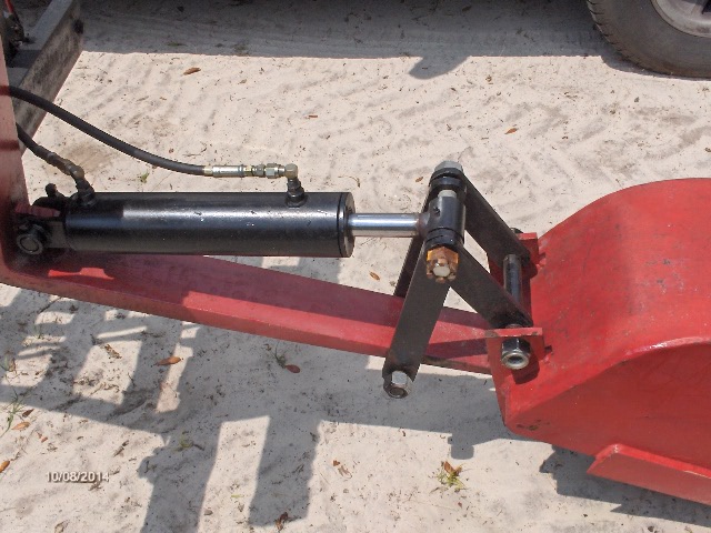

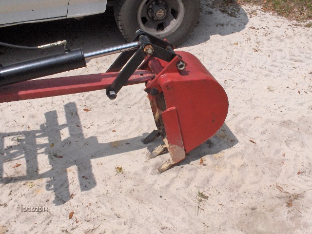

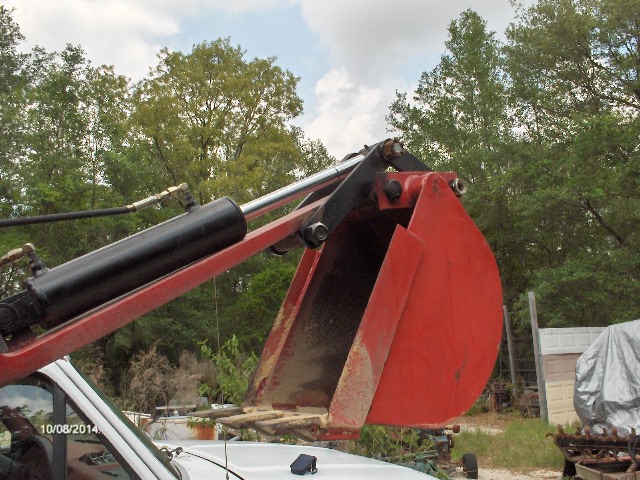

This is a Mini-hoe I built using a forklift carriage, and one of the forks. I welded a plate in the corner to connect to a cylinder. At the end, is a roll over tube and bolt for the bucket. The bucket is 12 in wide, and 22 in long. I am using the aux control to curl the bucket, and the joystick for up/down, and tilt. It can be taken apart in about 20 min for some other use. The fork can be used any where on the carriage, like for digging up close to a building, etc.

I think the reason that my buckets brackets are different than yours is because the different combinations of bucket tabs. I have made about 6 sets of brackets at different lengths, to try and get the best open and closed combination. The lengths also determine the speed of the bucket curl, and the torque applied. They can be same length, or a combination of different lengths. I am just doing this by trial and error, or best fit. I wish I would have paid more attention in geometry class. I also intend to install a grapple arm. I can take more pictures if necessary. Just a note of interest, if you hold down the Ctrl key and roll the thumb wheel on your mouse, you can magnify or make small, the page or picture, many times for better viewing.
The brackets are 1/2 in thick, with 1 in holes. I cut them out with a carbide hole saw.
Here are some more pictures.
007 - full curl
002 - full open
014 - vertical

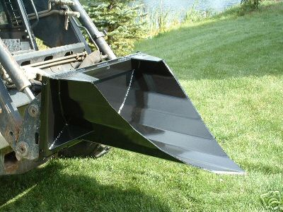

Here is a picture of a large scoop. You could reduce the scoop down to any size, and weld it up on a quick attack plate. Take a 1/4 plate steel and cut it into a shovel, and weld. It can be rolled or welded in three separate pieces.
Pretty slick that's one of the tools I have in mind and need around here, as Kent says for shrubs, saplings ect.. How well does that dig in and cut through roots ?? :eek:
   / Members home made attachments / improvements #19
It would depend on type of soil, thickness of the metal shovel, and force applied. I would say dig in at a 45 degree angle on two or three sides , apply lots of down force, and wiggle the front, and lift.

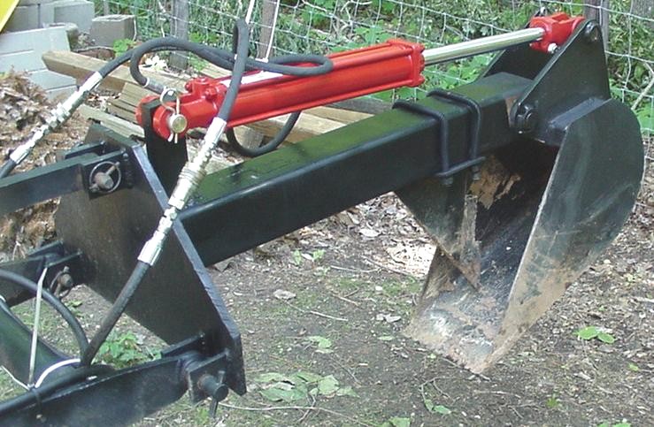

David, Here is a picture of a mini-hoe that dosn't use any brackets.
The bucket just has large ears. Looks very sturdy.
