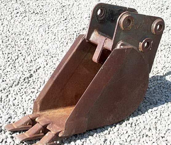

   / Members home made attachments / improvements #25
Barryh said:
I'm interested in this one too, as I plan to do a simple mini hoe along the lines of your fork lift hoe creation, just using square extension tube that plugs into a trailer hitch... For me the simpler the better. I'm not as interested in speed, as much as open / closing strength. :eek:
This bucket has three sets of holes for different applications. It would still need some roll over brackets.

   / Members home made attachments / improvements #28
Barryh said:
Here's the bucket I'm buying, if you scroll down to the 8 inch version. It has ears so it shouldn't need any linkage? Lackender Skid-Loader Backhoe Pricing
I'm not worried about transport as I will just take it off as a unit when I want to transport it. I only need just enough curl to dig three foot down, and hopefully I'll be able to see what I am doing.
You are right. That bucket that I posted earlier, looks like a Lackender bucket. It would save on trying to figure out the correct linkage. A 4X4 , or a 6X6 in , 1/4 in wall tubing should do the trick.
