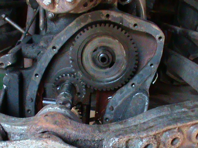

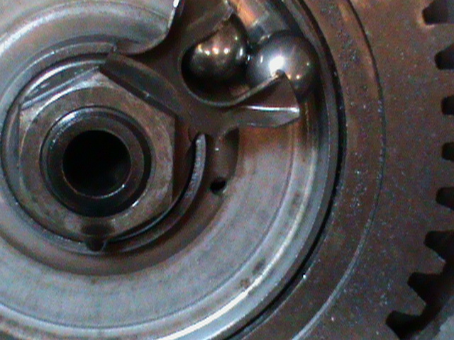

metal piece came out of oil pan when changing oil
   / metal piece came out of oil pan when changing oil #51
luckilly that governor is real close to the oil sump.. likely it all fell out and went safely to the bottom.. like the titanic.. :)
   / metal piece came out of oil pan when changing oil #52
I tend to agree, everything may be ok unless a piece somehow managed to find it's way into the aluminum oil pump gear, which could be easily damaged.
   / metal piece came out of oil pan when changing oil #53
you'd already know by now.. same with the timing gear...
   / metal piece came out of oil pan when changing oil #54
G'day I want to know where all the balls went?????
Jon
#55

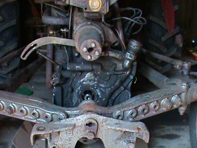

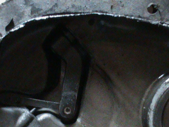

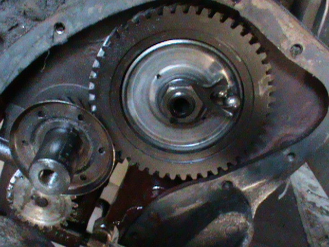

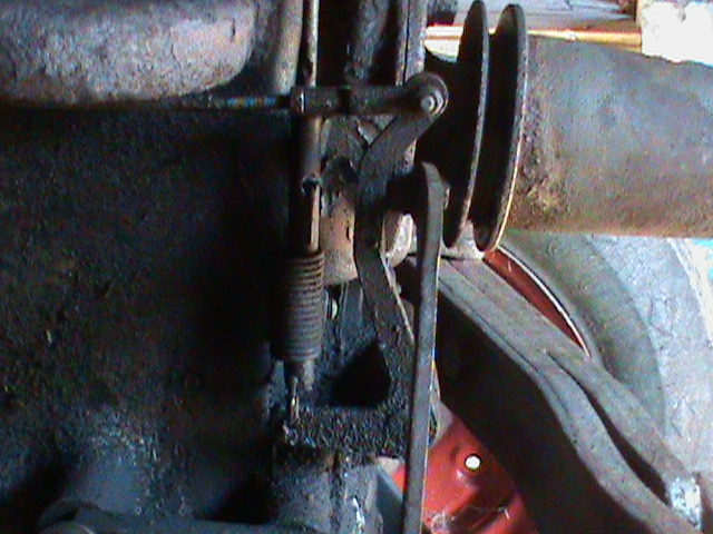

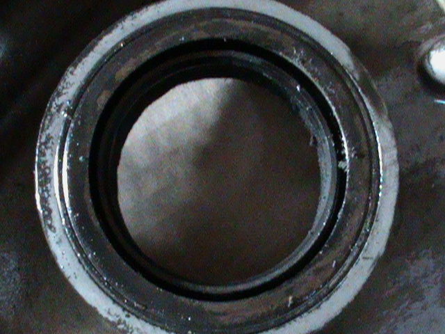

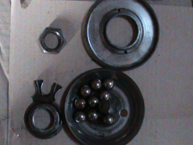

Here are some pictures of some progress ,there were 2 balls left in the assembly and the remaining 8 were at the bottom . Things look good as far as no major damage to casings and gears. A little play in the oil pump gear between teeth on crank teeth.

   / metal piece came out of oil pan when changing oil #56
yep.. I figured they'd be inthe bottom...
#58
everything came apart pretty good ,now I should clean everything up.Thanks .
#59
I did notice a newer gasket sealer was used . This has been apart befor . I'll have to check out a gasket kit ,governor assembly ,case seal
   / metal piece came out of oil pan when changing oil #60
prev owner may have 'serviced' it and not put it back together correctly.. no keeper or something..e tc..
I just love taking something apart.. especially something delicate or expensive/difficult, and seeing rtv extruded out the sides of the case cover.. :)
