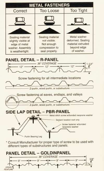

   / Metal roof installation advice #27
Around here you will see the same metal roofing material done both ways. The manufacturer recommends in the ribs up here but you still see them installed both ways. I think its easier for contractors to go on the flats and thats why they do it but the preferred way is in the ribs according to manufacterer. I am building a steel building myself and am trying to figure out which way to go. havent decided yet but i wanted to put it on 3/4" OSB on the roof do you think that will hold it? Another thing is if your going on the rib you cant tighten anyway because you will squat it so its not like you can strip out the screw.
Mike
   / Metal roof installation advice #28
Mike
This is the problem with screwing to the ribs instead of the flat. You can not get the screws tight enough on 29 guage metal to seal it from leaking without squashing the rib. On 26 guage metal you can just barely get it tight enough without squashing the rib. My manufacturer reccommends screwing corrugated through the high part and screwing r-panels through the flat. Attached are copies of the manufacturers instructions.

   / Metal roof installation advice #29
shvl73 said:
Maybe in high wind applications but, 29ga. has been used for years and 1" screws installed in 1" purlins seems to work well. Putting in enough screws and not skipping some, as we've seen suggested here, and double screwing the eave as shown in the installation guide is the way to go. I do think the 1" screws are easier to strip out and that 1-1/2" installed in 2x KD purlins might be easier for some.
Our building code does not allow 1x4s to be used for purlins nor does it allow 29 guage to be used for roofs. He is using 1x4s 12 inches apart instead of 2x4s 24 inches apart. This means twice as many screws for the same strength and twice as many places to leak in the future. 29 guage also requires 50% more screws than 26 guage for the same strength meaning 50% more places to leak in the future.
   / Metal roof installation advice #30
Tally,
Great instructions on fastening metal panels!!!! You know the saying, a picture is worth a thousand words. It's true with your post for sure!!!
Eddie
