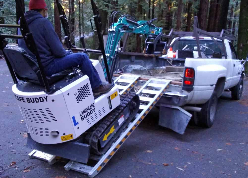

Im going to try and build myself a mini digger, similar to the one pictured.
Its a small machine with just under a 2x4 base, powered by a Honda GX160.
Without the tracks - given the cost of the tracks, motors, roller wheels, sprockets, rotary union, and a turret bearing large enough for the union, it'll have 2 roller wheels and 2 legs.
Anywho, I was going to use 1/4" steel plate, but the pictures look like it might be a 5/16 or 3/8 (or, given the country of origin, 8 or 10mm)
Think 1/4" would work?

I was thinking about using the same material on the whole thing (or, "body)
I have about 2 sqft of 5/8th plate, anything else I would need to buy.
Local metal shop doesn't have scrap, and only sell 4x8 sheets. One sheet should do it, and given the cost, I only want to buy one.
It looks like they did the same thing here, as the boom and base are all the same thickness.
Ill be using it in the Arizona sand to dig trenches for sprinkler pipe, and a future block wall footing. Past that, just random digging projects.
I have a ditch witch now, but its absolutely miserable in the sand. Its like Atreyu trying to pull the horse out of the mud in The Neverending Story.
I've thought about mounting a winch to it, so it can pull itself along. If I can successfully build this, selling that clunker should mostly pay for it.
A mini excavator would 100% serve me better, but they are $20,000 on the cheap side; but most listing I see are $28k+
Even used Bobcates are over $30k locally.
Give the cost, storage, upkeep, this tiny machine would serve me better.
(also, this new is about $14,000 + shipping and import)
Pic here, looks a bit thicker than 1/4"
I like that the hydraulic tank is the seat, but I don't see a filter....

Maybe the scale of the thing isn't coming across. The operator platform (or cab?) is less than 2'x4'
I put the images into Fusion 360, and calibrated using the known base dimensions to get the dimensions of the boom and arm, I don't remember what they are, but the boom is just under 3' long. Where its pictured driving into the van, at that stance its probably 7' long.

So you think I should use 2"x3"x1/4" box for the boom & arm then?
