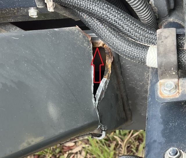

Just a bad design as previously stated. Even if new replacement uprights were obtained, I would seriously look at some reinforcing to prevent this issue. I'm not a fan of these FEL mounts that have no supporting structure to the front of the tractor.

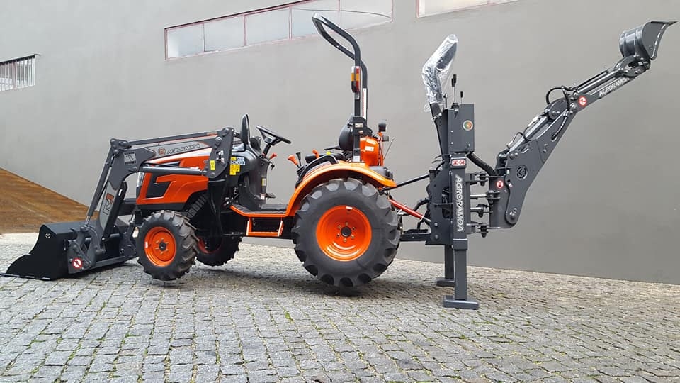

Commercial backhoes are built a little differently than a 3 point hitch mount BH. If the tractor BH has a subframe mount it's all good however, if it's a 3PH mount with no subframe (like the picture shows), the game plan is much different and the chance of casting failure becomes much greater and that is why subframes are supplied with all OEM backhoes today.
Not that I have one because I don't. Did in the past but it's long gone.
Oh okay....I don't know anything about three point hitch backhoes. I would never buy one of those. Mine is subframe mount.

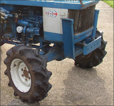

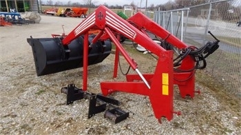

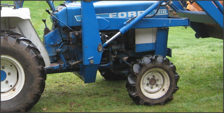

I never really looked at the modern loader frames. I didn't know they made some with no nose bar. The nose bar on my Farm Hand loader would stop that from ever happening. Mine looks like this one, just not as pretty.
Yes the FEL nose bar is not pretty and is sometimes a pain, but it clearly does it's job!
Here's 1986 model with no loader frame support issues so far, and for sure it's been tested to max many times...
