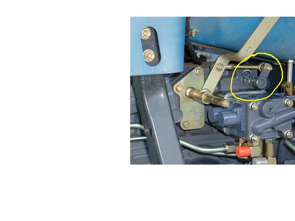

There is a solution for that stiff 3pt lever. Take the cotter pin out of the castle nut and loosen it a few turns. The 40D is at the property, but I'll go out and take a picture of the 29D so you can see what I'm talking about.
   / Where the TC45D is NOT deluxe #58
Here's a photo taken when I was installing the rear remotes. I've circled the nut in question. Note that I have replaced the standard cotter pin with a removable clip. Anyway, loosen the nut until the lever moves to your satisfaction, but not too loose, or it may move on it's own due to vibration.

Thanks for the photo. I'll have to try that this weekend, if I get a chance to go play!

John, the picture looks to me like you had the right rear tire off the tractor. I've slightly adjusted a similar nut on my TC45D, but wasn't really convinced that it made any difference at all. I can see by the geometry of your control arm connections that you have one less pivot point than the Class III Boomers. Before I reinstall my operator's platform this weekend, I'll see about adjusting mine again, because it is right out in the open now. /w3tcompact/icons/eyes.gif
