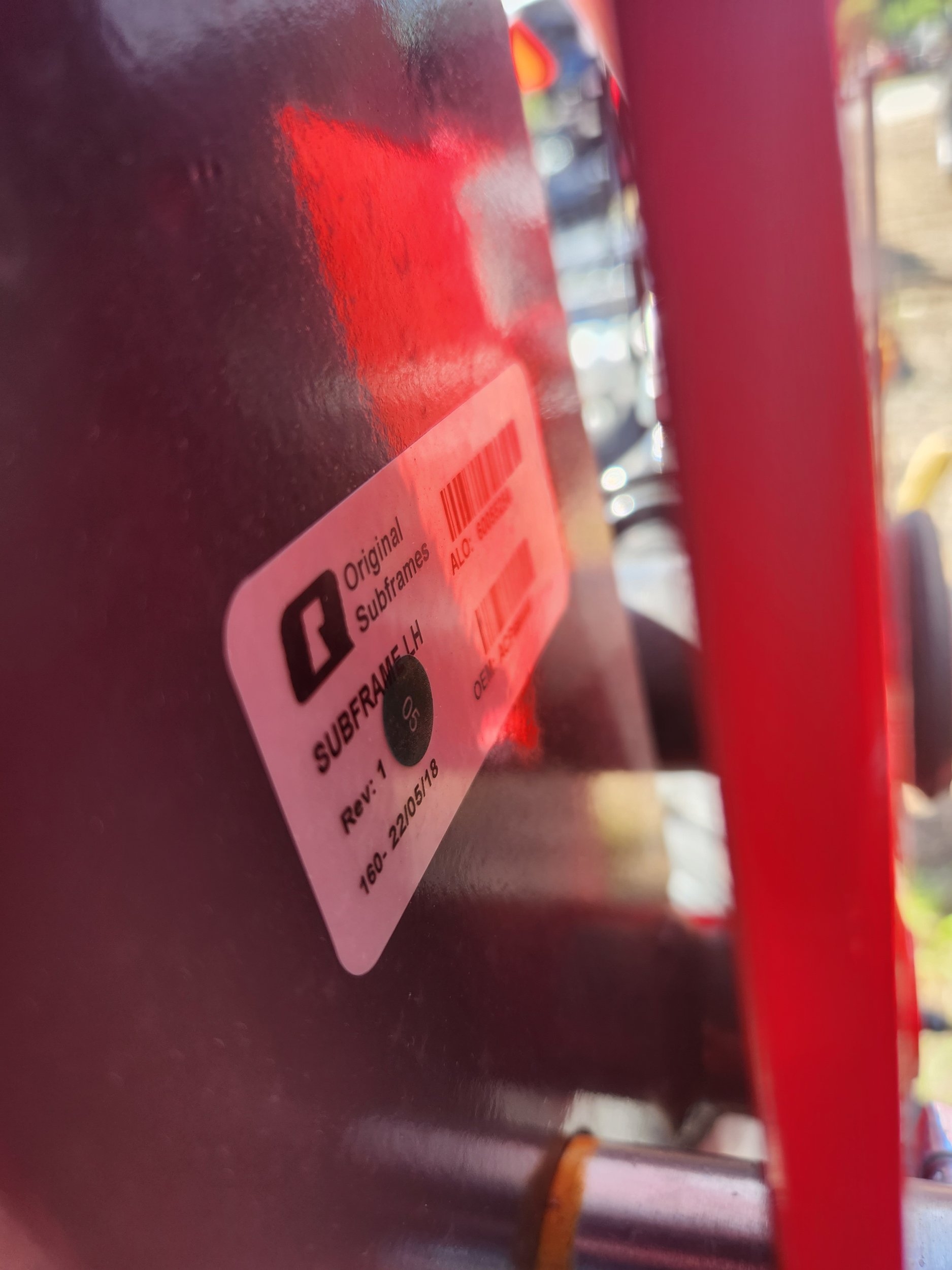

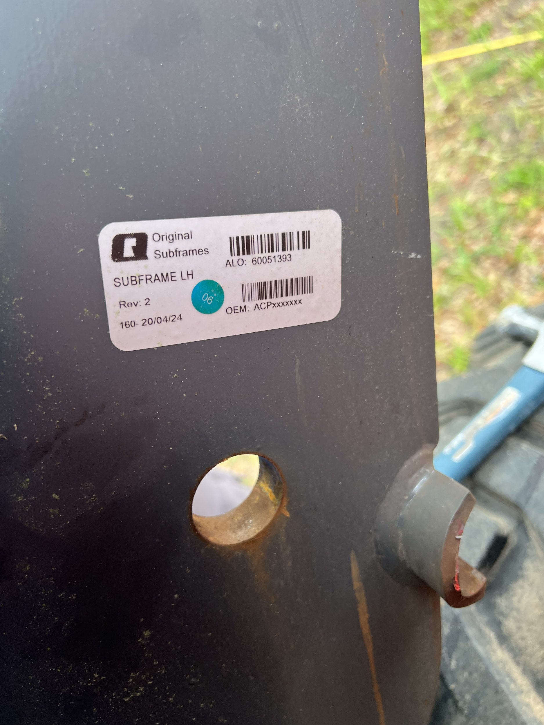

So I stopped by my Massey Dealer and all the 18M's had Rev 1 loaders on them, all 3 of them.
Also, not only do the 18E series use tube shaped loader mounts, but so do the 2800 series, so I don't know why it's changed up for the 18M.

The steel looks very rough. Poor quality? China?
   / MF 1835M loader support collapsed on tractor #154
Those frame assemblies are probably shipped in from China. That older/rusted area at the top is the area with the most load when carrying material with the bucket and hitting some bumps along a traveled area. Looks like it came that way and covered with black paint. Yellow is nice, cracks are easier to see.
Automated production and not enough inspection.
Someone mentioned that the hydraulic relief valves are not used except when the lever is pulled. I haven’t seen the valves on this machine model but all the ones I have worked on in the last 55 years had circuit design with relief valves being in the circuit at all times. Kinda useless otherwise.
All in all that is a defect that they should jump on!!
I've worked on a lot of loader valves that have load checks. A load check is to combat settling but it also effectively isolated the down circuit from the relief. At any rate the material in those towers is so minimal that a cold weld is very possible because the slightest amount of undercutting would certainly be an invitation to failure.
