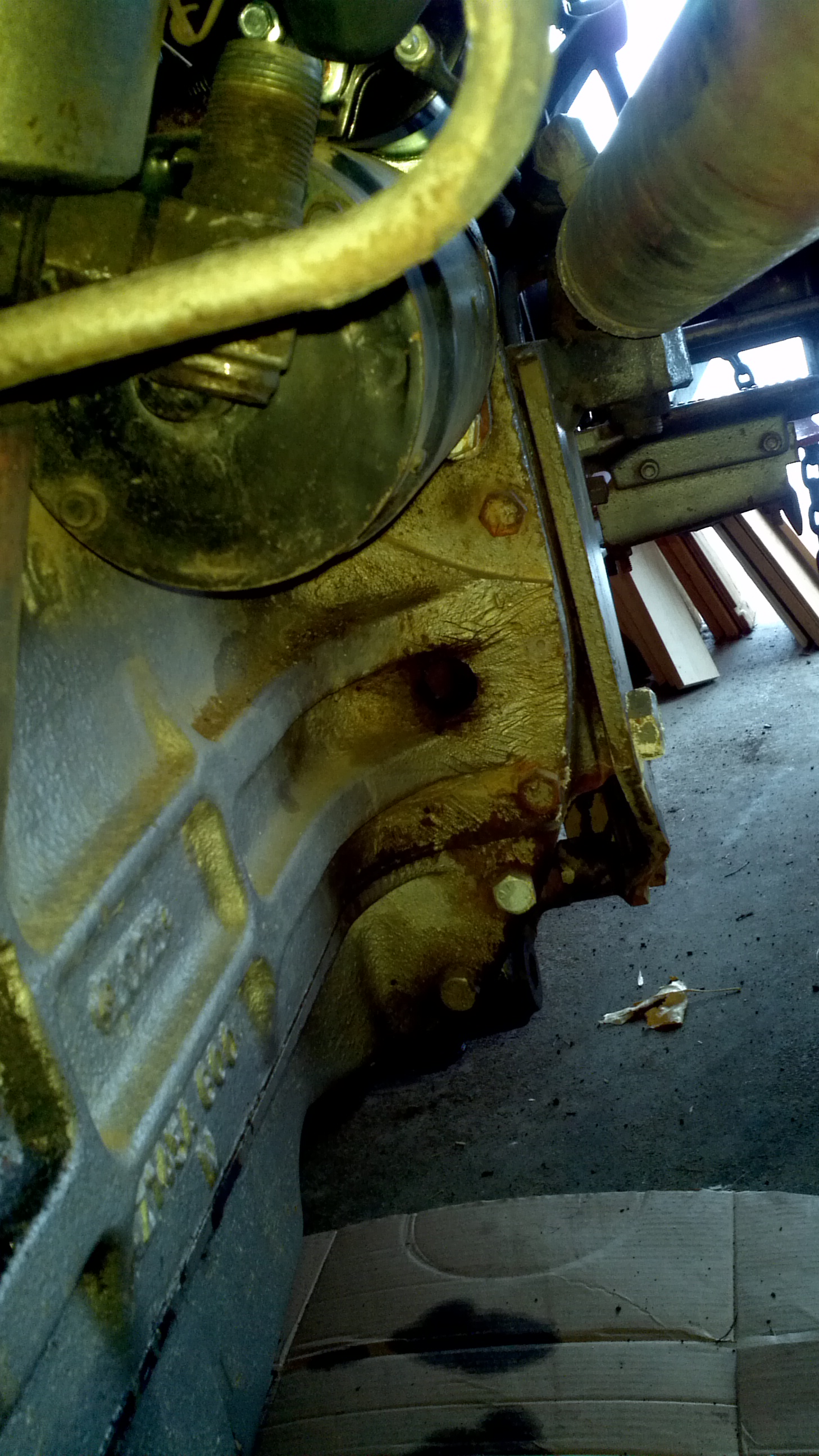

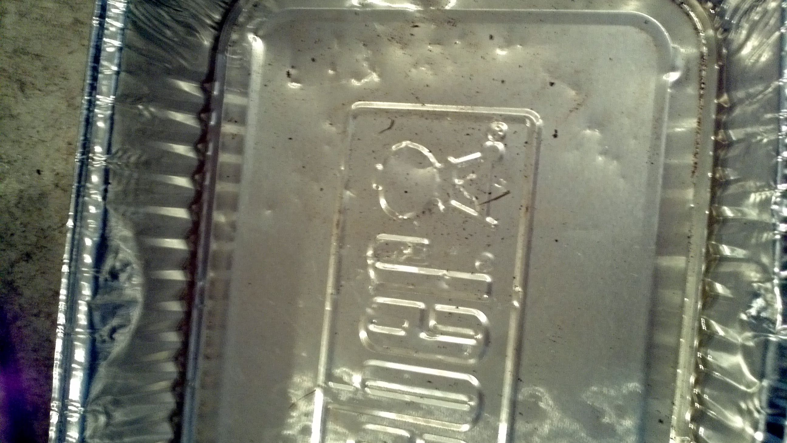

There's plug just under the starter right where the engine meets the transmission. Pop off the cover and you can see the degree scale. Mine had a nice white mark at 6 degrees.

I believe you'll find the distributor turns CCW and if the firing order is 1-3-4-2( generally the numbers are cast into the block), make sure you have that correct. it looks to me like you have 1-4-3-2 currently. You said you set the timing at 6 degrees. Was that BTDC or ATDC? It should be BTDC.
What's the thing that looks like it's attached to the distributor in the first photo? It looks like a connection for a vacuum advance. If it is you need to either connect that to it's vacuum source or plug the engine end of that or it will lean out your mixture.

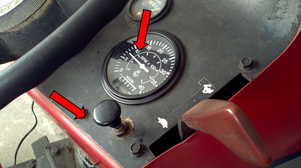

It's 6 BTDC. The add-on piece to the distributor is the mechanical tachometer drive. The gear in that unit failed, so I've replaced the mechanical tach with an electronic version that triggers off the coil pulse. I looked for a vacuum hose for the timing advance and couldn't find one so I'm guessing it's a mechanical advance. I don't exactly know how it works, but I know that it's working based on the timing advance I see on full throttle.

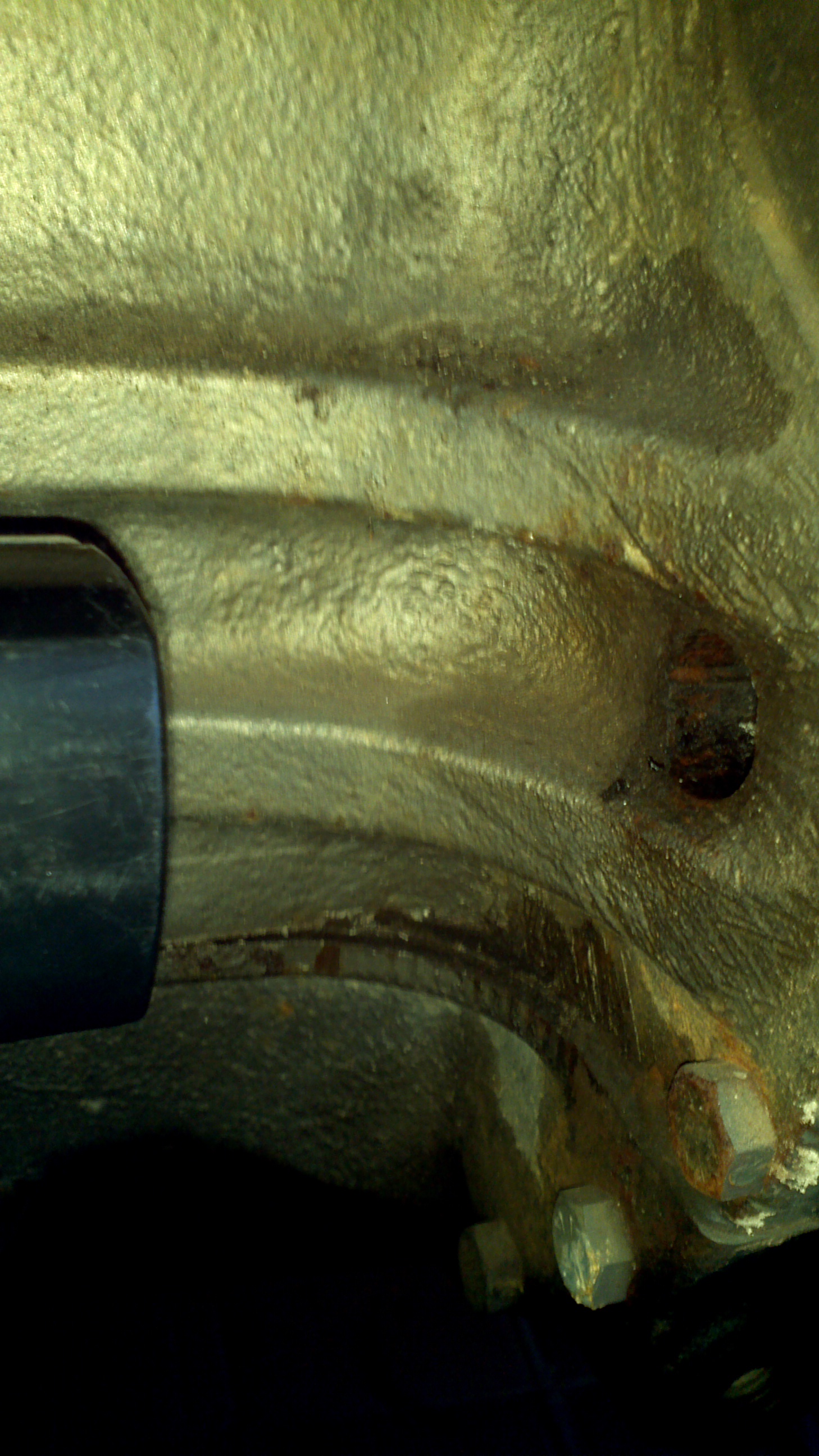

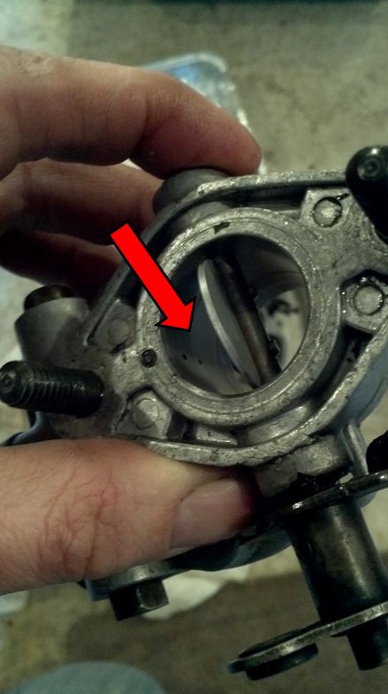

I put a red arrow to highlight the gasket paste. When I pulled it off I thought for sure a good cleaning and new gasket would solve my problems choke problems, but no such luck.
I got the primary jet out and verified the float, but I couldn't get the idler jet out. I cleaned it thoroughly and verified it wasn't clogged (carb cleaner drained through it). When I put the carb back on and she fired right up with the choke on, but when I tried to lean it up (no choke) she starts to sputter and will eventually die. The throttle works fine and I can get near full RPM. My understanding of the Zenith 13800 is that there is no mixture adjustment. All documentation I can find says the idle adjustment (green arrow) is the only adjustment. Do you guys agree?
I decided the next step is to check the intake\exhaust manifold for leaks. My gasket finally arrived today and I pulled it off. Sure enough, it appears that I've got some leakage around cylinder 1 for sure, but maybe also on 2 & 4. The gasket itself didn't look that bad, but I'm wondering how tight the manifold was bolted. I was going to clean it up and put it back on with the new gasket. Do you guys know the correct torque ft lbs?

Success!! I'll write this up just in case somebody else runs into this same problem with their Massey 230. First things first. The Zenith carb is a 68x7, not a 60 or 161. I ended up buying a Zenith carb manual and found this sheet.
Most of this wasn't new info to me except that you should be able to remove #15 Idle Filler. I still have no idea how as I couldn't do it without damaging the tube. I left it in and just sprayed the heck out of it. I decided that my problem had to be relate to the idle jet (#40) as that's the only one I couldn't get out before. No change there. I tried spayed it down and tried to unscrew, but I could tell that the jet was starting to come apart at the screw top.
So I just stuck the carb cleaner straw in and put paper towel around it (to catch blow back) and sprayed for ~15s continuously about 5 times. I had previously soaked this jet, but that wasn't enough. The output of the idle jet is two holes by the throttle body.
After a couple of spays I could tell that something had cleared as more and more was getting through. Who would have thought so little could cause me so much trouble.
I also noticed that a Massey really wants to be warm before you can pull the choke. I'm used to using choke for <30 seconds on other equipment, but this tractor wants to be warm (~3-5 minutes) before I could completely remove it. During that time I was slowly adding and removing choke while listening to the engine to determine if the mixture was better or worse by RPM. I didn't have much luck with the idle adjust (#3). I'd rotate and out without much difference. I think I'll save that for a warmer day.
