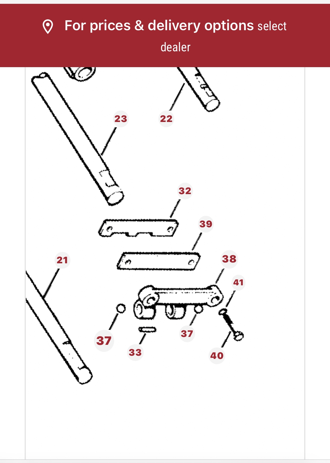

You could try changing inter lock first if I remember they wear but if rods are worn might not make any diff have also
Seen them broken

I will try and get you pic of interlock on backside so you can see it

Part 32 and 39 I have seen broken and cracked 38 is the interlock supposed to keep them so you can't get stuck in gear
