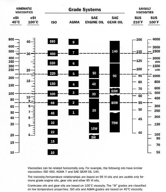

The front end lives an easy life from a lubrication stand point. If you are in a cold climate lean toward the hydraulic oil and in warmer climates the gear oil is probably fine. The oil in the front end of a tractor is a non issue.
There isn't an advantage between those two products, due to cold, or warm temperatures.
If your statement is based on the popular belief that the gear oil is heavier, it's incorrect.
Gear oil is not measured on the same scale as other oils. This leads to the misconception that since transmission oil, generally runs about 30w, and the gear oil is 80-90w, the gear oil is thicker. The reality is, the difference is negligible, at normal temperatures.
How much difference, depends on exact product you use. The actual viscosity of a given product also varies widely by brand. So, if you compare two quarts of 30w from two different companies, they can have a completely different viscosity.
There are some products like Kubota SUDT transmission oil, that actually are slightly thinner than most brands of transmission oil. But, even it is not enough to matter very much in this application.
For those who are concerned about temperatures, synthetic oils are where you can get an advantage. But, it still has to get really hot, or really cold, for that to come into play. Most of us are not getting into that range.
For the vast majority of owners, as you said, it's not an issue what you use here. We now have many hours, over many years, with people using lots of different products to support that.
