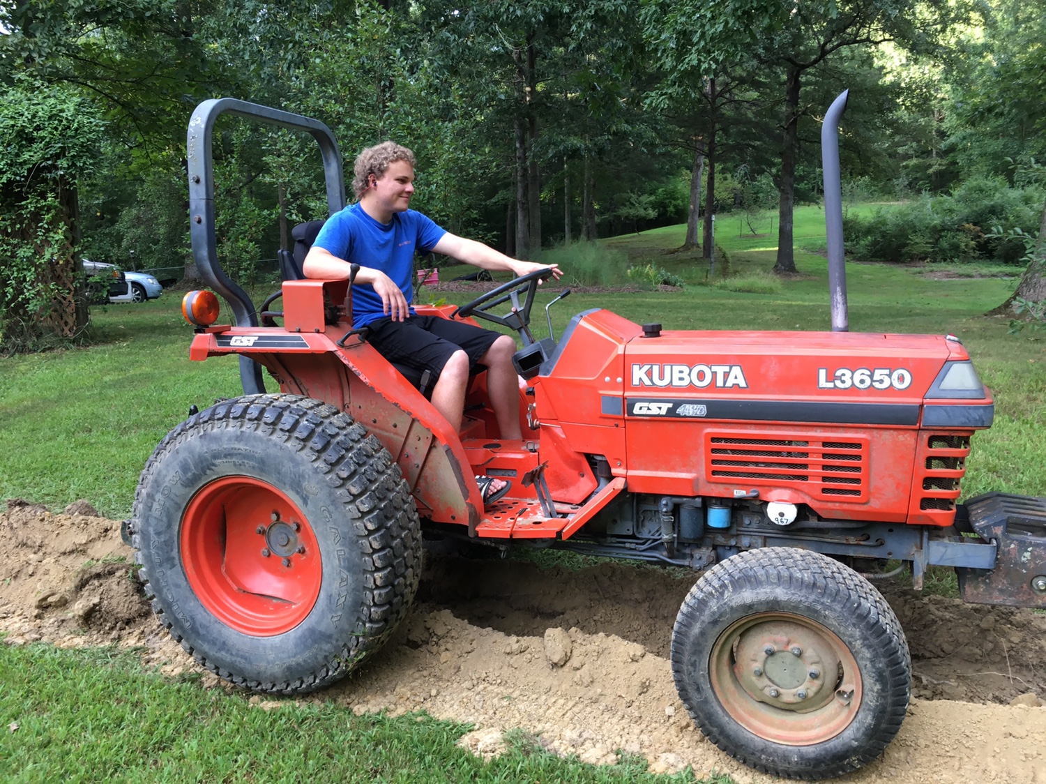

/ Middle Buster #7
I needed to put in a curtain drain and a gutter drain
We first ripped the path twice with the subsoiler. Our ground is rocky clay.
Then we used the middle buster or tater plow as we call it to open up the ditch.
My son did the tractor work and I supervised.

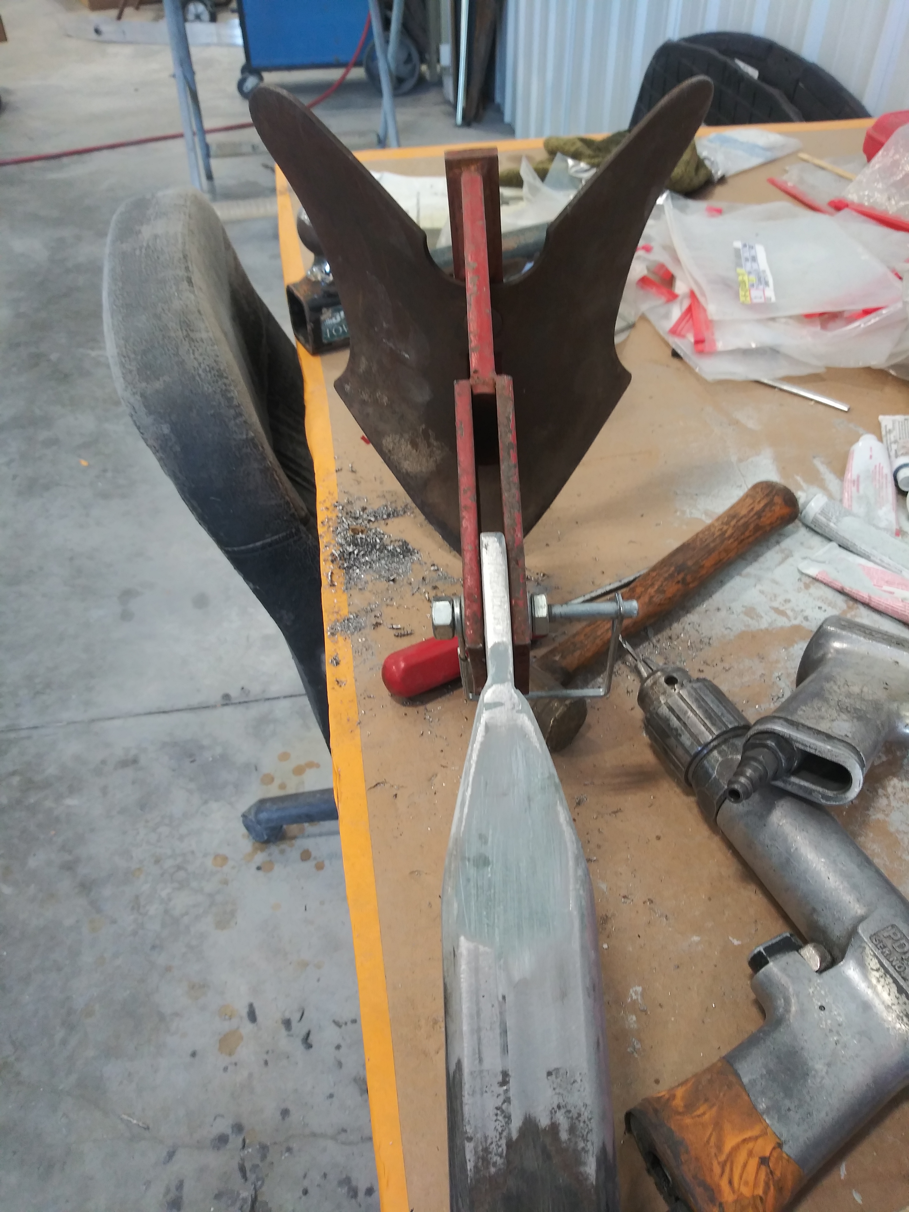

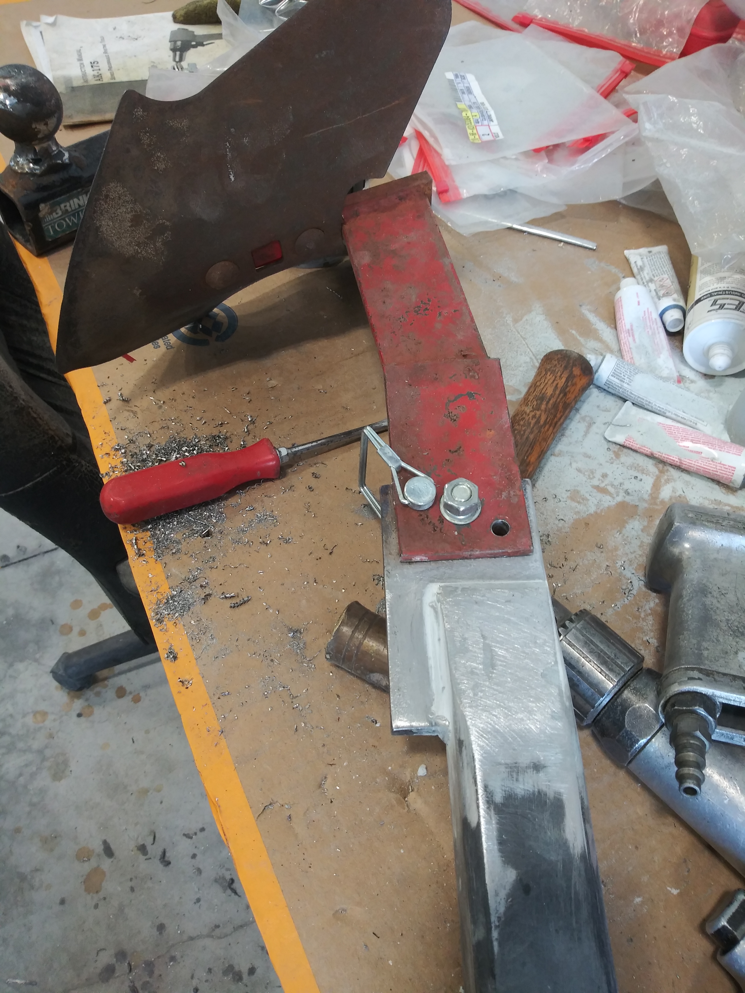

#13
I decided to make my own with some parts I bought and some made, Im gonna try it out this weekend. Might be it wont go deep enough but if it dosent Ill just make some more mods. Thanks

/ Middle Buster #14
I’d suggest welding the whole thing solid. There’s close to zero chance of that little pin holding up.
/ Middle Buster
#16
That pin is not being used other than for reference, Im making it adjustable to see what angle is gonna work best for the digging.
