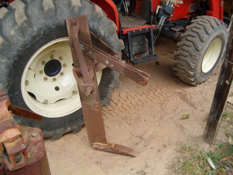

The points are interchangeable on these as well.
I don't think you can just change the blade tips. I have the same king kutter middle buster and did order a sub-soil blade tip but it does not fit correctly. You can only use one bolt and the blade is to long. You can even see this on your pictures that it will not fit. I'm still going to use it with the one bolt and hope I don't shear it off and loose the tip.

Here's the picture of the middlebuster and the extra chisel point that I got for it. It did fit but I'm going to switch it out for a subsoiler this week.
   / Middlebuster Vs. Subsoiler #14
I didn't measure it but I leaned it up against the rear wheel of my Century to kind of give you an idea of the size. It is a hard chunk of metal to lug around, not sure of the weight either. /forums/images/graemlins/cool.gif

   / Middlebuster Vs. Subsoiler #15
This pic might be a little better.

That chisel point was $9 if I remember right. It looks like it would do some serious digging.
   / Middlebuster Vs. Subsoiler #18
Just my recent experience - I bought 1 each of the middlebuster and the subsoiler from TSC, the King Kutters. I used the subsoiler on my Mahindra to break-up chert rock mixed with clay so I could get it out with my loader & boxblade. It is pretty dang tough - I ran it buried as far as it would go and when I hit a big rock it would stop the tractor momentarily - I stayed in a very low gear and constantly worked the depth with my hitch - it worked fantastic for me. Having the hydraulic toplink made a big difference - angle is very critical when using this tool, I found. I haven't used the middle buster yet, that was for the garden that won't happen this year - still building my house. The subsoiler shank is longer than the middle buster and the angle of the foot is also different - the blades will not interchange easily. I couldn't believe that I didn't bend the blade on the subsoiler - it's still straight as new after probably 3 or 4 hours of some rough digging in the rocks. I don't really see a need for shear bolt protection if you go slow & pay attention.
