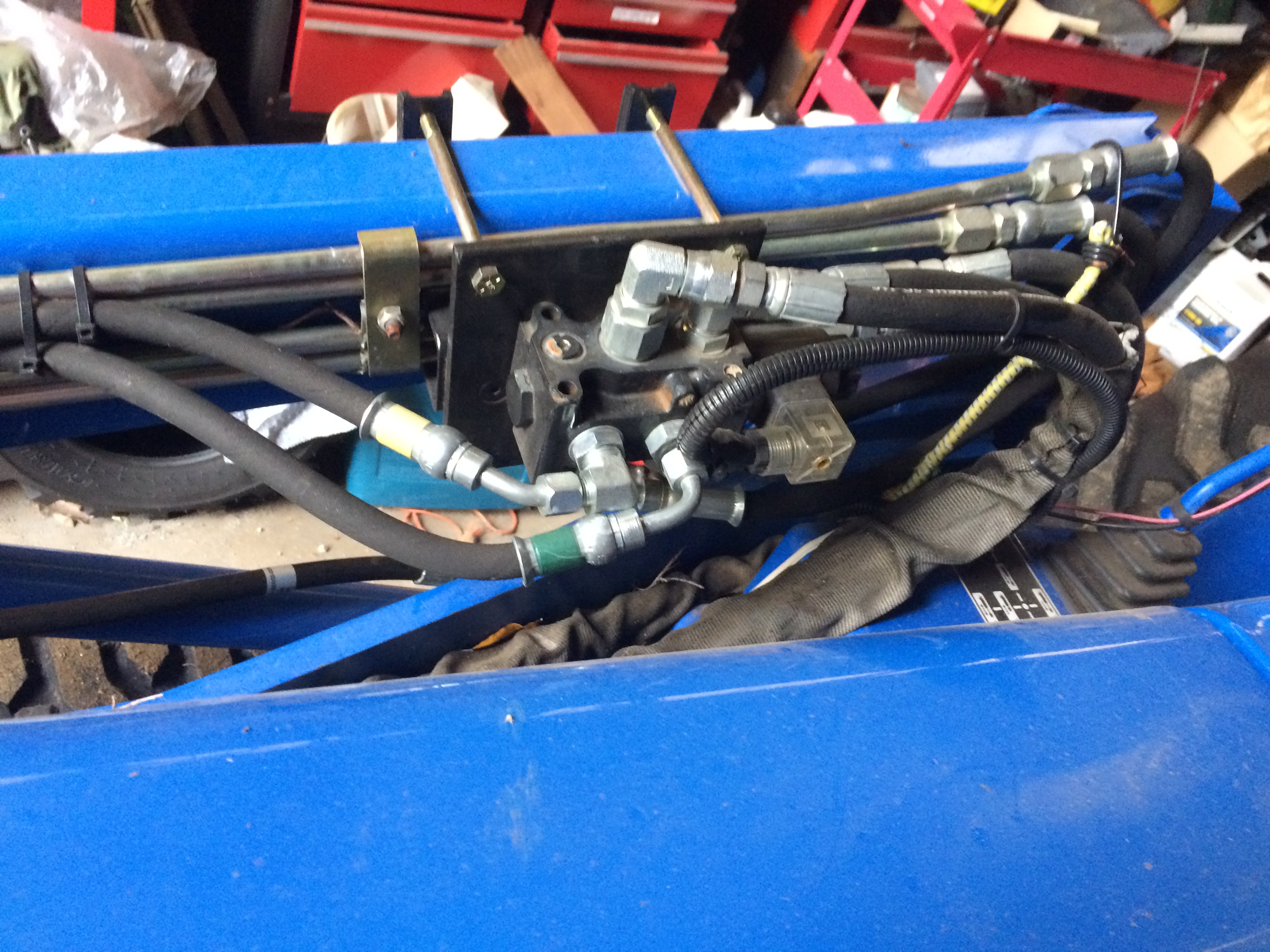

I asked MIE to let me add the switch for a diverter install. Rather than swap out my OEM loader stick for one with more buttons, I threw this together in about an hour, tho' I've replaced the $3 switch at least once in four years. (some times 'we' get a rain bath, nature at work ;))
Some CUT's have limited space to mount a diverter valve. I didn't want mine on the loader tower & making extra steps when removing FEL. With hard lines 'full width' along the arm, I chose to 'straddle over top' & tooled-up a mount/brackets from ~6" x 6" x 5/15" CRS and 2" square x 6" of 3/16" wall tube, with channel iron brackets and 1/4" x 6" Grade 8 bolts from TSC .
I dropped off my home-brew mount setup and MIE did the rest. Just so you know they'll listen to and work with a 'client' (we fortunate few, lol) I came home with this, and dismounting the FEL is every bit as simple as the day I brought the NH home. Just want to show that MIE will deliver to your satisfaction, and listen to your input to be sure of it. No fuss, just 100% service .. once you find a switch you can live with. :laughing:
