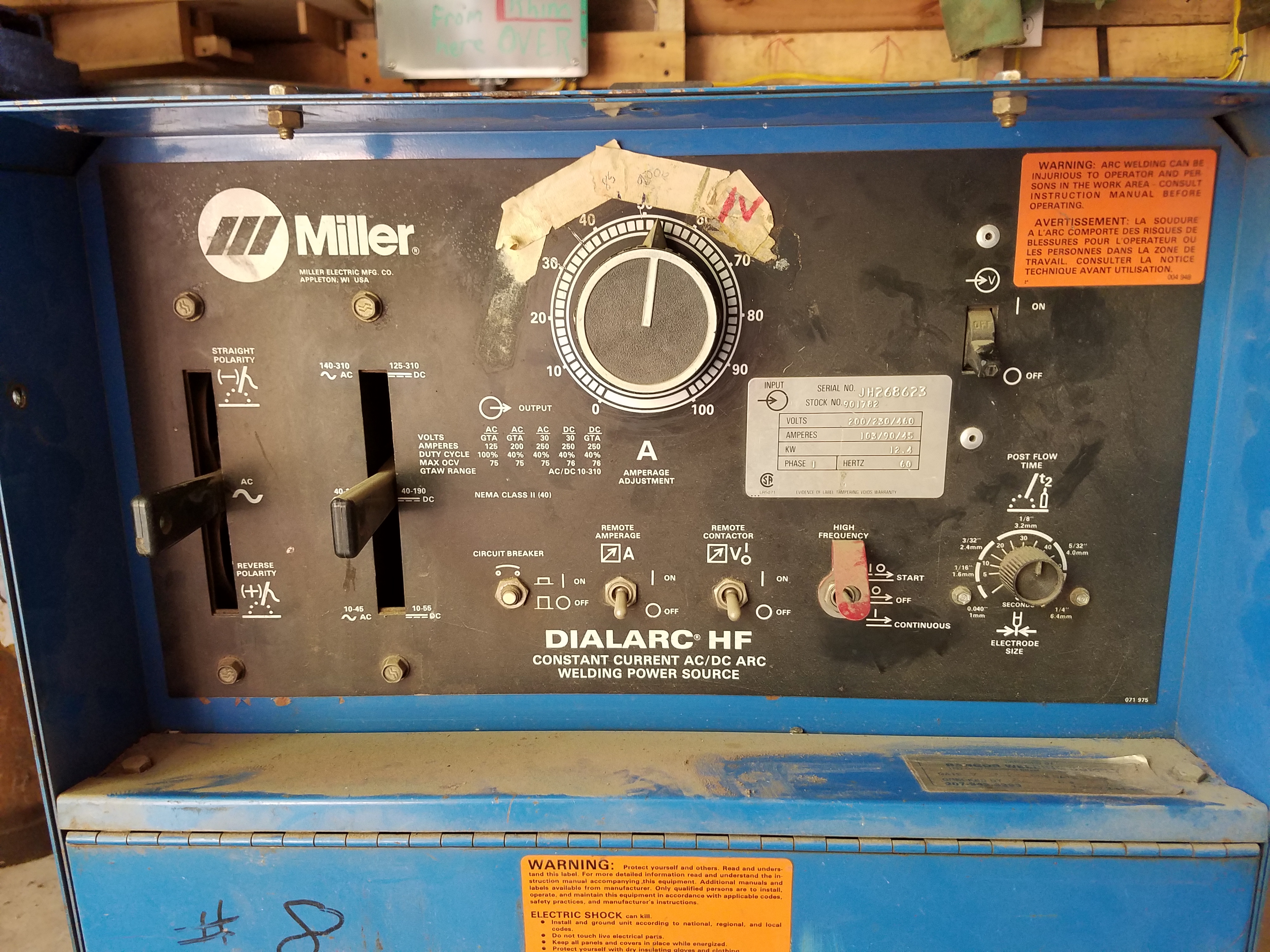

Someone years ago stuck some masking tape above the dial, got some of it of tonight. So finally got a chance to try this Miller out with 3/16, 6011 on AC, not really understanding the the numbers on this, first started with right lever in middle, dial on 0, not enough heat so moved dial all the way up to 100, still not quite enough, then moved right lever all way up put dial on 50, that was enough heat, moved to 60 and that was plenty.
So if the right lever is all way up, 140/310 and the dial is on 60, is that 200 welding amps? and where is my target 250 amp that I'm looking for? The 310 amp I think has to be hooked up to 480 entrance, the most I'm looking for is 250 amps
Stuck the rod once after several rods when the dial was on 50 and right lever all way up and it tripped the 50 amp breaker, so later on I'll get a bigger 100 amp breaker and outlet, the garage has a 200 amp entrance so should be all set there. The way it is now probably be all set if I use 5/32 or smaller rods, it was kinda nice after four years to run some stick rods again.

That setting 140/310 has a 170 amp range. This means at zero it's 140 amps, at 100 it's 310 amps.
Going from zero to "10" will add 17 amps in this case. Counting up will get you your answers.
Or, the math behind it is to use the dial as percentage of the range.
140 + 170(.65) = 250.5 amps.
So turn your dial to about 65 and you have your 250 amps.
Your machine will give you full amperage even on your 200 vac input.
For all of the above to be accurate, you have to make sure your input "jumpers" on the bar where you hook up your main power are in the right location.
Did you make sure that they are correct? There is generally a little diagram under the lid to show where the "'jumpers" go.

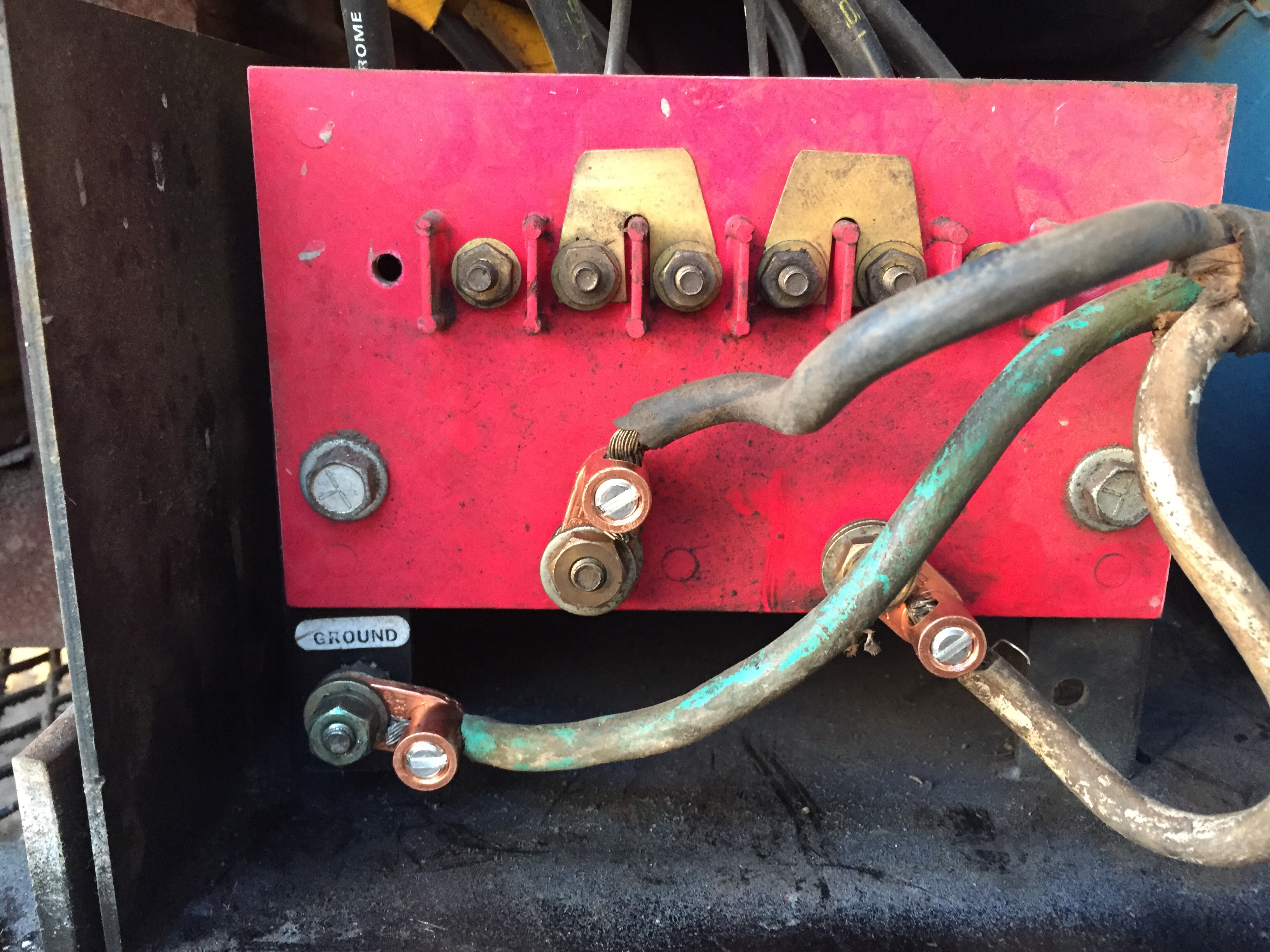

Are you talking about the wiring inside the welder, all's I know is someone ran the main input power cable to a added on switch box on the outside of the welder, and from that switch box is the 220 volt power cord, ten ft long and that is plugged in a 50 amp 220 volt outlet. I was told to be able to run this on full 440 power, wires have to re-arranged inside, so I'm assuming if it's wired for 440, it wont run on 220. But what/where is the LID you think the wiring diagram is on so I can check, where the main power cord comes out?

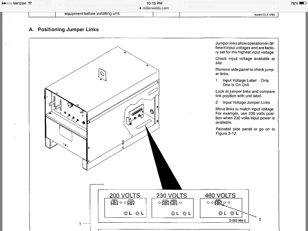

Just take off this side panel and check the little jumpers.
It will look like this picture and have a label inside under the cover.
Just unbolt them to move them to match the incoming service voltage you have at your place.
If you have 200 vac input at your place, it would be the one on the left for example - full machine output amperage will be available as long as your panel has the right breaker and cable feeding the machine.
Miller has your actual owners manual available online for free at millerwelds.com
My Miller jumpers check out like that diagram, set for 200 volts. But why does it have a 200 volt setting when my house and garage has 220 incoming volts? Is 200 and 230 volts for another country maybe?
