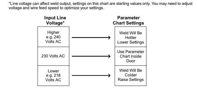

My Miller jumpers check out like that diagram, set for 200 volts. But why does it have a 200 volt setting when my house and garage has 220 incoming volts? Is 200 and 230 volts for another country maybe?
I'll try to find that online manual for JH... siries later on, be a good rainy day search. You've been great help thanks :thumbsup:
No problem, just put the jumpers on for 230 volts instead.
The service at my place is 247 volts, but further down the line at other houses it would be less.
I put my jumpers at 230 volts and just know that the settings list on my door for my millermatic 210 will actually be a little hotter than listed.
Miller even makes a note of that on my door chart.

Last night after reading your post I was wondering why set the jumpers at the 230 when I have 220 volt entrance service, so when I got home tonight I took my multimeter and started checking some outlets, they all seem be to around 120-121 volts and for some reason I always thought they was 110 volts, so if I add 110to 110 that equals 220 volts, but now if I add 120 to 120, that makes 240. So now it makes sense to set the jumpers at 230 volts, after I did that I tried out the welder again on the 250 amps AC setting and it seems like the AC buzzing has a smoother buzz. Now the only puzzle I have is what why where did I get the 110 and 220 volt formula from.

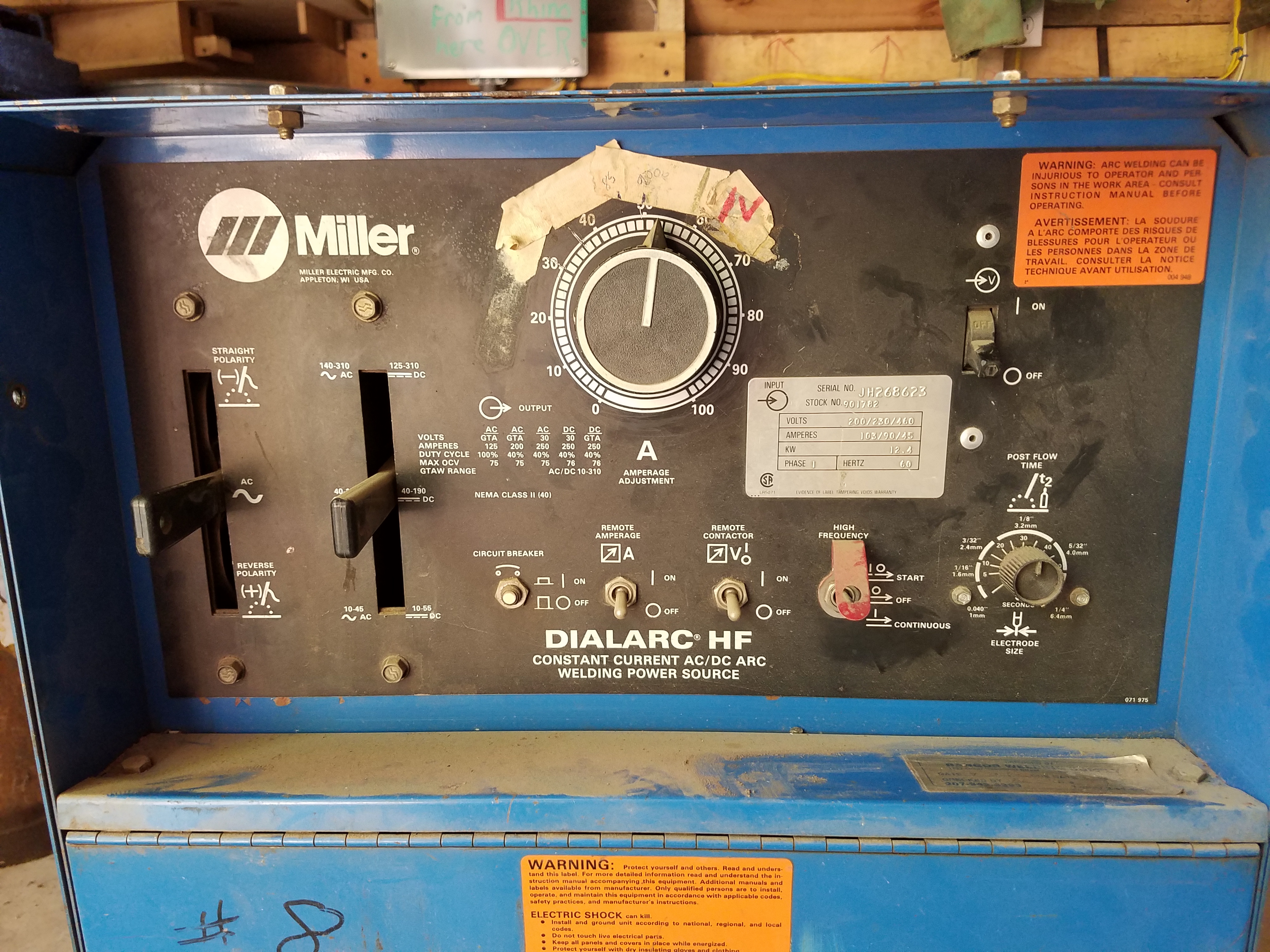

This is the first test run of the Miller Dialarc, truck springs makes pretty good scrap steel to test on. The last couple passes was in the 140/310 AC setting, dial at 60 with 3/16 6011. I took the springs out of the vise and the following night, some separation started, probably if done with 70 rod it would of stayed together.
From what I've been told, the U.S. started increasing the voltage around the 1950's and that 110/220 is just the old way of saying it that has lingered.
Here is a brief summary: North American Voltage
Other references will go into greater detail.
