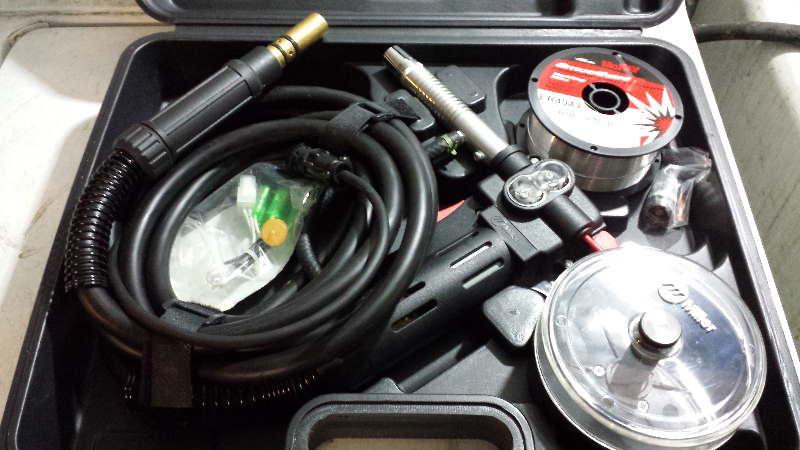

Mike, looks like it's set up for a spoolmate 100 -
Miller Multimatic 200 Auto-Set Elite Welder 907518
If you want all your eggs in one basket, that looks like a good setup - at 29 pounds (40 with a full spool of wire) it's gonna be a lot more portable than the 211 I just sold, so if it's limited to a 10 foot gun like the 211, you would at least have the option of moving the welder much easier than the approx. 90 pounds (with full spool) 211.
I liked the 211 with same spool gun OK, but some of my projects are a bit big for a 10 foot gun (longest miller recommends), unless I wanted to hang the welder from a jib crane overhead -
So when I found a deal on a 252 with double running gear, 15 foot gun, 30A spool gun (never used) and 2 full tanks and 30 pounds of wire left on the ONLY spool of wire the machine had ever seen, I bought it ($2500) and sold the 211 with spoolmate 100 to a friend whose needs are better matched to a smaller machine.
That was about 2 months ago, I've so far finished off that 30 pounds of wire and a 200 CF tank of C25 gas, and couldn't be happier with the 252.
If I were starting from scratch and didn't mind total downtime if ANYTHING went wrong with a multipurpose machine, that 200 looks like a good choice... Steve
/ Millermatic 211, 212 or 252 #67
Sorry bud I think I cofused you. I actually have a spoolmate 100 that my lws basically gave to me. Very generous of them and I appreciated it 100%, but I won't even waste my time or gas trying to mess with it. I am yet too see any positive results come out of one of those guns yet. Forget about perfect lol, I'm talking I haven't even seen anything that would make you say meh, maybe with some more tweaking i could find its sweet spots. Anything I ever saw was gut busting laugh out loud pooh pooh. Mine is collecting dust and has never been tried. I was hoping you had some pics of welds that would inspire me to give mine a shot. Otherwise back under the cart till she becomes a collectors item, lol.

Im specifically talking about the spoolmate 100 bud. We run 30a guns at work, so im not a stranger to any of that make sure its clean stuff lol. I think I gotta give mine a shot and see what I can come up with, but I have never seen or heard anything positive about the 100. I was anxious to see some nice looking welds from one.

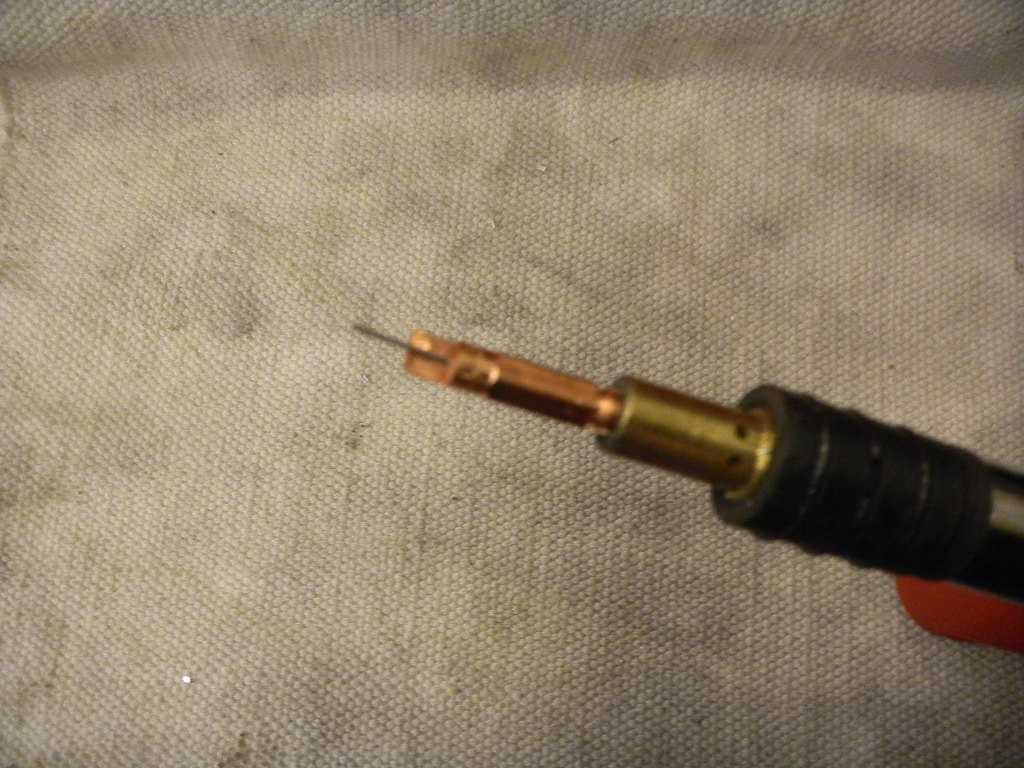

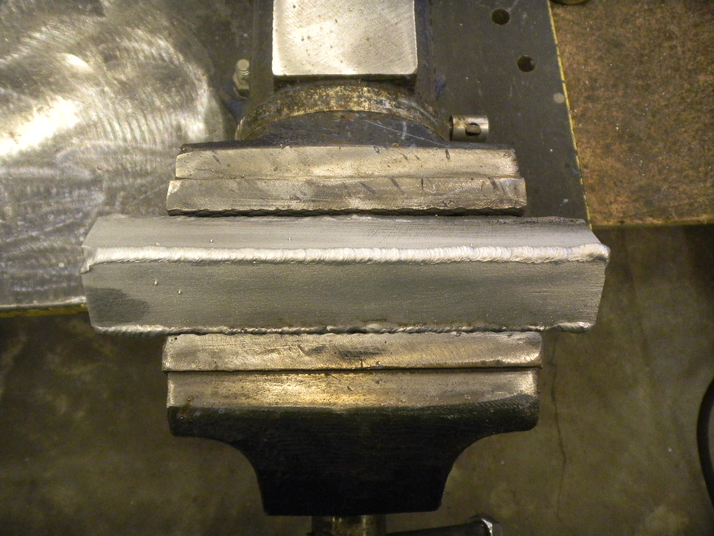

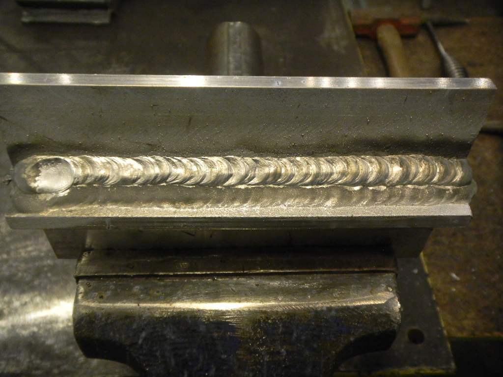

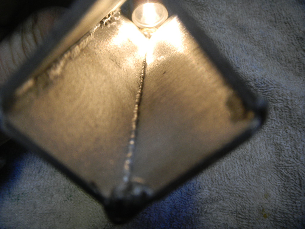

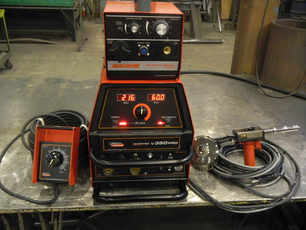

I can count the amount of different spool guns I've used on one hand, and still have fingers left over:laughing:. When I bought my V350-Pro I also ordered the Lincoln SG Spool gun. Only played with it just a little. I had a Cobramatic for years, ran it off my Linde VI-206 Mig machine. I sold it along with the Linde when I bought the V350-Pro.
Here is what the SG has done, the weak link in the system in the loose nut pulling the trigger!:eek:
