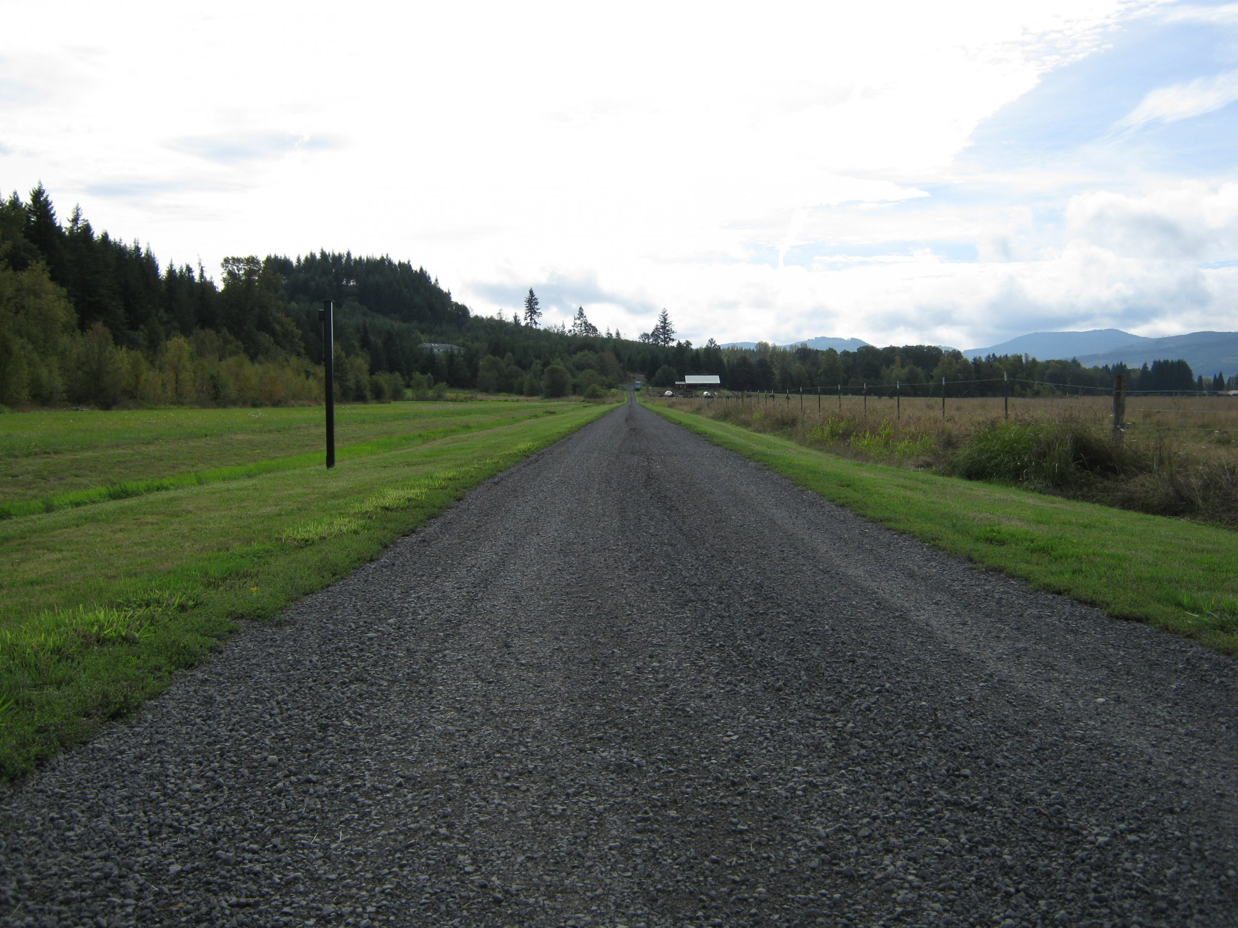

Before you do anything to maintain your driveway ($), address drainage. If you have a driveway with water up to the level of the road surface at times, you will never be happy.
It has been probably 20 years or more since I have used any sort of "digging" device on my driveway. Mostly because I know a few inches down is LARGE crushed rock for the base. Do not stir that base rock up or you will regret it.
I have only used a landscape rake on my driveway for years. Easy to pull gravel back across the road and maintain the "crown" which aids in drainage.
