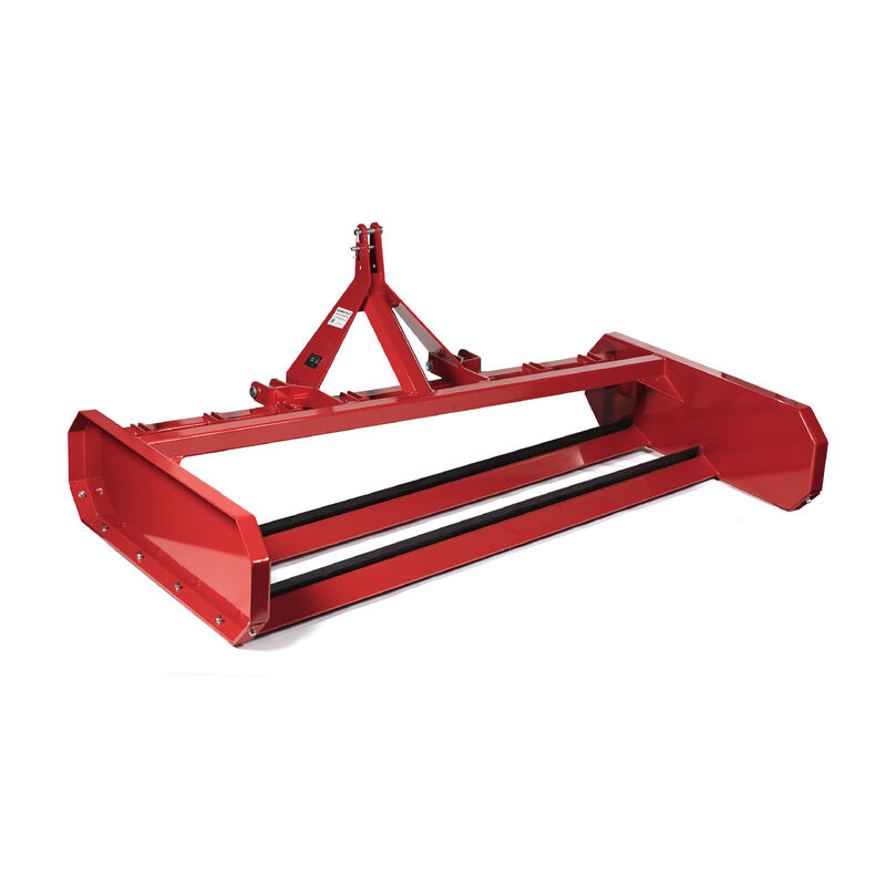

I just want to say when you are looking at gravel driveway maintenance you might want to consider a land leveler (aka grading scraper) in addition to a box blade. It is way easier to use and gets outstanding results.
The relatively short blades on the scraper collect material quickly and then the small stuff floats and pours over the top of the rear blade in a nice even layer. When you hit a dip or pothole the larger stones which stay at the bottom of the blades drop into the holes. My driveway has never been this smooth.
Of course, I am not sure I have seen one of these smaller than 6ft so it will take a heavier tractor.
All true......if you want a FLAT driveway!

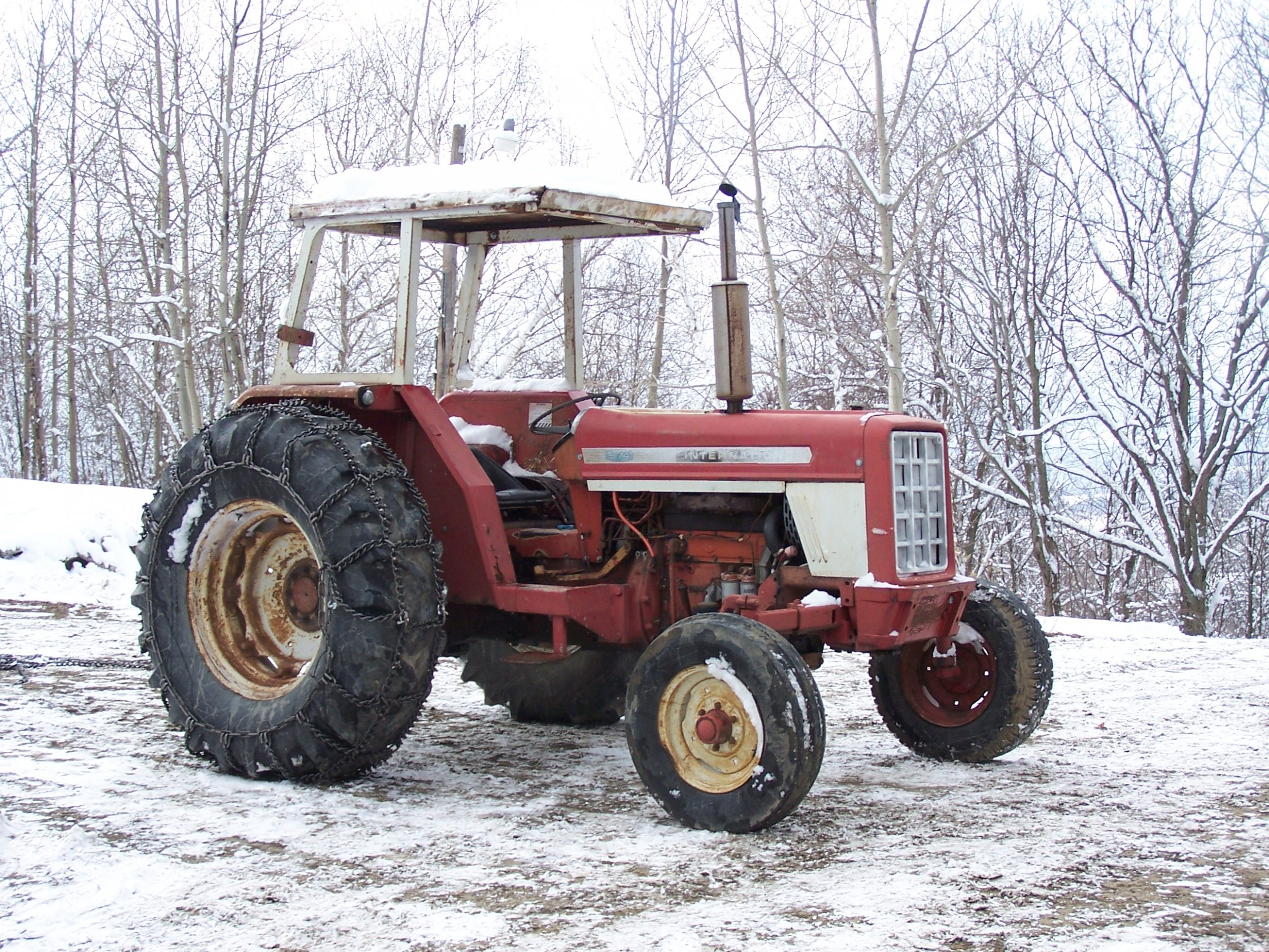

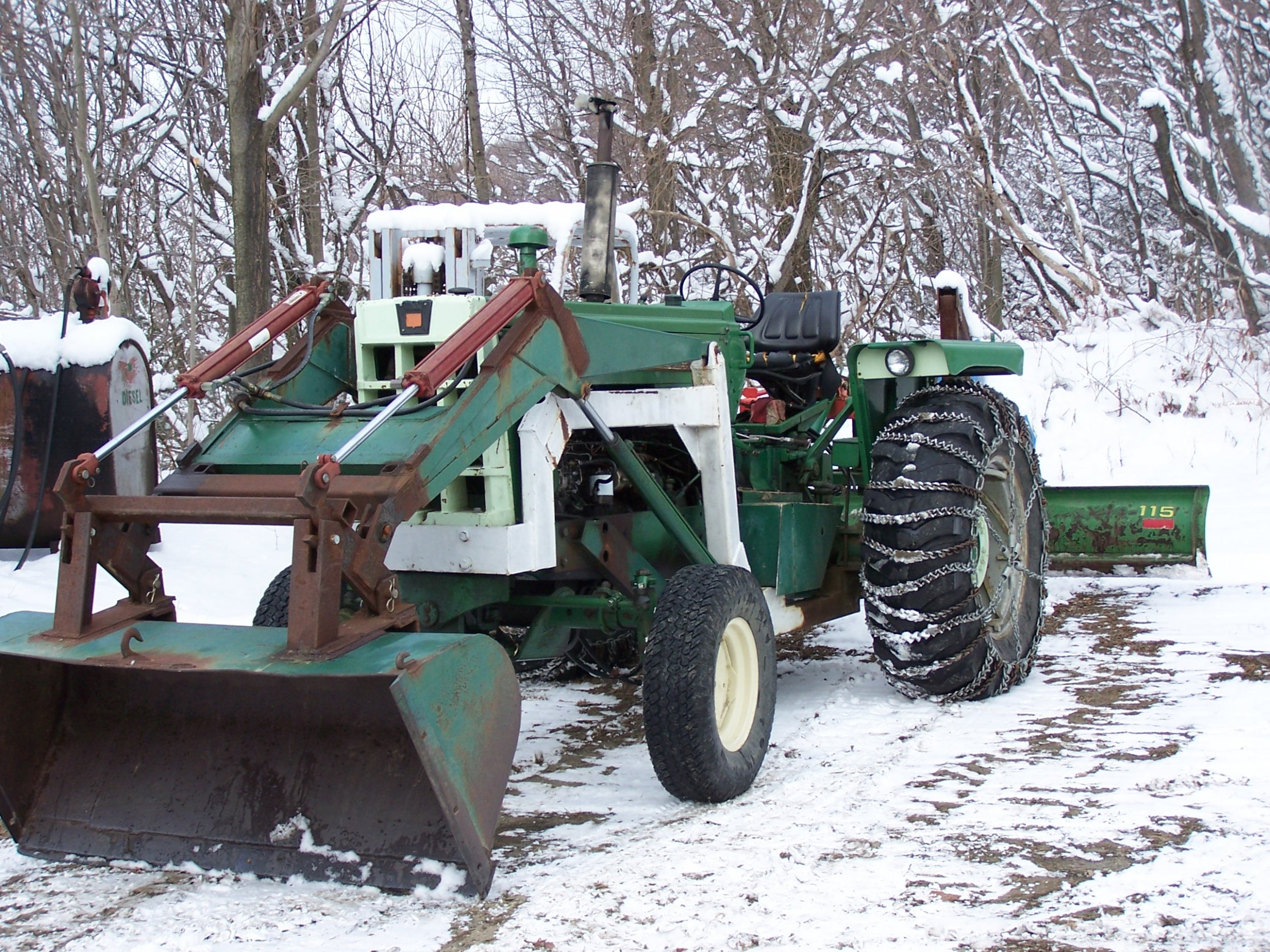

Many people on here will disagree with this but many times an 80-125 hp 2wd farm tractor with chains will do everything you need to in your driveway.
My driveway is twice as steep and it was done with 55-60 hp two wheel drive tractors for many years.
An Oliver 1550 and a IH 574.
A 2wd with good chains and weight can do the job.
   / Min tractor size for repairing long gravel driveway with potholes? #39
The only reason anyone would disagree with this Lou is they have not used a heavy 2 wheel drive tractor. Most of our farming was done with 2 wheel drive and we pulled some serious stuff with them like you I am sure.
The small tractors I have today are 4WD but I hardly ever use it. Obviously I would have to for snow, but they still are very productive in 2 wheel drive.
