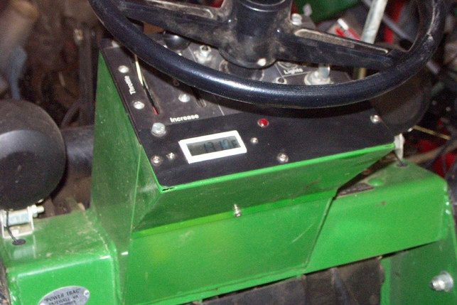

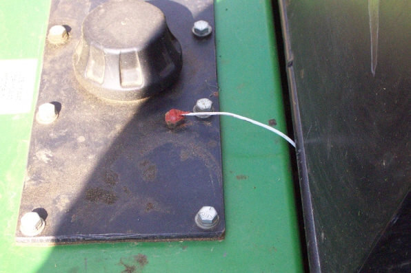

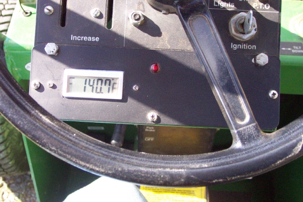

Hydraulic Tank Temperature Gauge
That's pretty slick. Can you give us some more info on the guage and the sensor?
Would that work on the engine as well? It looks like you have room for two guages.
Taylor battery operated panel mount with remote sensor. The sensor is inserted in a well near the middle of the tank
Ordered a Tiny Tach commercial model for the other side. The Tiny tach would not work at all with the Kohler engine. I was looking for a multi function gauge that you could switch between sensors ( CHT, EGT and Tank Temp.) Had to settle for the Taylor thermometer. The Tiny tach people told me they were working on a cylinder head temperature gauge I do not know the status of that.
sg
   / Mini Modification #40
Clarke,
What is the highest hydraulic temperature you have seen. What was the outdoor ambient temperature at the time.
Duane
