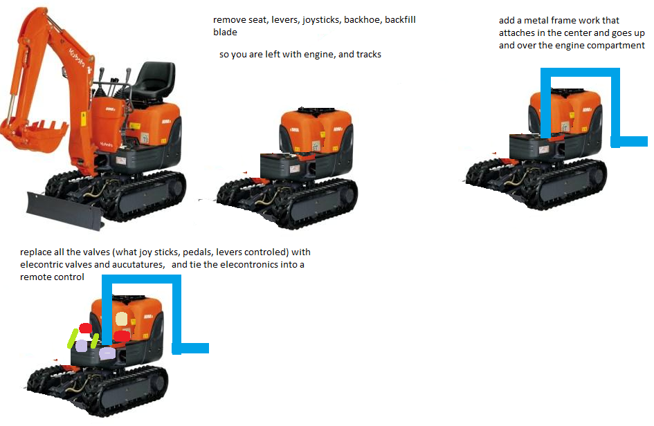

some quickly copy / paste, and edit pictures, to get idea across.

figured since no one will be seating in the machine, you could chop off all the roll bars, dash boards, levers, joy sticks, pedals, panels, insulation, lights, etc... to just have the motor and tracks. and then setup all the things that use to be control by joysticks, levers, and pedals, with remote control stuff.
after looking at video, i quickly caught on, of having "tracks" and more so the bar that swings around entire machine, would come in extremely handy, to rotate the power unit/machine, so you could correct things. ((trying to judge distances from afar and counting down them inches trying to get up near things....)) hence the light blue thing in the edited pictures
only issue, would be is visibility, and trying to see what is going on from afar and trying to see around a larger unit. *frowns*
and i am guessing you are wanting to deal with a smaller size engine. and as low as profile as possible? to help with visibility?
besides above, personally was thinking if you hacked at a mini ex, and had engine problems or track problems you could get parts for it. vs custom building everything. beyond remote control, that dealt with valves and like.
mini ex would most like have an alternator and battery already on unit, to power motors, electronic actuators, and small motors for remote control.
the do sell buckets vs backfill blades for mini ex. or most likely be able to even modify a small bucket for in place of backfill blade.
