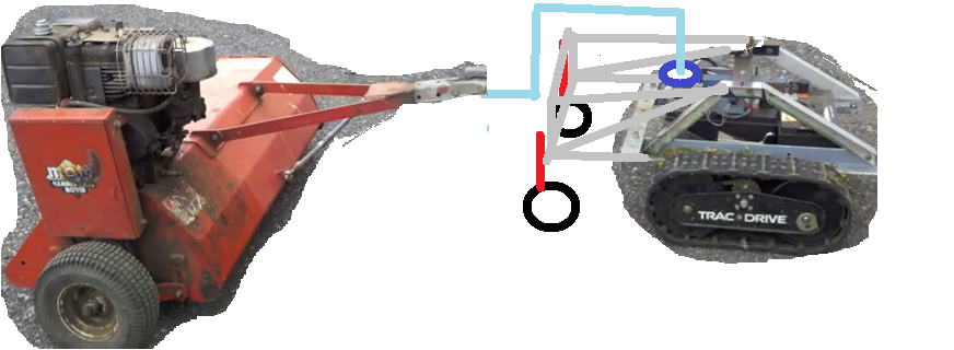

on current machine, add 2 gauge wheels, you might find on regular finishing mower decks. to adjust height at what the deck cuts at, but use them as "wheelly bar" wheels. to help keep machine down. you might be able to pickup some "caster wheels" from local hardware store for cheap, but would most likely not last to long. without seizing up and bearings going out. hence gauge wheels from a finishing mower deck, that has stronger heavier duty bearings, in idea it would turn your little machine into kinda like a zero turn mower. but without the finishing mower mounted directly to the machine.
ay as goose neck hitch. should help lower things. and still allow the 360 degree spin on the machine.

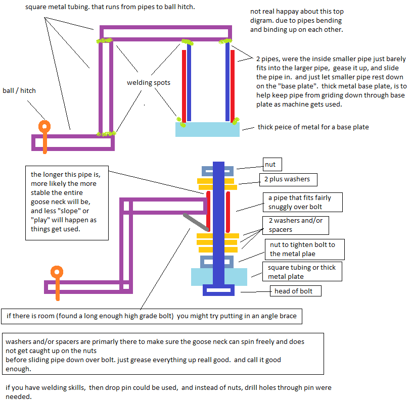

goose neck for machine idea.... see attach diagram. more specifically bottom diagram.
high grade bolt or pin, as in, drop pin or bolts used to connect a grain waggin or hay rack to back of a tractor. higher grade bolt or pin, should have enough strength to keep from bending and then binding up the goose neck form spinning. larger diameter pin or bolt may be wanted as well. to help reduce chance of it bending. granted that means more cash, but *shrugs*

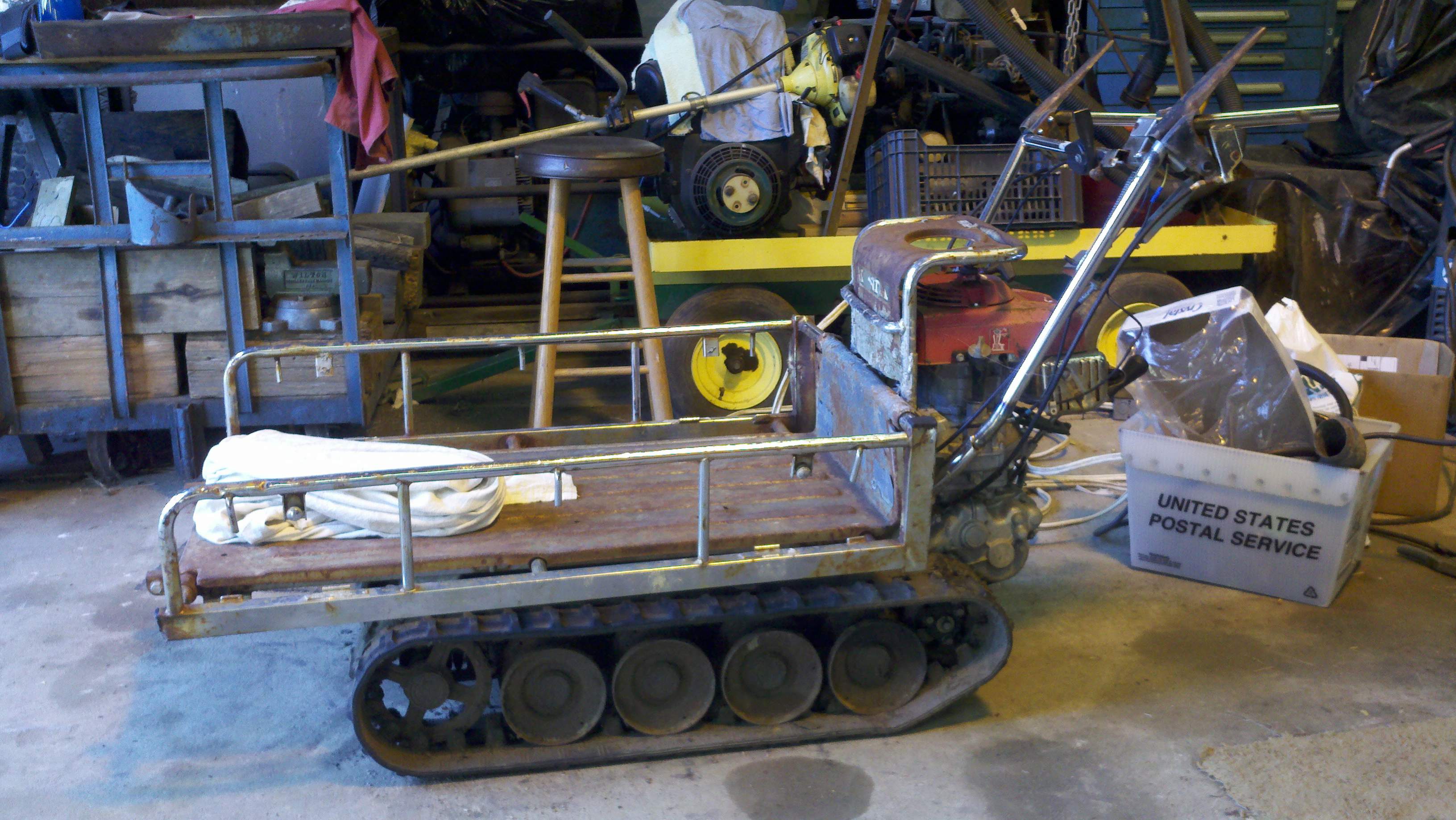

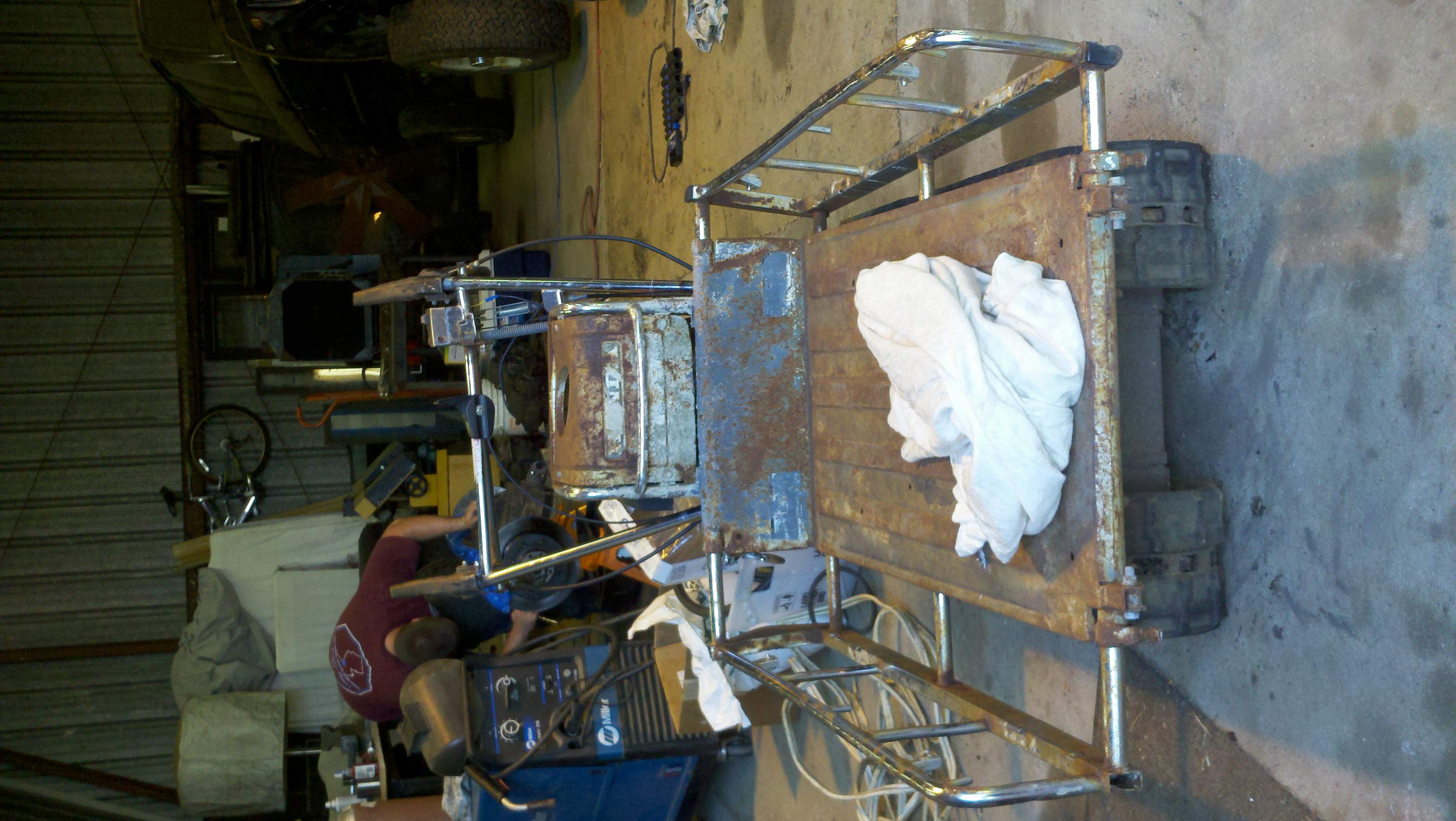

Thank you all for your help! Guess what guys! I was able to get a mini tracked wheelbarrow for cheap. It's the Honda powered carrier hp400. It doesn't run which is fine to me is a don't plan on using the vertical motor on it anyway. I want to make a low-profile machine like my other one and use ideas that boggen mentioned. I do want to make it hydrostatic so i am going to pick your brains on figuring out electronic control valves to control the motors. I have several motors and pumps from different mowers I have. I just have to figure out ratios in order to make it travel at a maximum of about 6 to 7 mph. I would like to travel that fast for when I'm transporting it to a different area down my road a little bit. So, is there an easy way we can figure out how I can use a radio controller with a hydraulic system Or can someone direct me as to what to use and websites where I can look them up? it would have to be a proportional control valve for my veritable speeds. But I'm not exactly sure how it would work with the two motors controlling separate tracks yet keeping the flow constant and equal to both tracks.
So some things I would like it to do and have:
1. 6-7 mph
2. Category 1 three-point hitch Up front (for flail mower and other implements)
3. maybe a hitch for rear as well
4. I would like to be low-profile but a higher clearance than my track robot
I know this is going to be a lot of work but my dad said he's willing to do it. I know it's not going to be done overnight but I will try to post pictures of the progress.

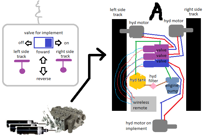

was more along the lines of thinking of ""open center"" 3 staked spool valve. you can find them on many tractors either for rear hyd remotes, to FEL, to backhoes to other ranging in multi configurates of how many valves are bolted together.
https://www.surpluscenter.com/item.asp?item=9SV-3-X&catname=hydraulic

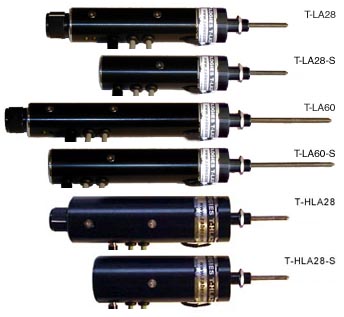

going a tad further taking the 3 levers off, and then install 3 actuators. the DC actuators, would allow you to tie into wireless remote. and just tap the levers to adjust how fast a left or right track moves or how fast the motor on implement turns.
Actuator archive -- Tools and Equipment Review
in below diagram, the open center 3 stacked spool valve with actuators. would allow everything to be adjusted to a given amount of hyd fluid. example. many times, i operate backhoe, and lower the boom, curl in the dipstick, and curl the bucket all at the same time. but for you, instead of operating 3 cylinders it would be 3 hyd motors.

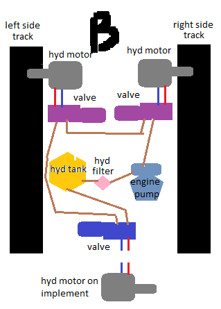

taking a different route (below diagram). if you had 3 separate valves, that were open center. you could run all 3 in a series. and achieve same thing as above diagram
the 3 open center 3 stacked spool valves with 3 actuators may not be ideal compared to ""proportional control valve"" but *shrugs* mix and match what you already have.

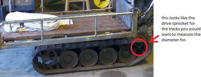

i realize i say wheel above. but there will be a main drive wheel / sprocket within each track the hyd motor will be attached to. measure the diameter of this wheel / sprocket for above calculations. all other rollers and wheels and sprockets within the track are null and void.
the front spooked wheel, looks like a tension wheel (looks like a long bolt up under the chassis, that loosens or tightens the track. and the area marked, looks more like drive sprocket, (more bolts in it. and right near the engine) i may be wrong.
