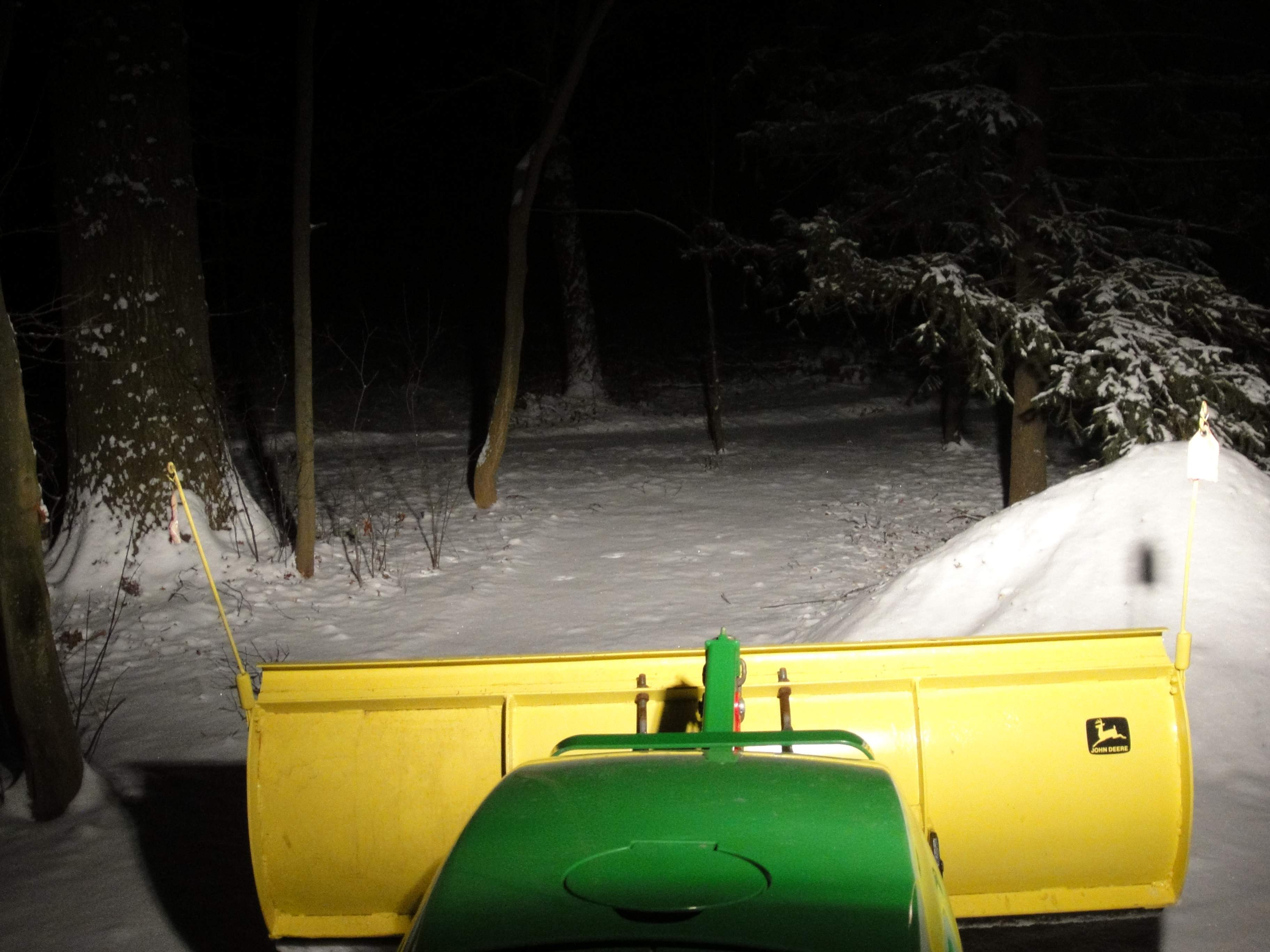

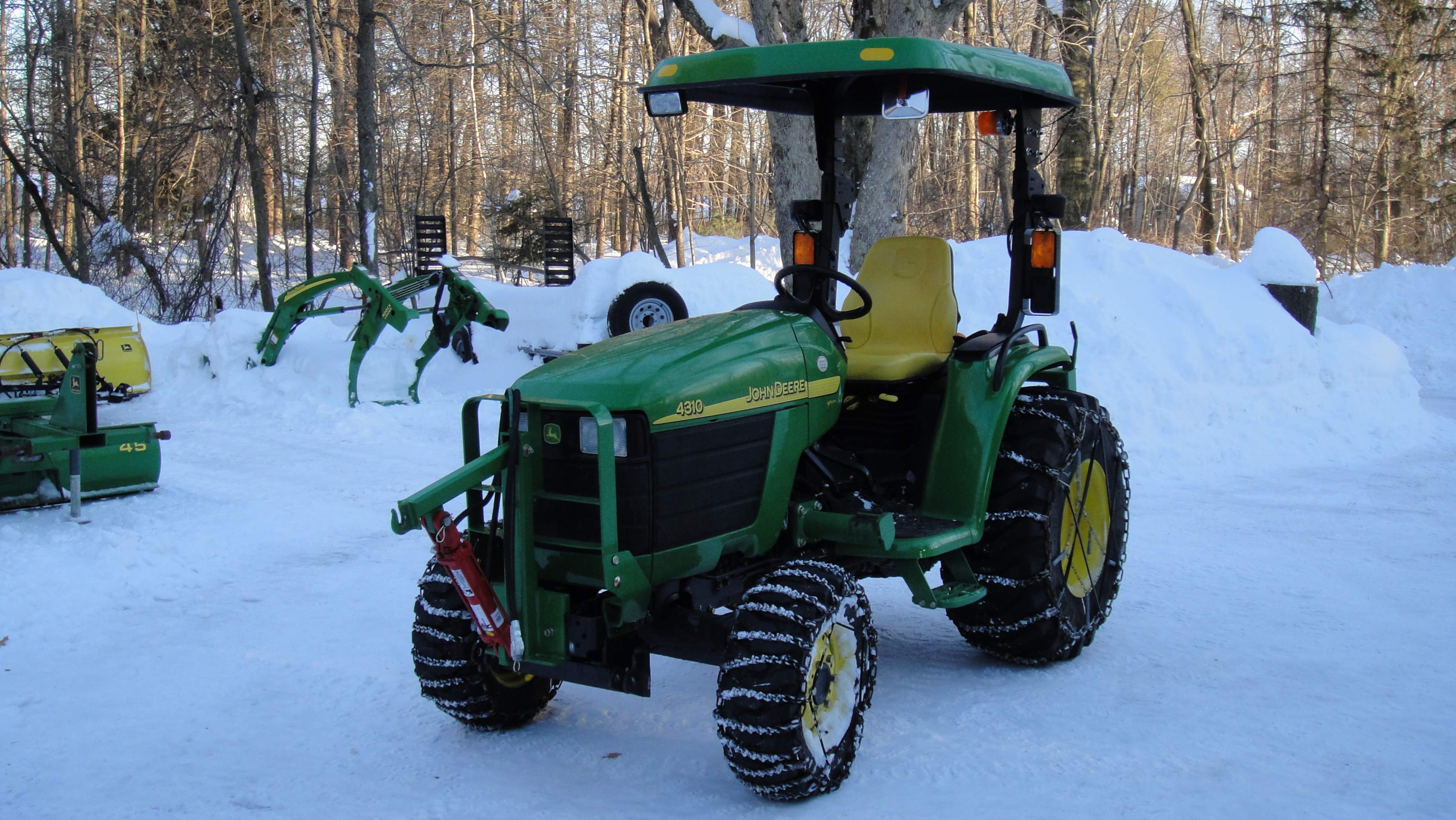

I've got a mirror and one real nice front facing light, I put on my canopy.
JB
