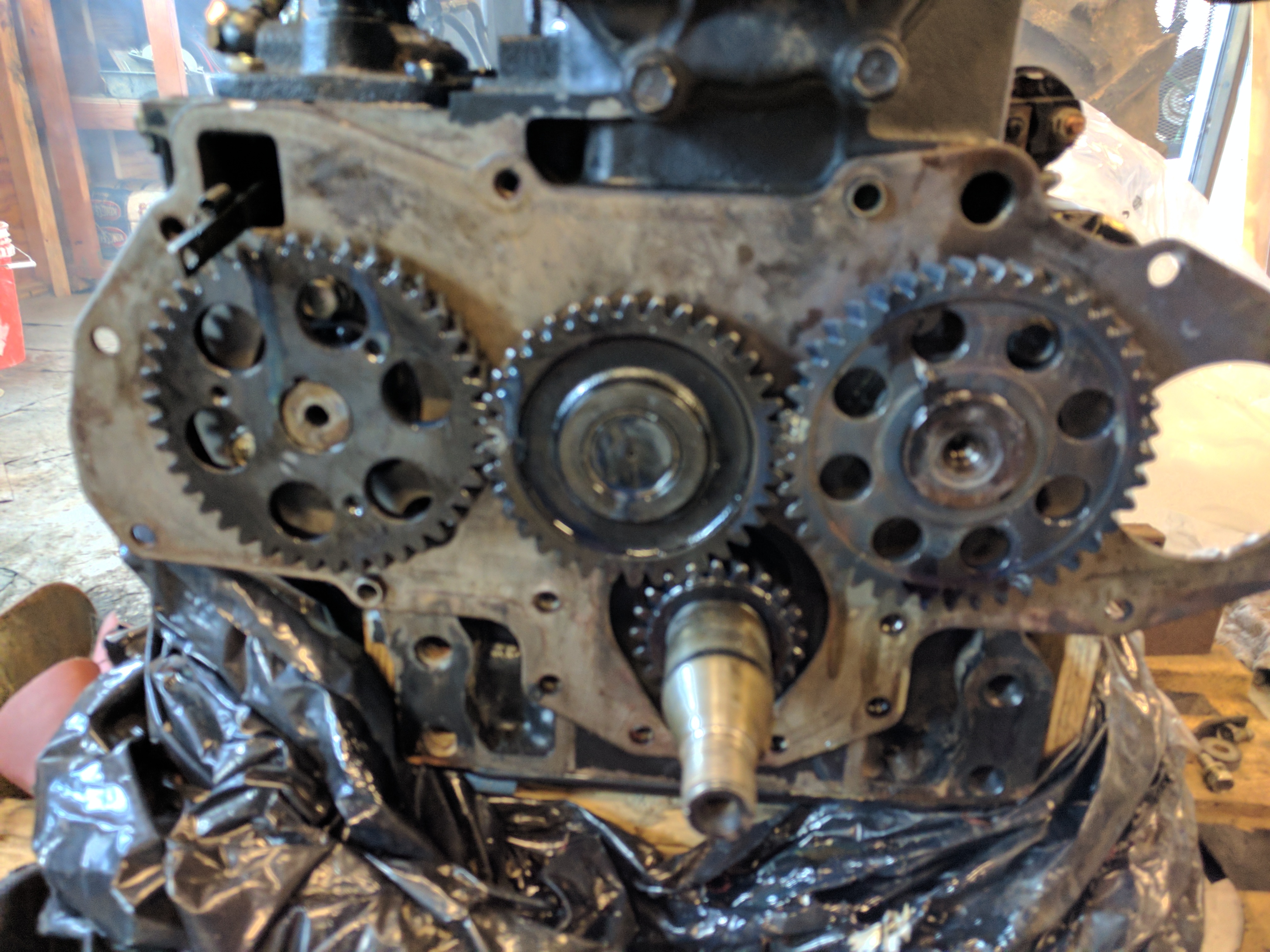

I went for purchasing a used block, from Diesel repower (Dennis), and after talking to him on the phone, I did pull the trigger on one bloc he had in stock.
Got the bloc a few days later (super fast actually). This other engine was obviously coming from something totally different than a tractor! it had no hydraulic pump mounting hole, and the flywheel was not made to receive a clutch. So My guess is this engine was used on a backup generator probably. (sweet ! those usually have a good life !)
I had to put every single timing gear out (pain in the @#$#%) to replace the back cover, that receives the hydraulic pump. Reinstall timing gearsthen, I replaced the flywheel from my old motor, and put the new clutch on it. adjusted the valve lifting, and I could cloase this engine, and slide it on the tractor rear end.

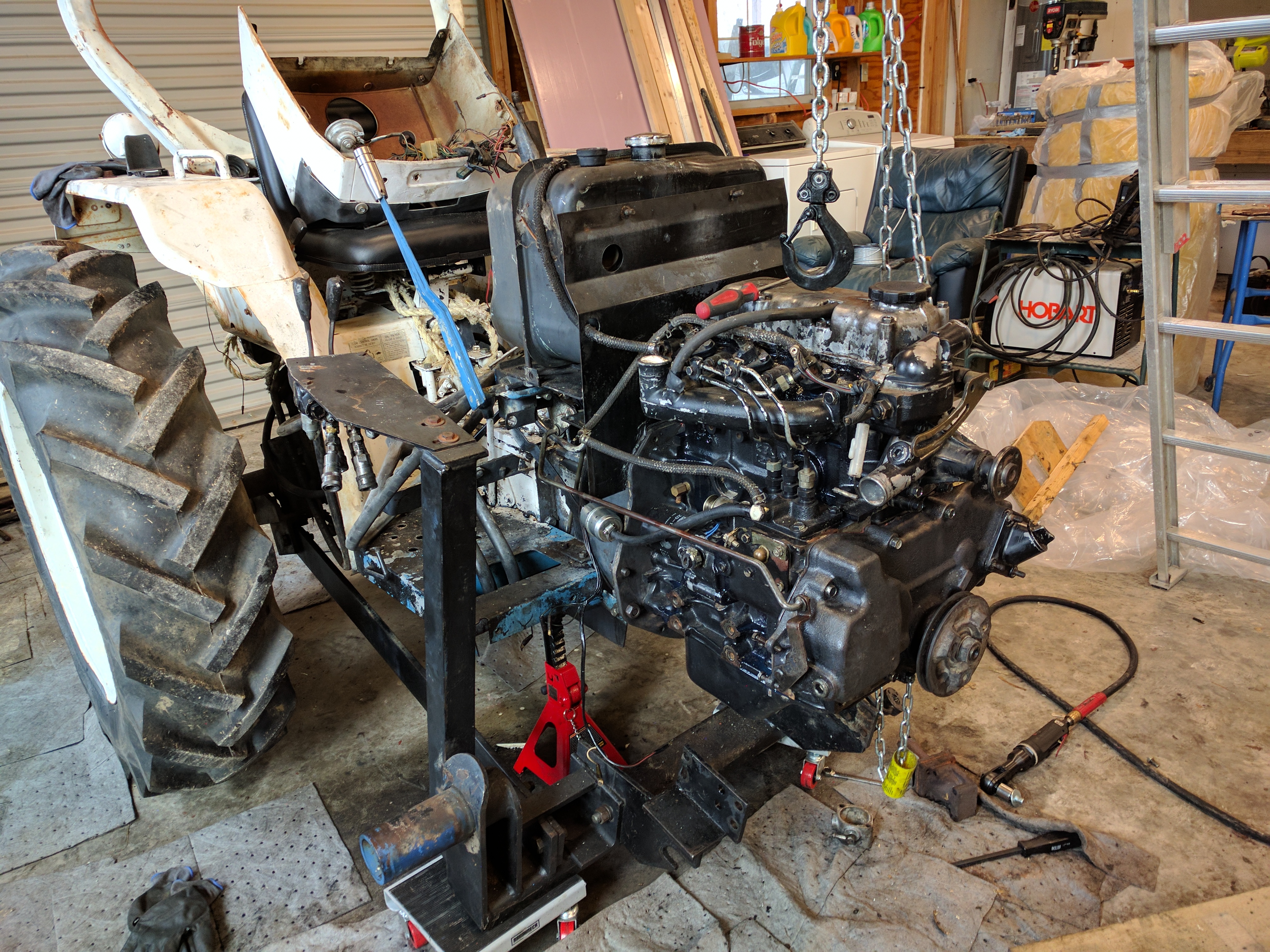

After I installed the engine back on the rear end (it's super easy to line up the drive shaft to the clutch when it is just the engine that you have to play with !) then I reinstalled the frame, and the loader frame, lined up all the bolts and bolted the all thing down ! Now this thing was looking more like a tractor !
