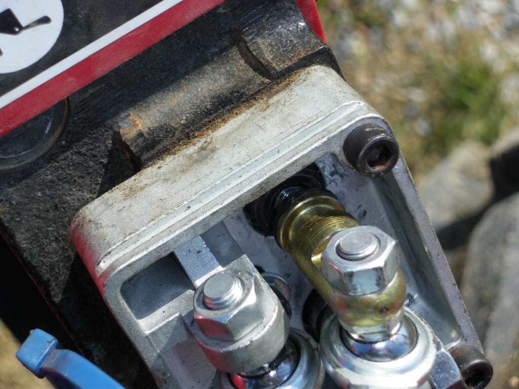

Every few hours my Joystick flops to left side. Dealer fixed it first time at 40 hours and, think heaven, showed me problem. It is now at 100 hours and I have had to fix it 4 more times. I have attached a picture. It is always this upper right hand turnbuckle that backs out and sometimes
it will back totally off. The turnbuckle is locked in place so it's not spinning so it must be the piece it screws into that goes into joystick body. Any ideas on how to fix???

I have the same loader and the same problem. Mine always gets "spongy" just before it completely backs out. I go ahead and take the boot off at that time and tighten it back up. Wonder if any of the threadlocker products would work?

Those joysticks are supposed to be loctited together during installation per the valve manufacturer. If this was to happen, I would guess that no one would have this issue.
/ ML265 Loader Joystick issue #4
Would using LOCTITE 242 or Loctite 2033 thread locker work for you? Did the dealer put any on it the first time he repaired it.

I was afraid to loctite but I will next time it is down.

A solution besides using loctite would be to replace the current nut with one with a locking plastic insert. I have found the nuts with the locking plastic inserts will withstand a lot of vibration and not loosen.

My joystick on my ML275 did the same thing. I locktited it the first time it happened and it has been over 150 hours since with no problems. Jam nuts or locking nuts won't do the trick. Machining flats on the spool (valve?) rod that could be held with a wrench would be a big plus.

The Loctite 242 cost about $12.50
Blue Threadlocker (242) is used for mounting bolts, pumps and compressors. Recommended for fasteners from 1/4" through 3/4". This non-wicking formula cures in 10 minutes with full strength in 24 hours. Medium strength, requires handtools to remove once applied.

Loctite's patent has expired you can buy the same chemical formula in another bottle a bunch cheaper. Not to say threadlocker is threadlocker, I'm sure there are some of not so good quality. Most fastner stores can direct you to one that is of the same quality as Loctite. Last I bought was at Fastenal and I literally got more than 10 times what I would have gotten in the Loctite brand.
On another note I had the same thing happening with the 6000 and the plastic insert nuts have lasted about 800 hours on it.
