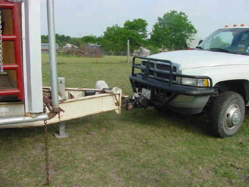

Richard I think you're going to like this series of pictures.
We moved the loafing shed--stalls today. We moved it about fifteen miles. Some of those miles were at fifty five miles per hour.

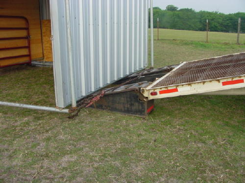

Our winch for loading is only five thousand pound pull so we had to double up the line for the up the ramp portion of the loading. We used the skid steer to unload it.
We did pick up a new ding from a tree limb getting out of the old pasture. But it was pretty well straightened out by bud and a willing two by four.

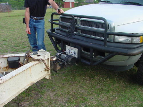

We pulled the Dodge with the winch on the front to the hitch of the trailer and then ran the winch line out.
Yup. That's one of my bumpers. /forums/images/graemlins/smirk.gif

On the ground

#58
coming up

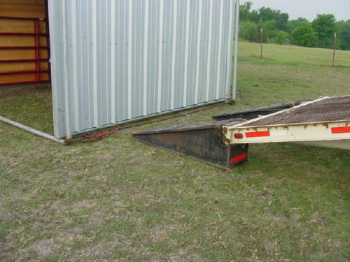

#59
sucked up in place
