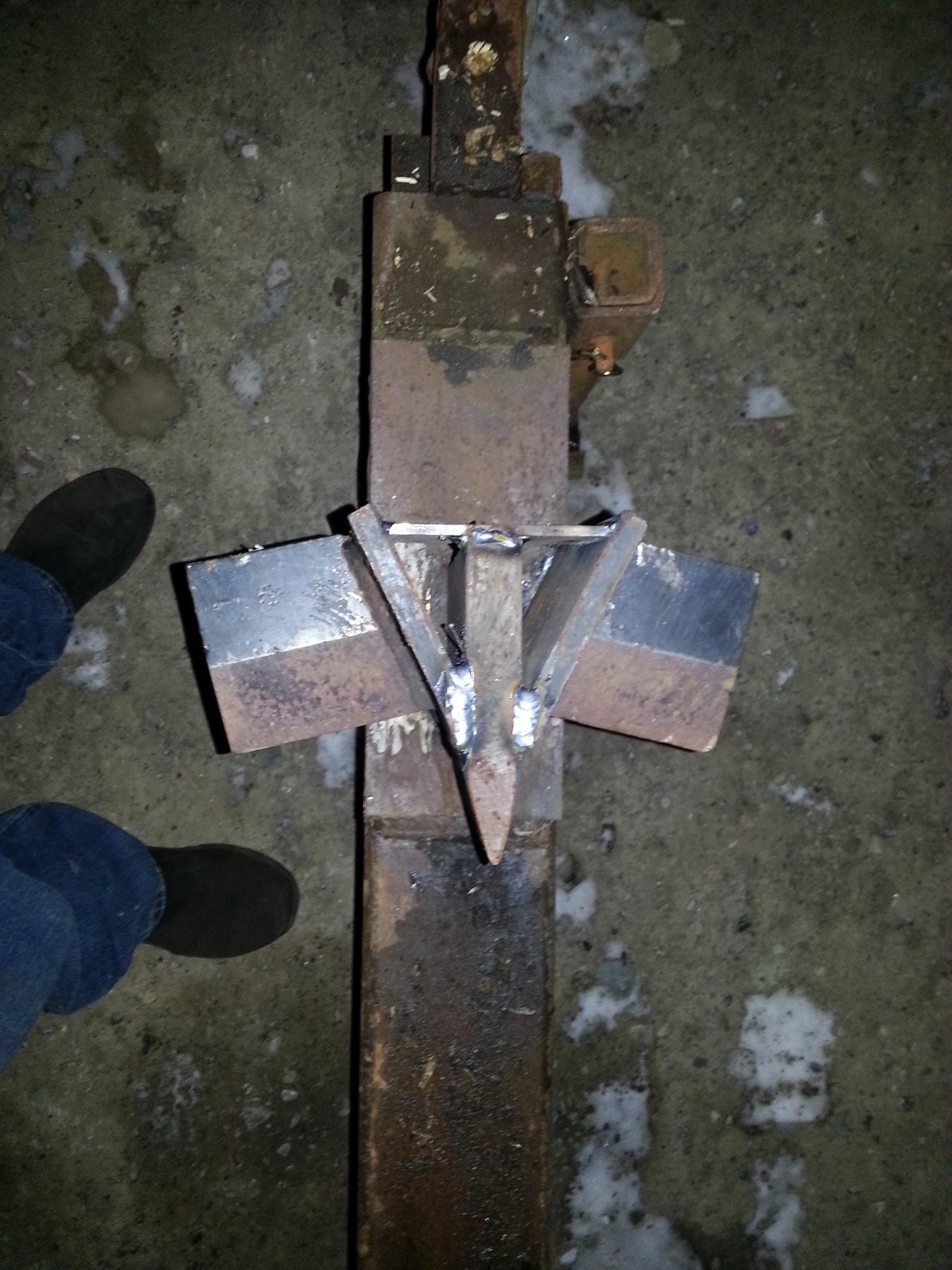

Posted this in Scooby's thread, but I will add it here too...
Here is what I just did to my wedge. It used to be a drop on wedge from Northern Tool. I hated it.
Here is what it looks like now....
It seems to work very good now. You will notice the cross part of the wedge is back a couple inches from the main point of the wedge. This allows the first split to happen before it hits the cross, thus making it not bog down as much.

I watched your Video and I think if you were to add to your plunger on the outside two spacers so as not to touch the wedge itself but could by-pass it it would clear the splits better. I did this with two chenille laid flat for strength. I think a wider table at wedge would hold bigger splits and make it easier
to re-split you made a nice splitter but I think it could be better,not telling you what to do just saying

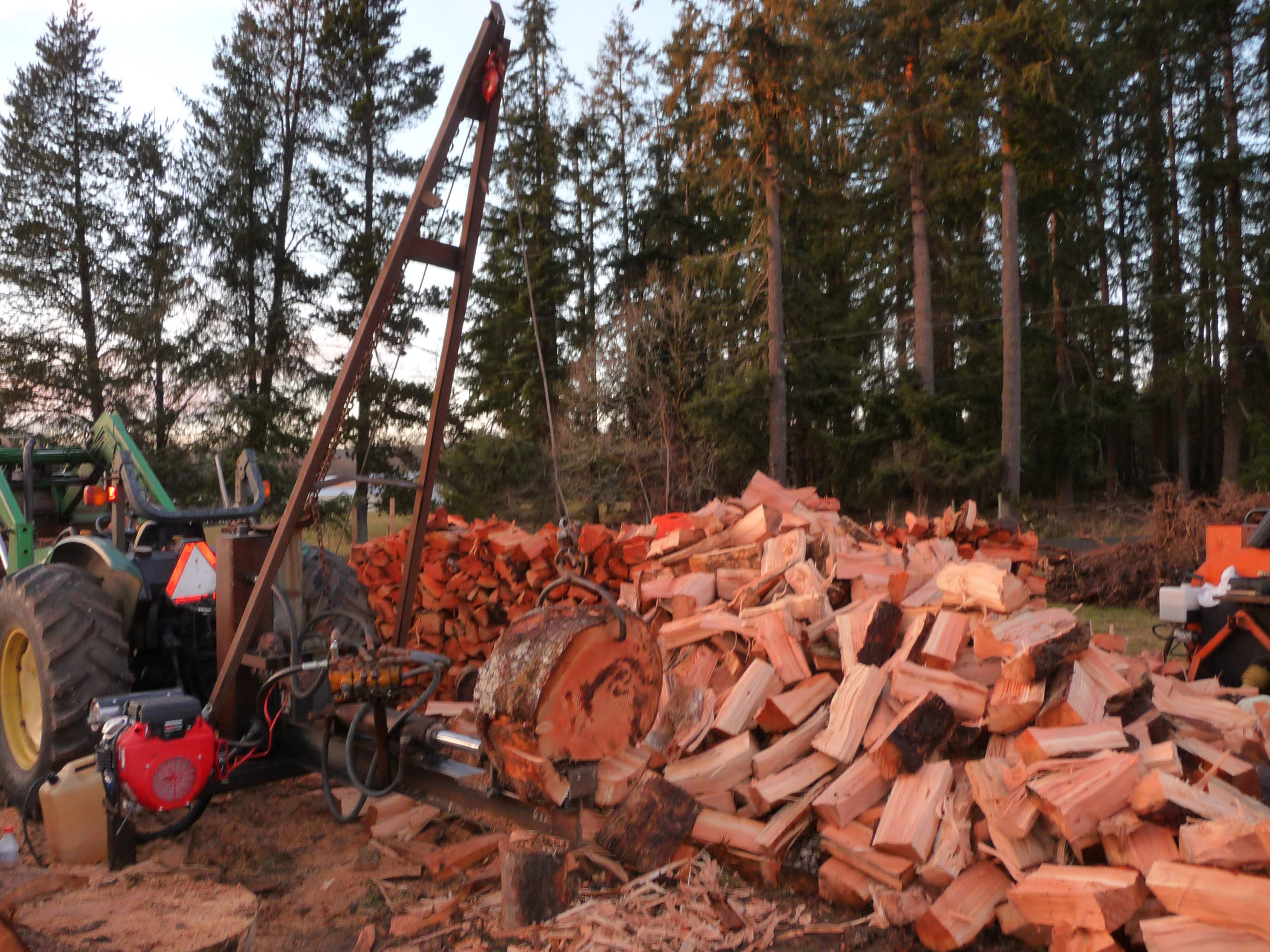

Here is my system for lifting the heavys. The T knife keeps the block in one piece just taking two off the bottom.
Whitepine2
I agree with what you are saying. Both have actually been discussed since I made the wedge change. I will say that the wood being split in the video was extremely stringy. I really need to learn to not fight it, and just drop another log on to push it through.
