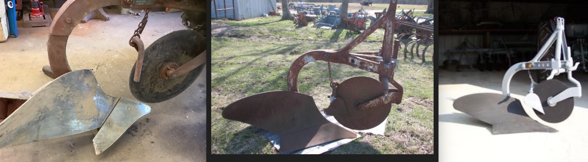

I have read posts by jeff9366 and farmwithjunk, but still have trouble. I have a Ferguson 16A single bottom plow behind a JD 1050 fwd. The tires are 13.6-28 on 12" rims, and the wheels are set as narrow as possible. It is 37" between inside sidewalls. I raised the left rear tire 8", and adjusted the plow per jeff and farm .. instructions . In practice the plow tracks true and sucks as much as the miserable soil will allow, but the furrows are nearly 2 ft apart. The plow beam is set as far to the right as possible on the offset drawbar, and the stay chains on the bottom links are tight. Rotating the drawbar small amounts just to see what happens doesn't make much difference. BTW, my previous tractor was a Ford 850, and the plow was just as uncooperative. Is it possible that this plow was intended to be used on a particular make and model of tractor? Does my 1050 need to use a specific brand of plow? Any insights are most appreciated.

A picture from behind would be a big help, with the plow mounted, setting on the ground. Take the picture(s) lining up with the inside of the right rear tire, a few feet back.
The back end of the share, should at the least, line up with the inside of the right rear tire. That way, when that tire is in the furrow, it will cut the next furrows bottom, clean into the previous furrow bottom. If not, it will crowd the plow to the left.
Does that plow have a tail wheel..? The tail wheel should ride against the furrow wall, and help hold it in place.

The Ferguson manual is exactly what I need. IMG_0163.JPGIMG_0165.JPGIMG_0163.JPG. It seems that my problem stems from damage suffered by the plow many years ago. The beam was broken in the curve, but appears to have been well-repaired with long 1/2" fish plates welded to both sides. For all rocks I have hit, there is no sign of stress or failure. The serious problem appears to be the share. From the point to the wing tip is 18 1/2", and the rough wingtip indicates modification with an acetylene torch. The landside is 17" long (not including the point). The distance from the landside to the wingtip is 10 1/2", and should be 16". To achieve the 16" it appears that the share should ~28" long. Does that sound right? I searched the internet for Ferguson plow parts and came up with nada. Any suggestions?

Your plow and two other Fergusons.

They did make an economy short share. Along with that, the moldboard was longer, narrower, and had more roll to it. If I remember right, it was designed to plow sod, and turn it over well to cover. Back in a time, when farming was more diversified. Fields would be sown for grass for hay, then 4, or so years later, after alfalfa, or clover reached it's peak, it was then turned over to pasture. Somewhere within the crop rotation, sod was plowed under,and a commodity crop was planted starting the cycle allover again.
If you can't adjust the plow's drawbar far enough over to align the wing tip of the share, with the inside of the left rear tire, then it is going to kick sideways, doing what it is doing now.
You may be able to replace the share, and get what you need. But, you may need to replace the moldboard, and possibly the landside also. That being said, oem parts are nearly non-existant, but there is hope. There is a fellow here in Ohio that makes new "Blacksmith" shares. Last year (I think) I guided a fellow in Washinton State to him, who had an IH Fast Hitch Plow Chief plow, and had exhausted all efforts to find new parts, and was afraid he'd have to find another tractor to plow his acreage he grow produce commercially. I sent him the link to Ploworx, and within a week, he was back to plowing. The fix wasn't cheap, but a lot cheaper than replacing his tractor and all.

I don't plow often enough to justify any serious investment. I plow and harrow after digging up Christmas tree stumps. This smooths the ground and distributes 8-10 yrs of fertilization applied in bands. For serious deep incursion into the hardpan I used my newly- fabbed subsoiler today. It would have sucked the draft links right to the
ground ! With this new knowledge, I think my plan will be to subsoil for deep impact, followed by a 10" Brinley plow behind my Ford 1210. Jeff's plow manual gave me all the critical dimensions needed for me to make an educated decision.
