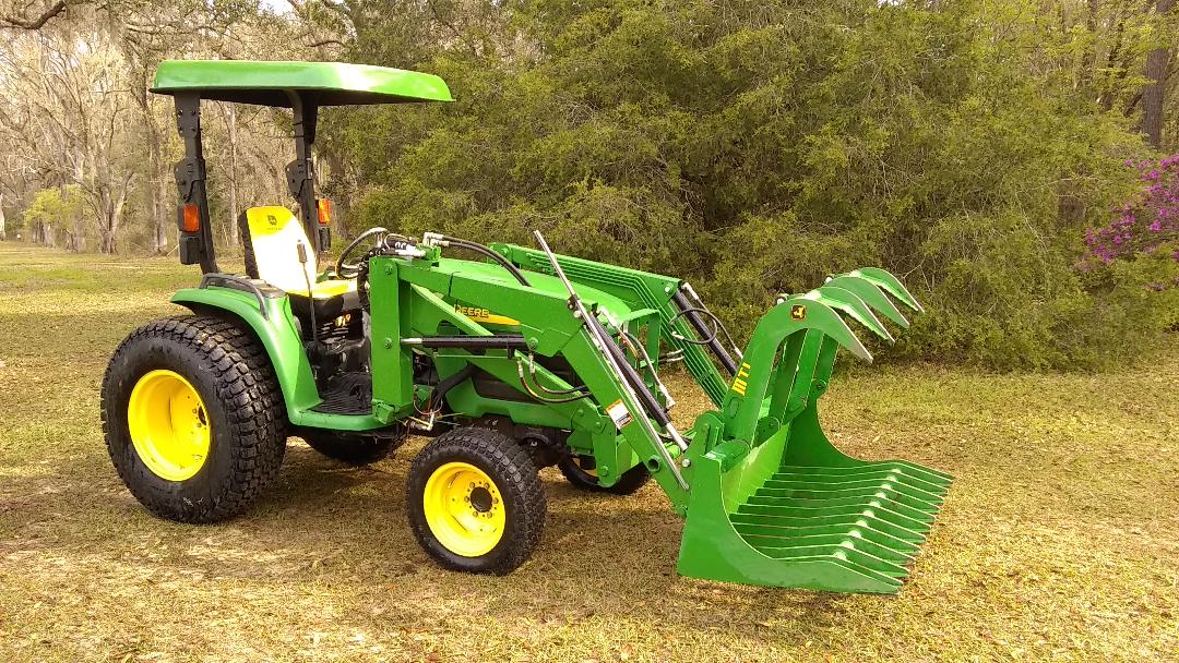

I have the 60" RK5 in JD mount and it is plenty strong. I hear some bad mojo on MTL customer service but my grapple showed up to my door in 3 days and hasn't had any problems.
In my opinion you don't need any wider than 60".
Pay attention to the bottom tine design and make sure it will do what you want. If you are wanting to rip roots the RK5 is not a good design for that. It has one advantage that the back is solid so you can actually use it to rough grade like you would with a front blade. I find it works best for picking up piles when I turn it 90* and come straight down on them. I don't like the clamp tines on mine are not designed to meet with the points of the bottom tines but I think they changed that.
