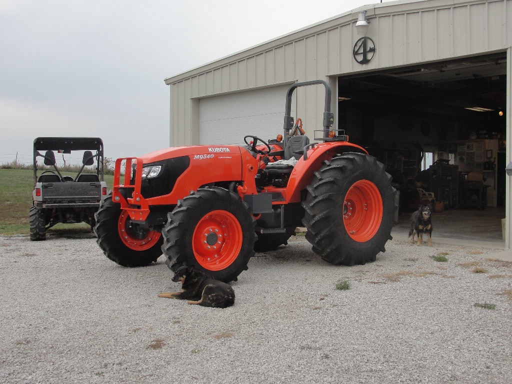

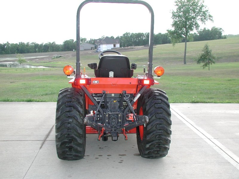

I believe ROPS are designed to give the manufacturer a bit of defense in court, as mentioned by many before. I also believe that when manufactured there is little if any thought given to providing space for the operator to survive a complete roll over. The larger the tractor, the shorter the ROPS, by design, because of the added weight stress. It has to be shorter to survive the roll over. Again, with little or no concern for the operator. Here's 3 examples. When you look at the pictures imagine where the operator's upper body is going to be in an upside down situation with his lap belt on.

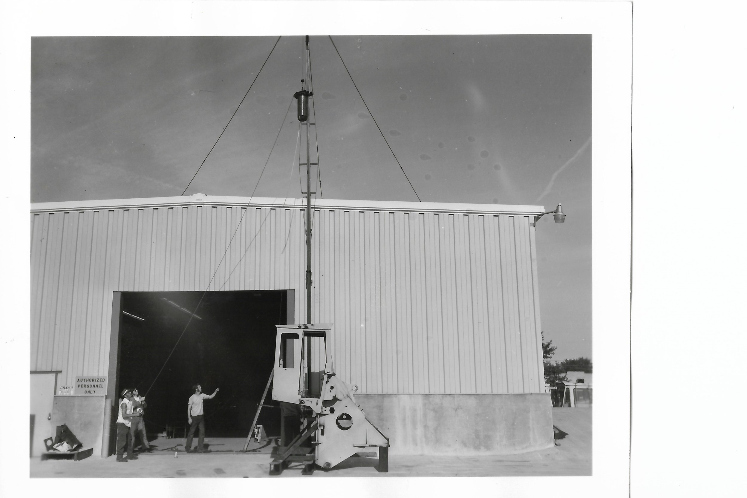

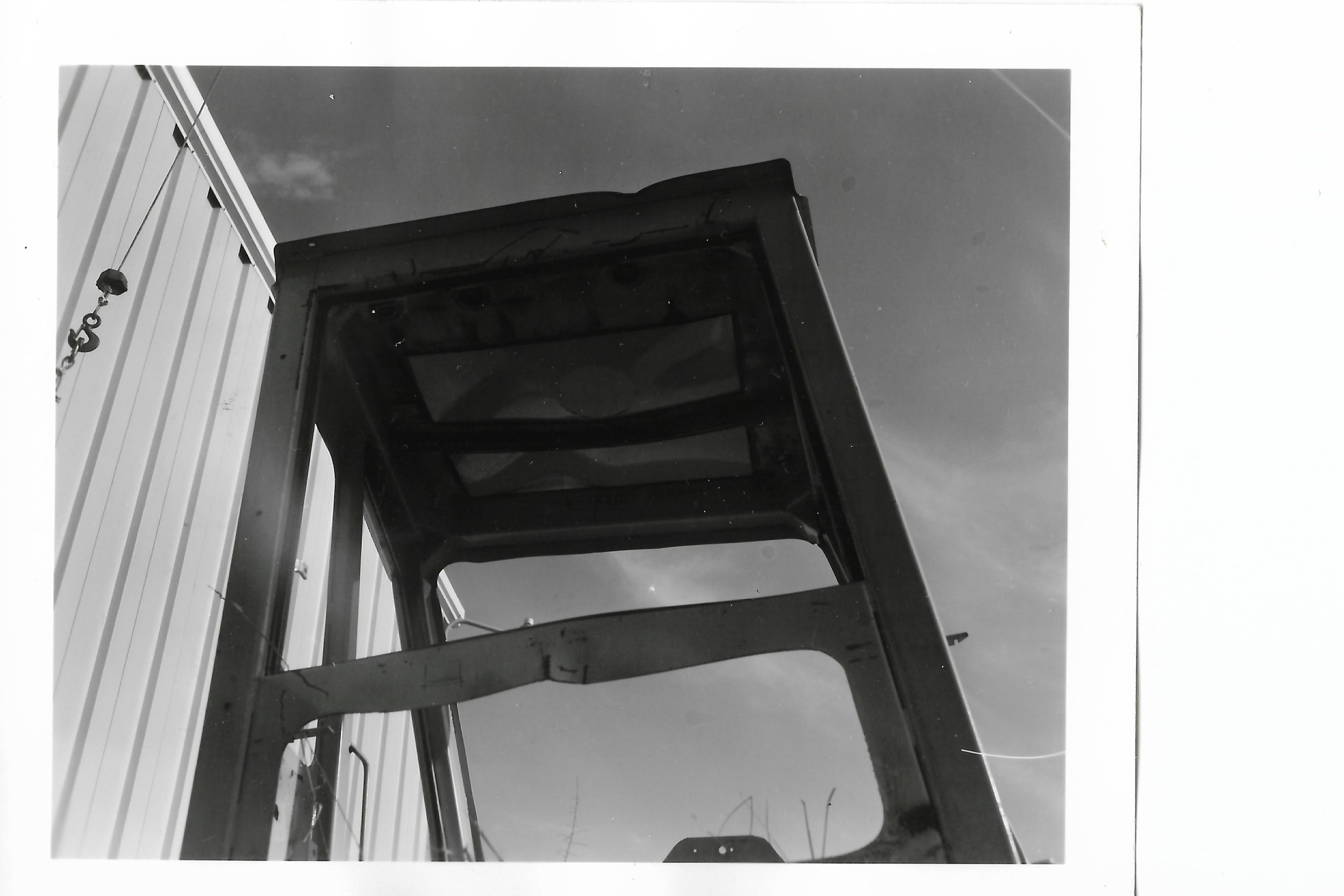

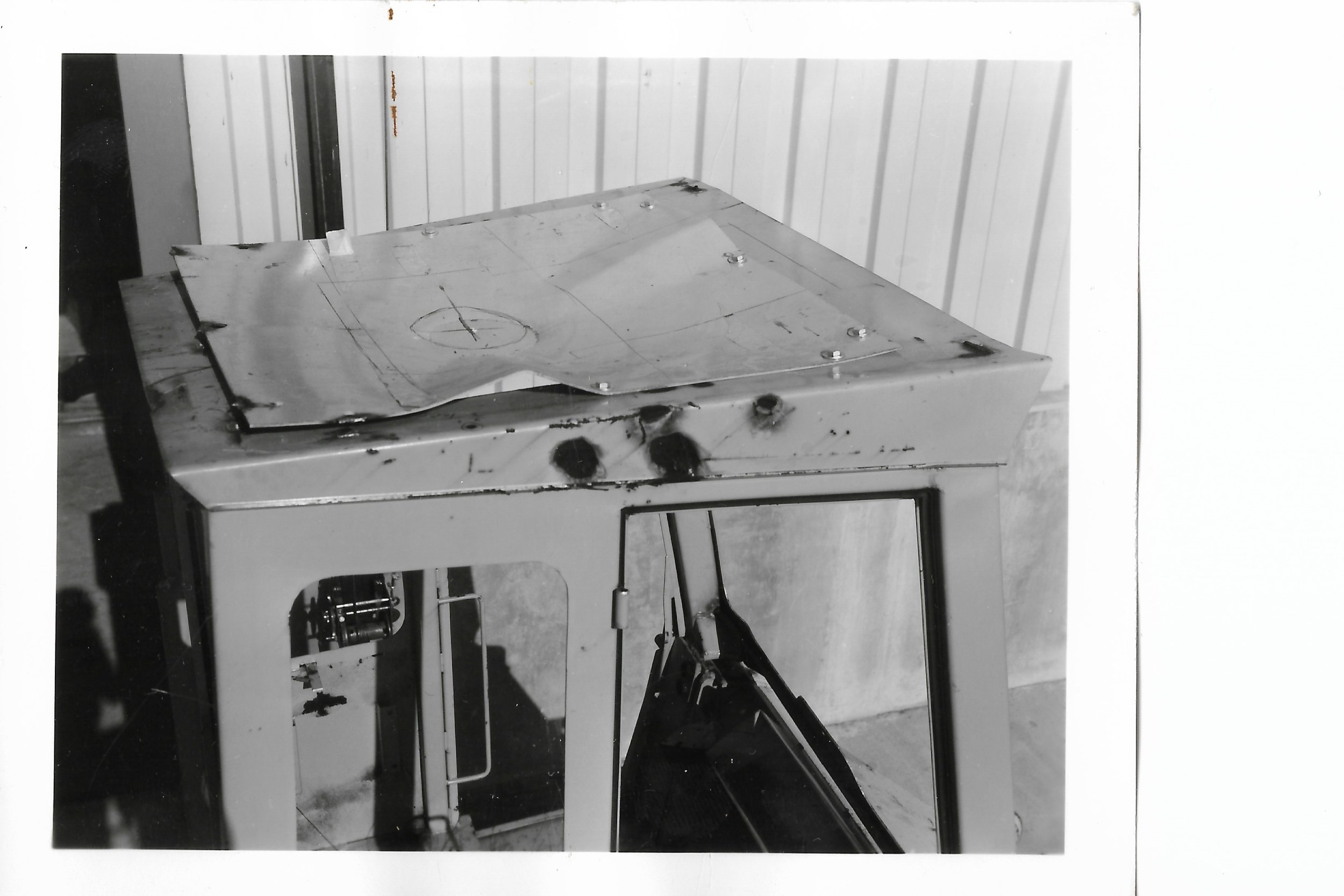

What are you trying to protect yourself from? Also what tractor are you mounting it on? Aluminum will most likely have more deformation than a steel plate. If memory serves right its SAE J231 that regulates FOPS. Here are some photos of a FOPS test for a Hough H60 by Sims cab company in 1975. You can see how the entire cab collapsed. I know that this is more severe than you plan on encountering, but the forces of a falling object can be significant.
Also it would have been better to start your own thread rather than revive an 8 year old one.

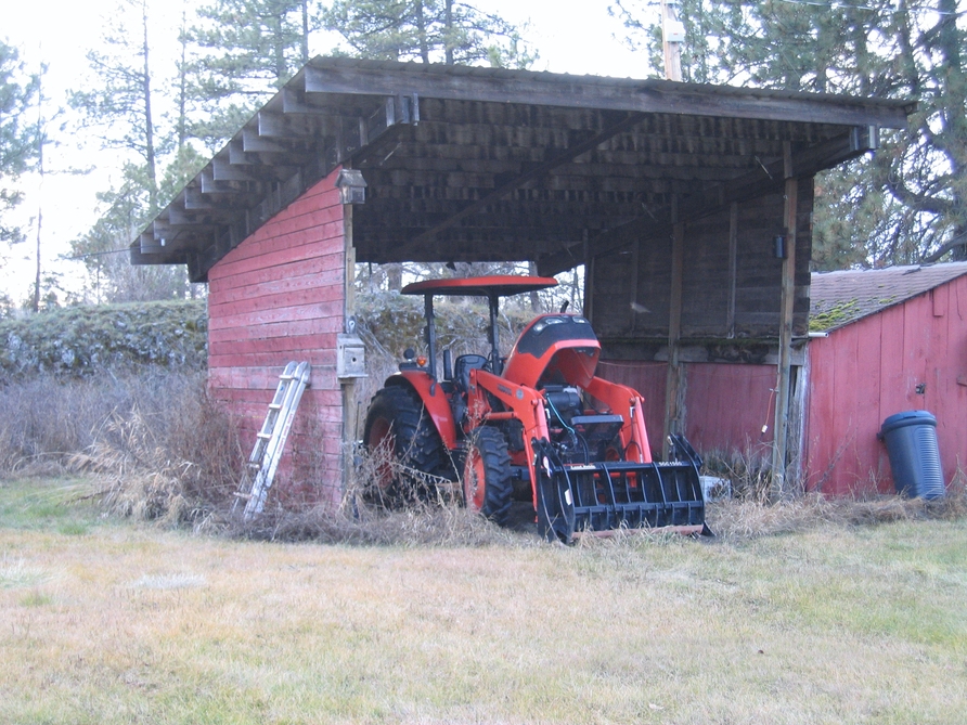

My Kubota M6040 would only fit in my carport stalls with the ROB folded. So.....this was my answer.
