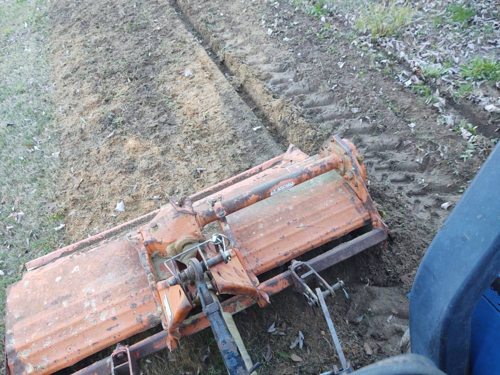

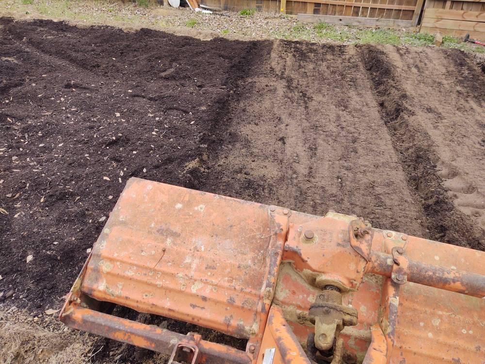

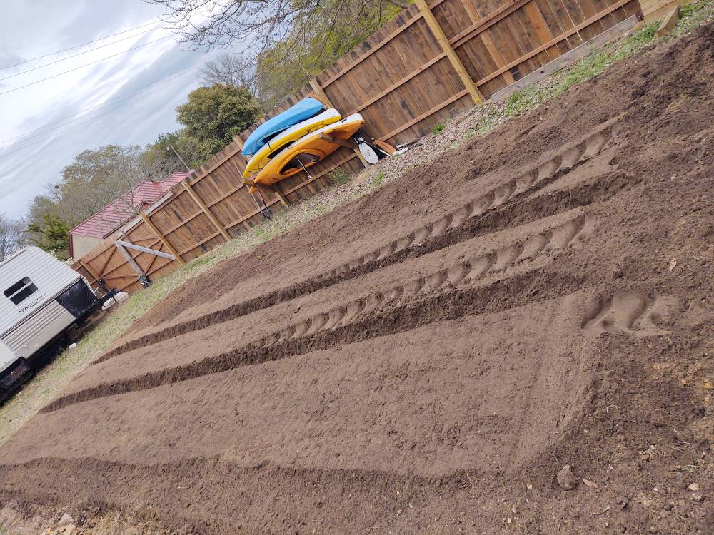

I've decided to start a small garden. I borrowed a tiller from my uncle, and HOLY COW that is an awesome attachment! Might have to pick one up some day! Unfortunately they're expensive . My plan was to just tear it up with a middle buster and use my walk behind cultivator to till and mix it up, but this made quick work of it from start to finish, did a much better job, and was EASY!
