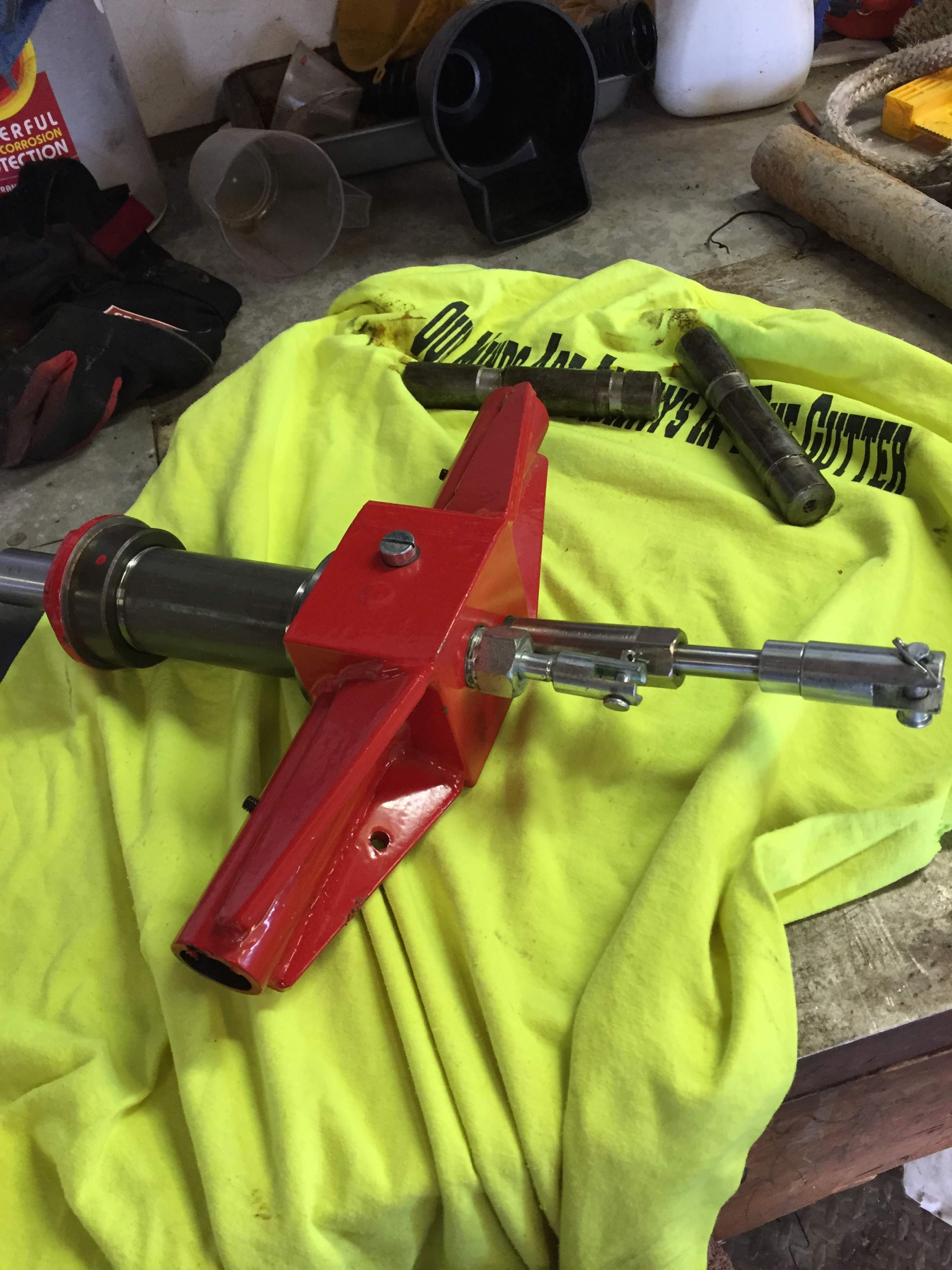

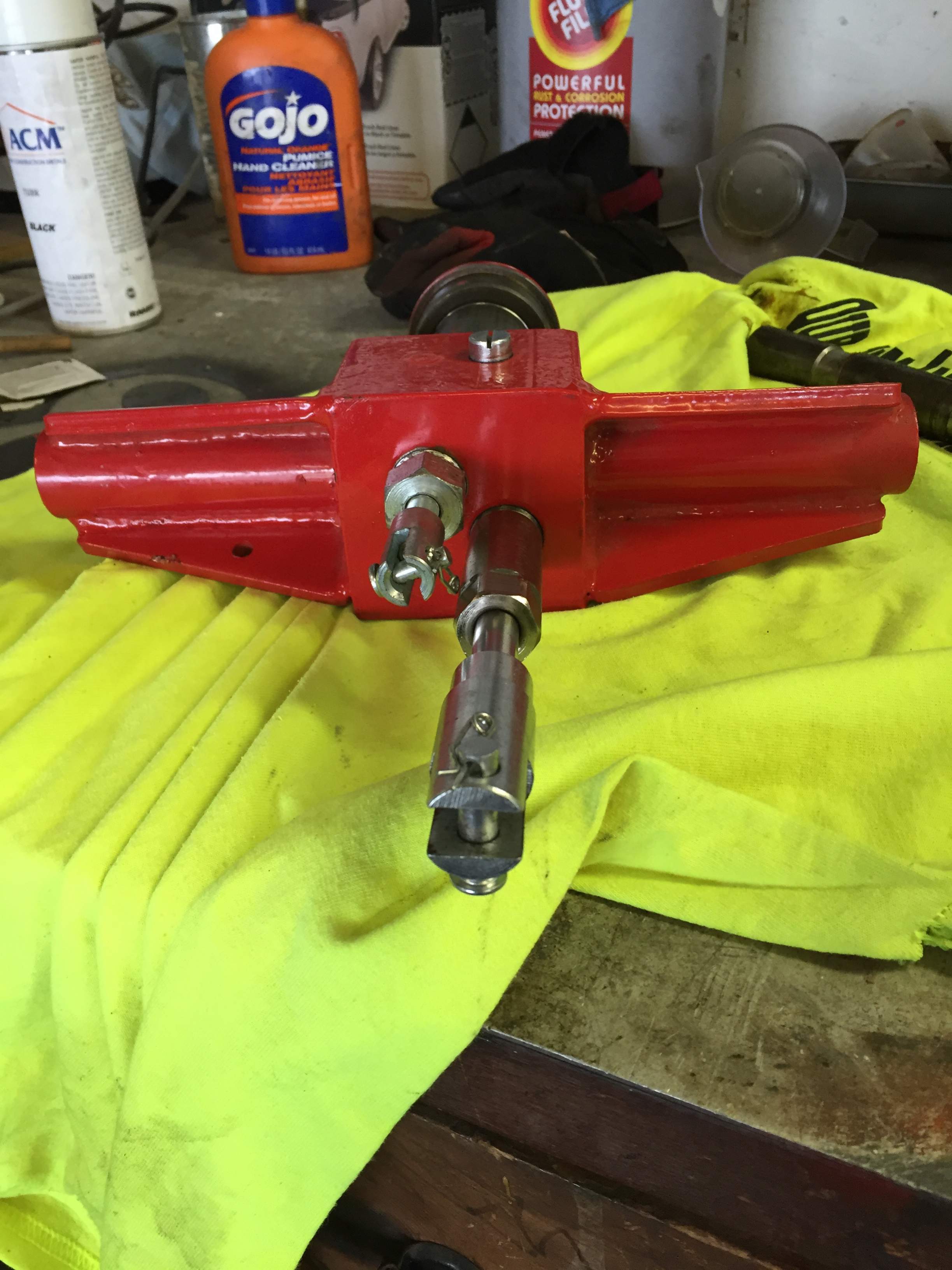

OK, I have a Harbor Freight 68892 motorcycle lift table. The hydraulic cylinder will raise the table just fine, that is until you actually put a motorcycle on it. Someone on a Harley forum has shown that they've converted it to air over hydraulic, but their posts are a little bit light on specifics. They've posted some pics but not really a step by step and a little vague. Harbor Freight lift table conversion to air - Page 4 - Harley Davidson Forums
I've removed the hydraulic part from the table. The pics will show what it looks like.
I'm considering an air operated hydraulic unit like this: 10 Ton Porta Power Hydraulic Air Foot Pump Control Lift Replacement 170 PSI New | eBay
Has anyone here attempted a conversion like this? Any ideas as to how to plumb it up? Here's what the jack now looks like since I removed it from the table and stripped the outer jacket off it, just like the pics in the HD Forums link show. The larger linkage pumps the jack up to raise. The smaller one lets pressure off to lower.

I see that there are over 200 views on this thread, so someone must be curious. So here was my solution. Instead of trying to fudge my way through and probably blowing any seals that aren't already compromised somehow in the HF cylinder, I took the easier route and ordered what are probably better quality parts to start with. A replacement cylinder that runs with either manual foot pump or air foot pedal. Below are the hydraulic cylinder and foot pedal links if anyone else should happen to have a HF lift crap out on them.
LD1K & 1000L Replacement Hydraulic Pump - FREE SHIPPING
Redline RE-RFP Replacement Foot Pedal - FREE SHIPPING
So now I've got $250 more into a $299 HF lift table. The replacement parts are only slightly more than if I would have purchased the parts to try and plumb up the old cylinder and add a foot pedal. And there will be much less labor and plumbing involved.
It's always buyer beware with HF stuff, but a lot of guys have posted online about how they've had good luck with these tables and saved a ton of money over other brands. So I rolled the dice. Came up a little short this time. But it'll be better than new when I'm done with it.

Just ran across this post by accident. I'm in the process of converting my H/F lift to a Hyd unit using a Hyd Cyl and a Air/Hyd foot pump. I'll post up some pics soon so if there's still some interest in this mod to others, maybe it's make your job easier.
I'll have to admit, I too went with the 12T air over H/F jack at first, but as stated above the jack failed to lift more & more even though I did a full bleed of the system over and over. Took it out and tore it apart only to find the the problem is with where the oil pick up is located within the jack body allowing it to suck air. This is what caused me to change direction and build a jacking system designed to operate in all positions. Stay tuned.......................

Are you sure its not the bleed down valve unseating under the high pressure needed for the heavy load? - - I believe the valve is seated by a spring force that you overcome with the lever to lower the table. Perhaps that spring is too weak or there is a speck of debris in the valve.
