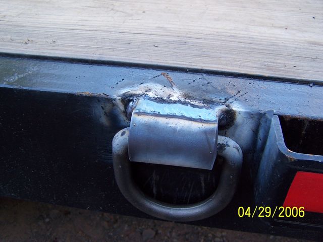

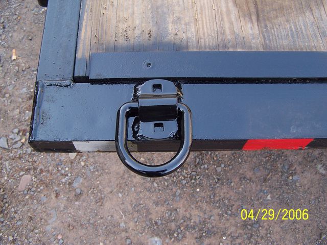

Please do not mount them to the wood! The wood is just secured to the cross-rails with #8 or #10 self-drilling screws. Even attaching the anchors through the wood to the cross-rials may not be a good option because they are usually just 2x2 angle iron.
Your anchors must be attached securely to the structural frame of the trailer, preferably by welding, or with appropriate size/grade hardware. Why not consult the dealer that sold you the trailer for his opinion?
/ Mounting D rings #4
Countersunk D rings mounted in the wood deck are fine for securing items of LIGHT LOADS ONLY to your trailer. Never just lag screw a D ring to the deck. It won't hold much of anything ESPECIALLY NOT A TRACTOR. If mounting D rings to the deck use bolts that go all the way through the deck with large flat washers and locking nuts. Mount them so the underside will straddle a structural support.
To hold or secure equipment to your trailer you need to use the stake pockets or weld or bolt D rings to the metal frame of the trailer. If bolting your D rings to the trailer frame use grade 8 hardware.
When I bought my trailer I had the option of it coming with D rings installed. I chose to install my own. Once I knew where my tractor was going to sit on the trailer I welded my D rings to the metal trailer frame on the sides and back. I put 2 on each side and 2 on back. For front securing I use the bar like you have on yours.
I bought my 5/8" D rings at my local TSC store and welded them on where I wanted them.
