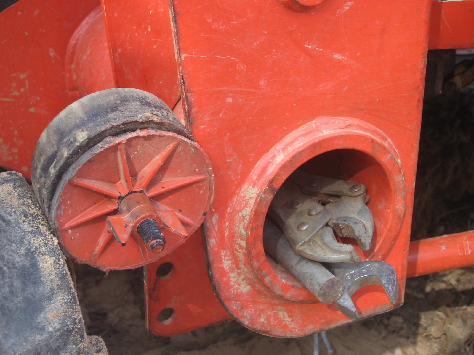

I mounted a pvc pipe with cap on top and bottom and attached to my FEL posts.
/ Mounting small tool box #5

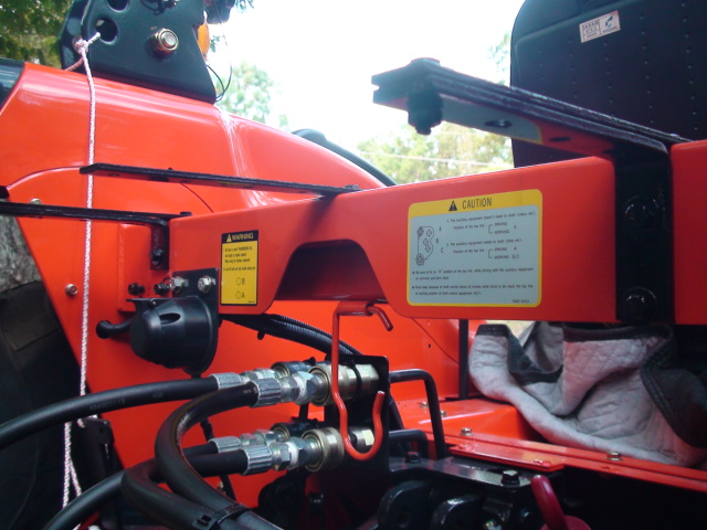

Did your tractor come with a very small toolbox on the frame behind the seat? I had a very small, almost useless one on my L2900. When I bought my current tractor, MX5100, it had a small toolbox mounted in the same place. I replaced it with one from Tractor Supply that is much larger and more functional. They offer 2 sizes and a nifty mounting system. There are usually a lot available at other sites as well. Measure and seat what room you have available and then search for tractor mounted tool boxes.
/ Mounting small tool box #8
I also moved my fanny flag and mounted a tool box on bar behind seat.

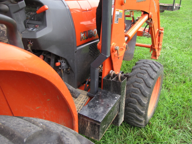

Funny as no one else here would do it but I bolted a plastic one right on top of the engine hood. 6" wide and 18" long with a center removable shelf. I keep wrenches, extra pins, rags, pliers, ibuprofen, an assortment of extra clips in pill containers and a fer screw drivers. Yes, the shovel goes sideways through the hole in the loader as others have shown.
I also have an old air bottle with the valve removed and the bottom cut off attached to my loader with the large open end up and valve end down to let water drain. I have a 20' chain in it with hooks on both ends. When you have 75 acres, it is just to far to run back to the barn for stupid little thing.

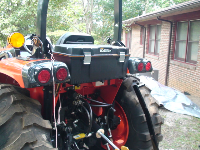

Here is what I did to my Kioti DK45. It is a water sealed Stanley FatMax 28" and holds all of the stuff I need. It is stuffed full... Stanley also makes an identically designed 23" wide box.
The first photo shows the steel supports for the box which are Stanley 1/4" flat mending plates and 12" angle available with pre-drilled 5/16" holes. These are available from your local home center. The front 2" of the tool box is supported on the factory cross beam with the rest of the box supported by the extra metal I added. So far it all sits level and rides well.
With the seat all of the way back, I can open the lid half way up and get almost anything I need. To open the lid all of the way vertical I need to move the seat forward some, but this is seldom necessary. The wrenches, sockets, ratchets, extensions, screw drivers and pliers are in two tool rolls. Everything else fends for themselves.
