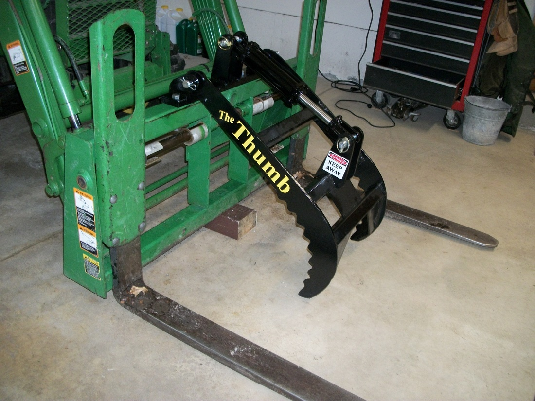

Get the forks and then add "The Thumb" for an effective and low cost solution.

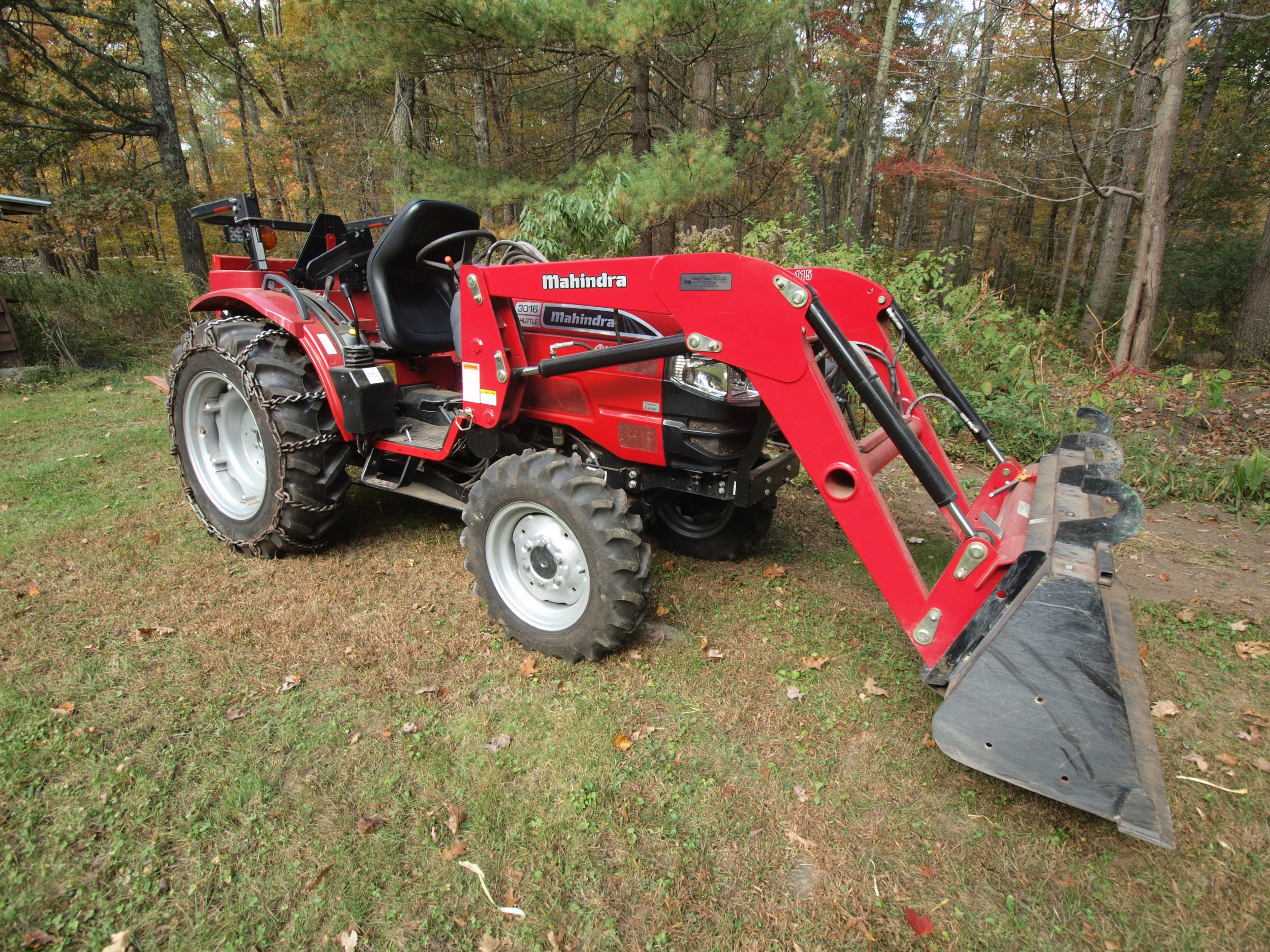

I think some people curl their buckets too much in order to hold the logs in. They also raise their buckets too high w/o tipping the bucket down for fear of losing the log.
These forks are long enough to hold the stem in and the little "curl" on the end prevents them from rolling off as I tip the bucket to approach load off.
I can safely stack logs in this way with no fear of roll back.
Those little fork bar holders I have are 8" off the bucket and can also lend themselves to prevent roll back.
They have never had to be put into effect in this way with these forks and responsible fel handling
