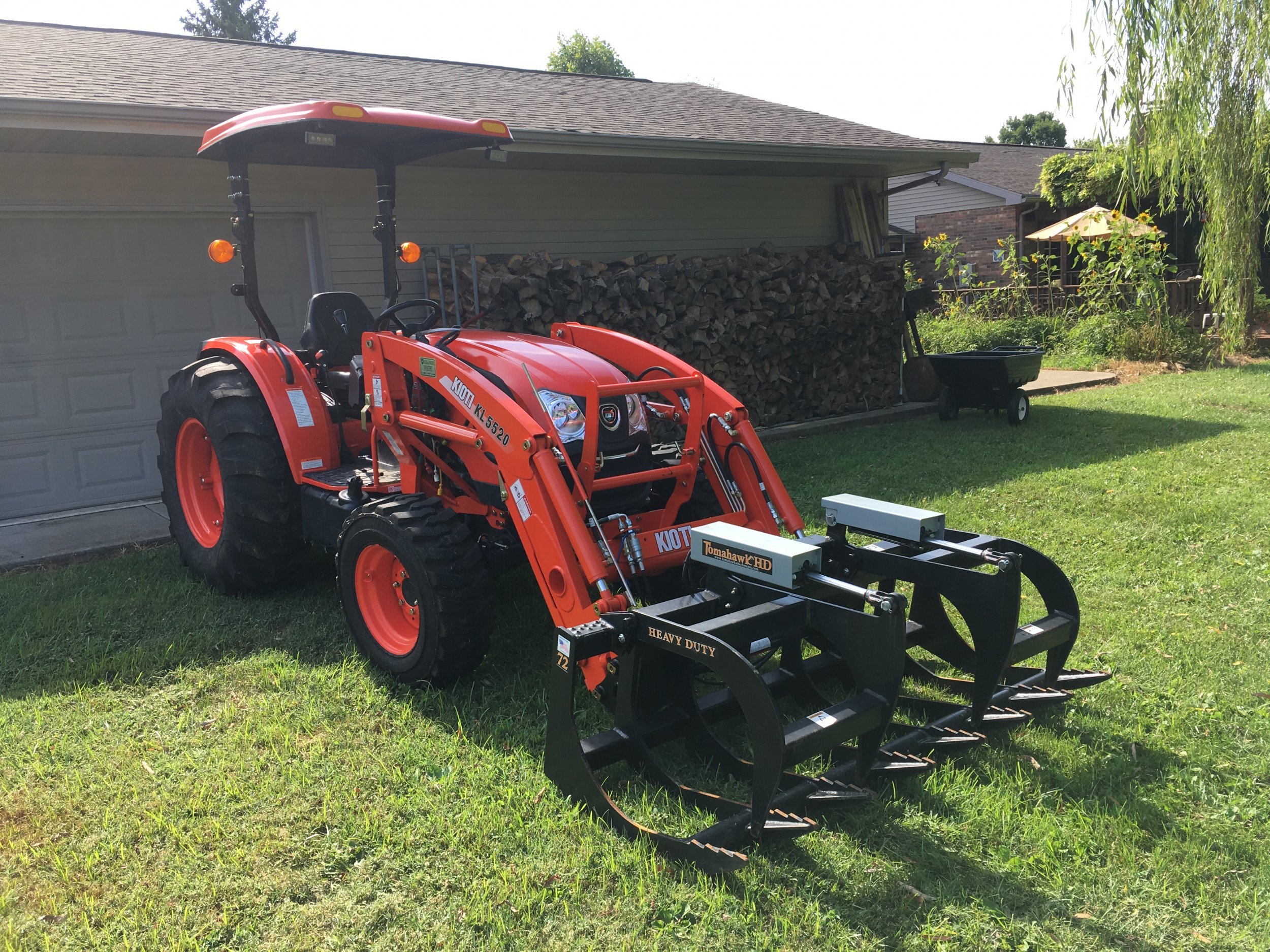

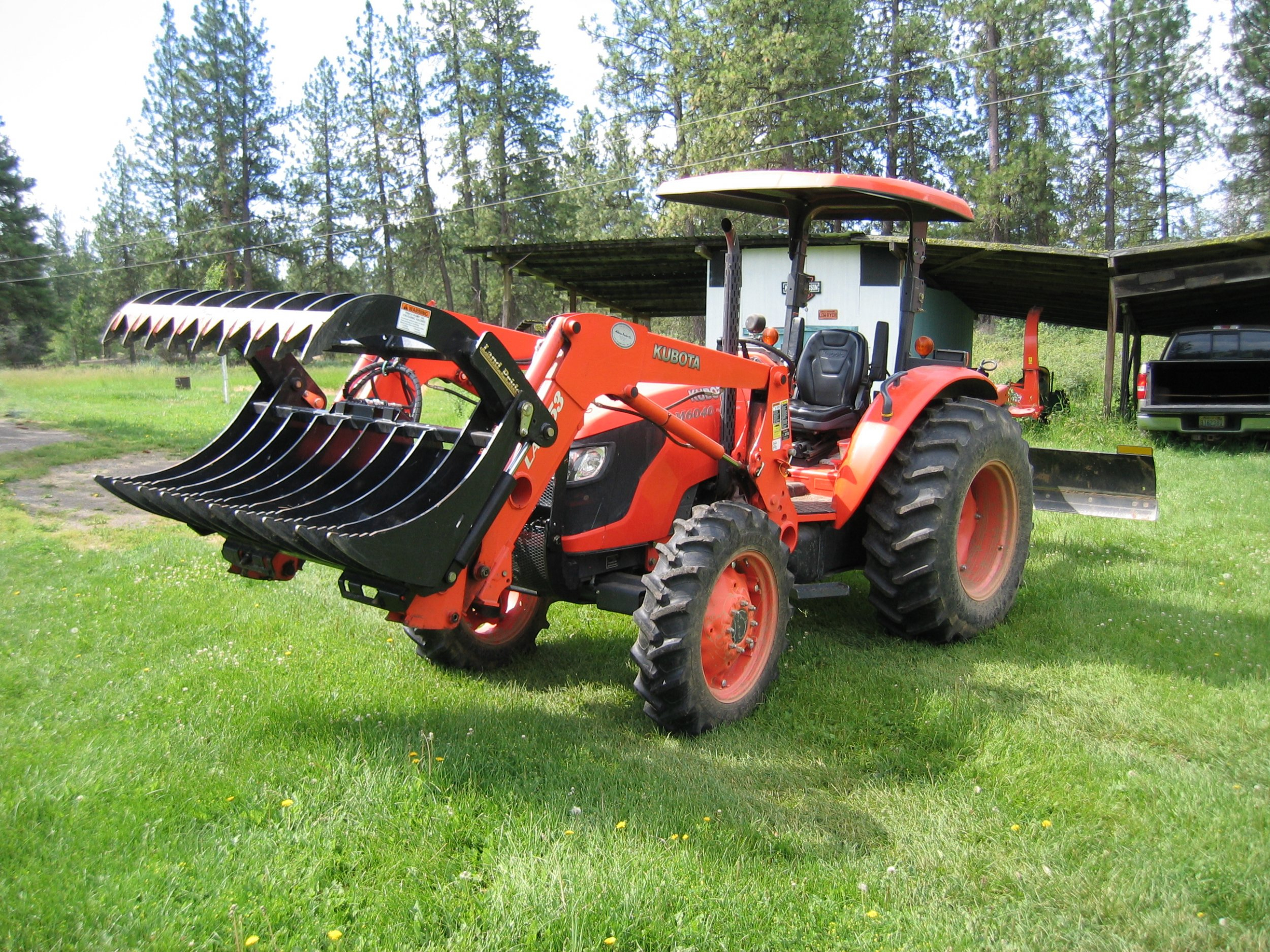

Seven years ago I bought a Land Pride grapple and WR Long third function valve. Dealer installed. The Kubota M6040 has the quick attach system on the FEL. I've never removed the grapple. Large logs, large rocks and large bites of soil - all handled well and efficiently.

I have a Kubota B2710 which I love, but here's my problem. My logger dropped a grapple load of wood in front of my garage (the only place he could) so it's difficult to get the cars in/out, and it will be impossible to plow next year. It's at least 3 years worth of wood, so I need to move at least 2/3 of the pile before Fall. So far, I've been doing this by cutting each log in half and I chain each "half-log" to the bucket, and move it to the back yard where it's out of the way. This often involves climbing onto the wood pile to unhook the chains. As you can imagine, this is only marginally safer than Alaskan crab fishing.
My dealer quoted me on a L2501HST tractor with an LA525 loader with "quick release" attachment function, and a Land Pride grapple. With the grapple, I can keep the tractor between me and the wood. Much safer.
It's more than I want to spend, but I also don't want to be maimed or killed because I was too cheap to buy the right equipment.
Does anyone have any experience with this kind of work, or the L2501 (or Lx2501) tractor? I like the "quick-release" attachment idea, but I'm afraid of trading "down" from my B2710. Not sure if the engineering is better, or whether they just made it lighter-duty to cut costs.
Any thoughts/ideas/suggestions would be appreciated.
Thanks.
Dave.

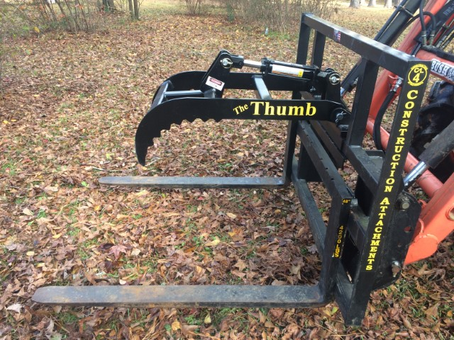

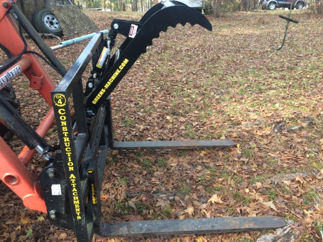

I am well pleased with my 48" Thumb from Greens-Machine.com:
