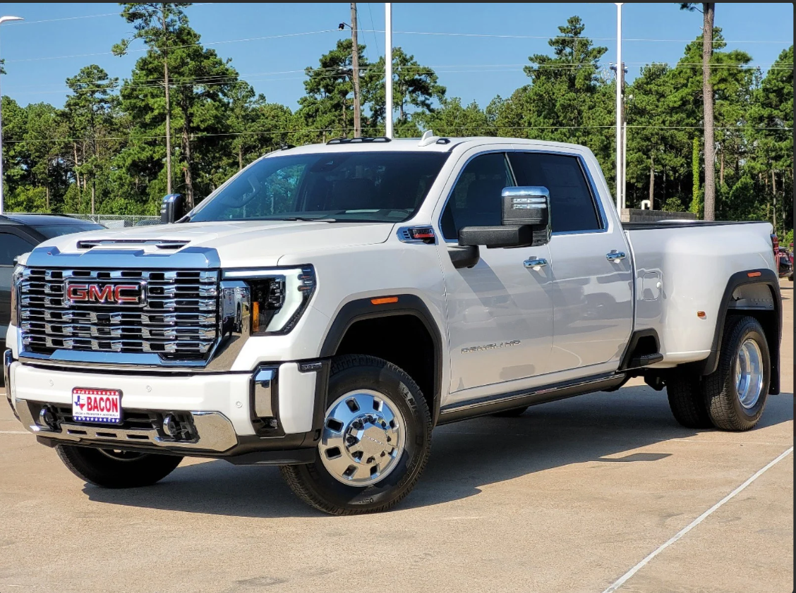

To the OP - glad you found one to buy that fit your needs. As long as you are happy, and it sounds like you are, that is what matters. Not feeling comfortable towing something, feeling like you shouldn't be doing it, is a bad thing. I am on step 3 of my 3-step plan. Tractor too small, buy bigger tractor - WM75. Now trailer too small, buy bigger trailer - Big Tex 14GN 20+5 with Mega ramps. Now truck too small, buy bigger truck. I have been looking and had trouble finding one I liked. I finally found one in transit. It's a 2024 GMC 3500HD dually with the Duramax. Just waiting for it to show up at the dealer. It will look like this one except it doesn't have power steps, just factory chrome steps. Dealer said with those, I don't have to turn in my man card.
