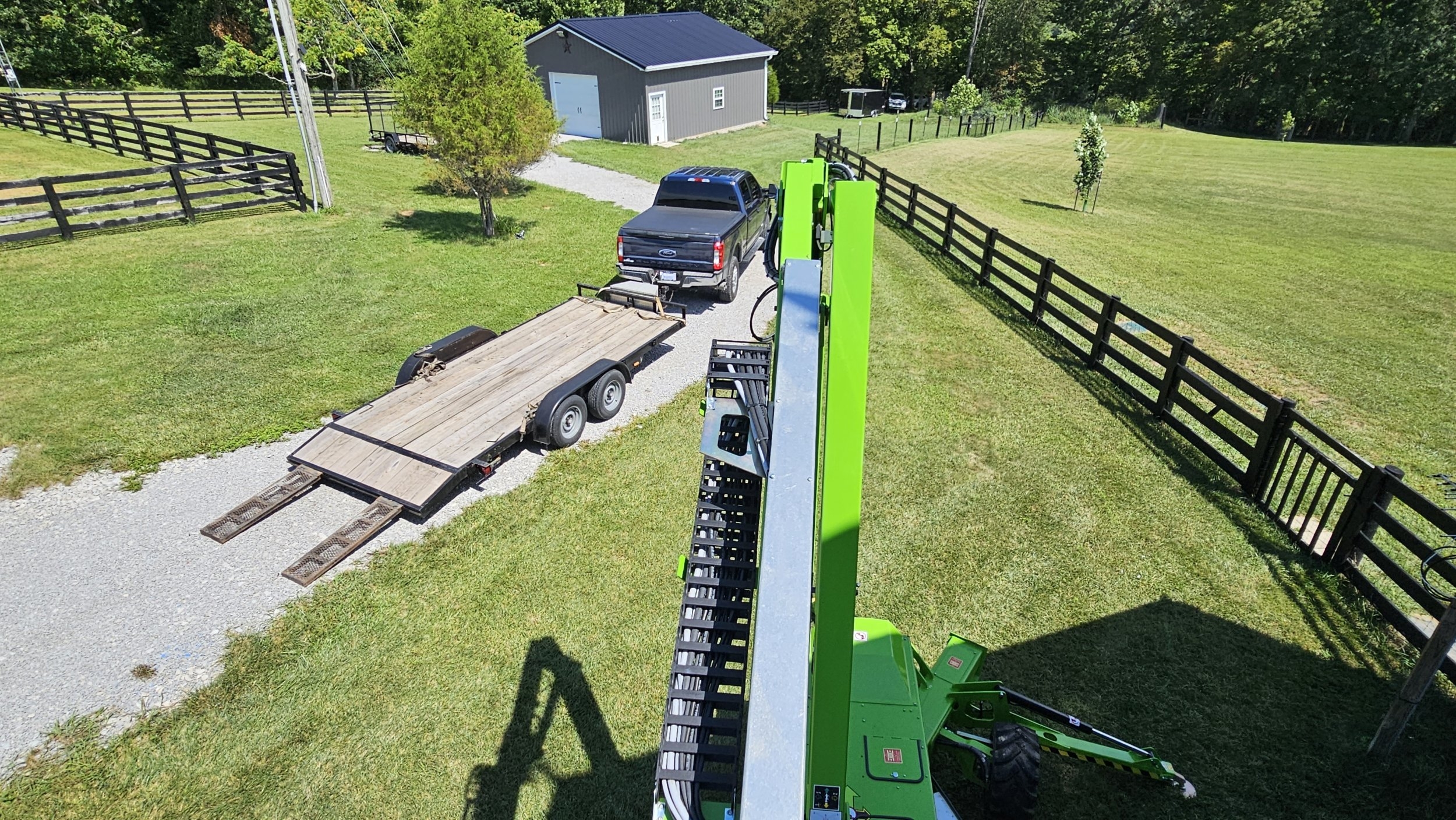

Pulled a 34' reach 4x4 aerial boom home on a tandem axle equipment trailer this weekend. Used it to get some work done up high on our house. Fascia pieces were loose from recent storms. The F-250 tows like a dream compared to all the 1/2 ton trucks I've had before. I couldn't believe the difference. Truck went to the top OD gear and stayed there. Hills, didn't care. Speed, didn't care. It just cruises in top OD gear with all that weight behind it. Never felt squirrely or out of sorts. Just a drastic difference. Wow.
For work, I love this truck. I have a car to drive the rest of the time.
