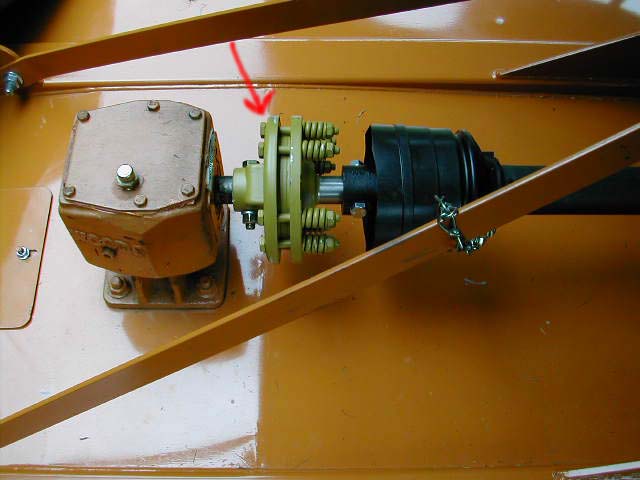

If you have a slip clutch you will have something like this on your output shaft coming out of your gear box.Other wise you will just have a bolt going threw the yoke on your output shaft.
Rick

Sorry Trev,didn't notice you were using a finish mower.This set up is on a rotary cutter.
Monkeybreath...
maybe you should look into getting a slip clutch.
Rick

Thanks, Rick.. I'll pull off some covers and see what exactly I have in there. I didn't see any reference in the mower manual to either a clutch or a shear bolt. Struck me as odd that all these people are shearing bolts, and I never have.
Thanks again,
Bob

Trev a finish mower has belts to drive the blades so they will slip some.
It isn't direct drive like a brush cutter.
