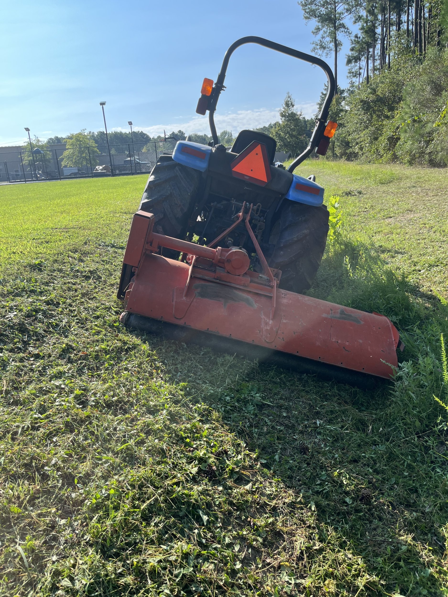

I haven’t measured the angle on this one but its about as steep as I want to go, but I can’t fall far.
