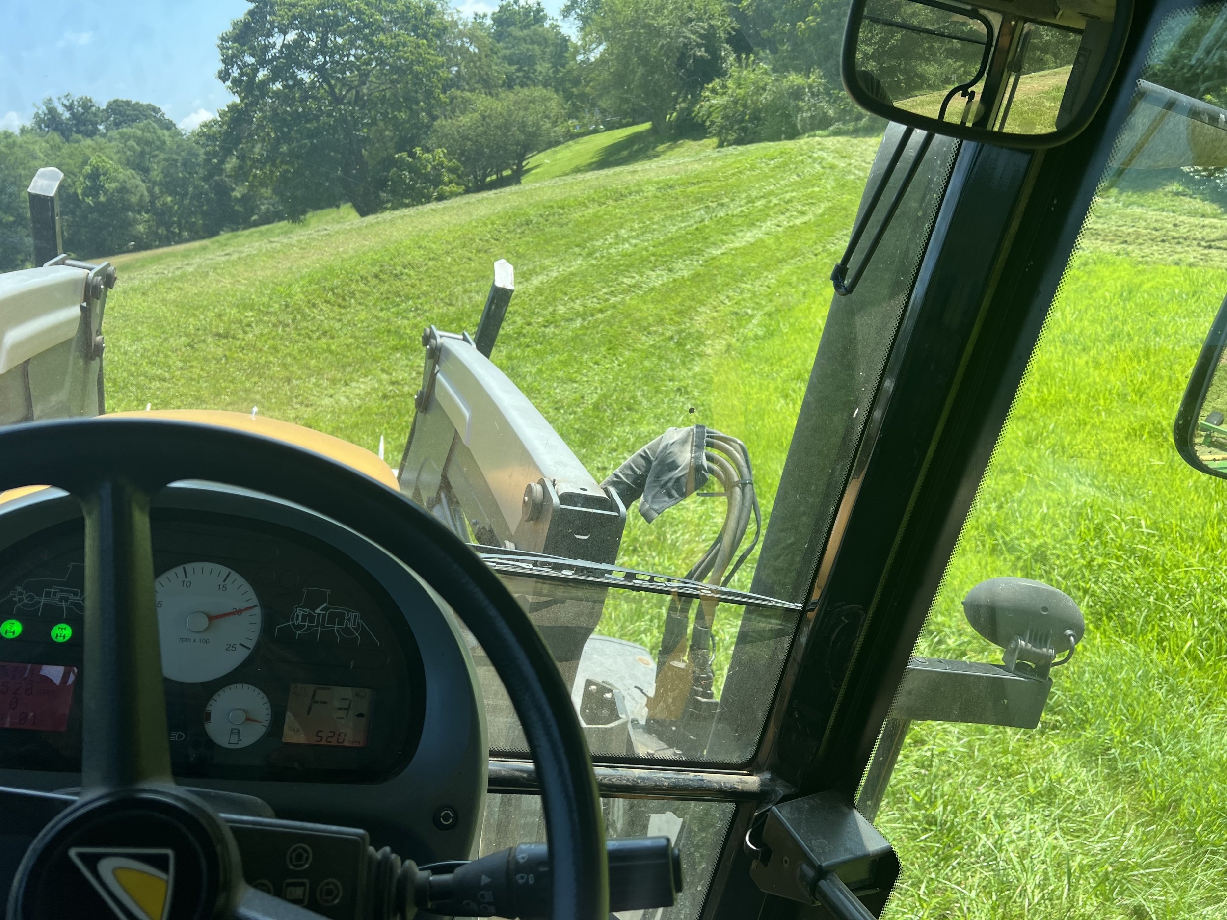

Just mowed steep slopes today. This is a water detention basin. I cut it 4 times per year.
Looming to my left is the drain pipe for the basin. I get just a few feet from it with my mirror.
All tractors & equipment have different points at which they tip. I have found in the multiple close calls I have had is they usually feel like the upper side front tire would come off the ground, or the entire tractor would begin to slide.
