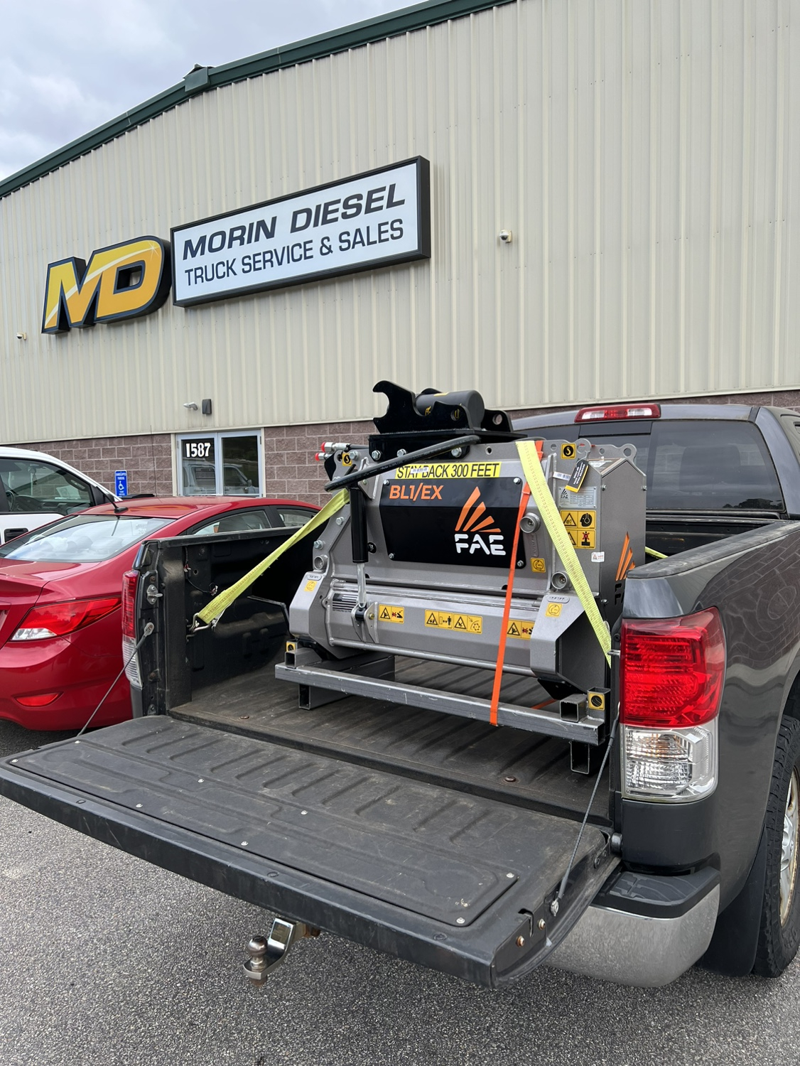

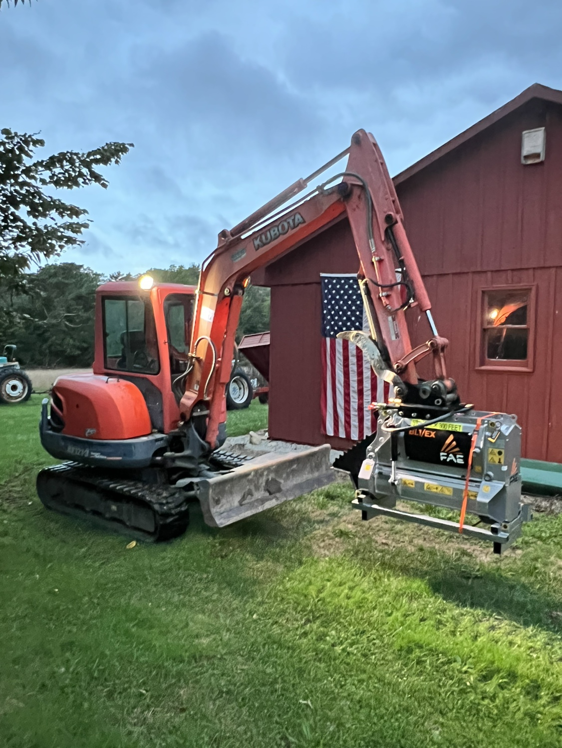

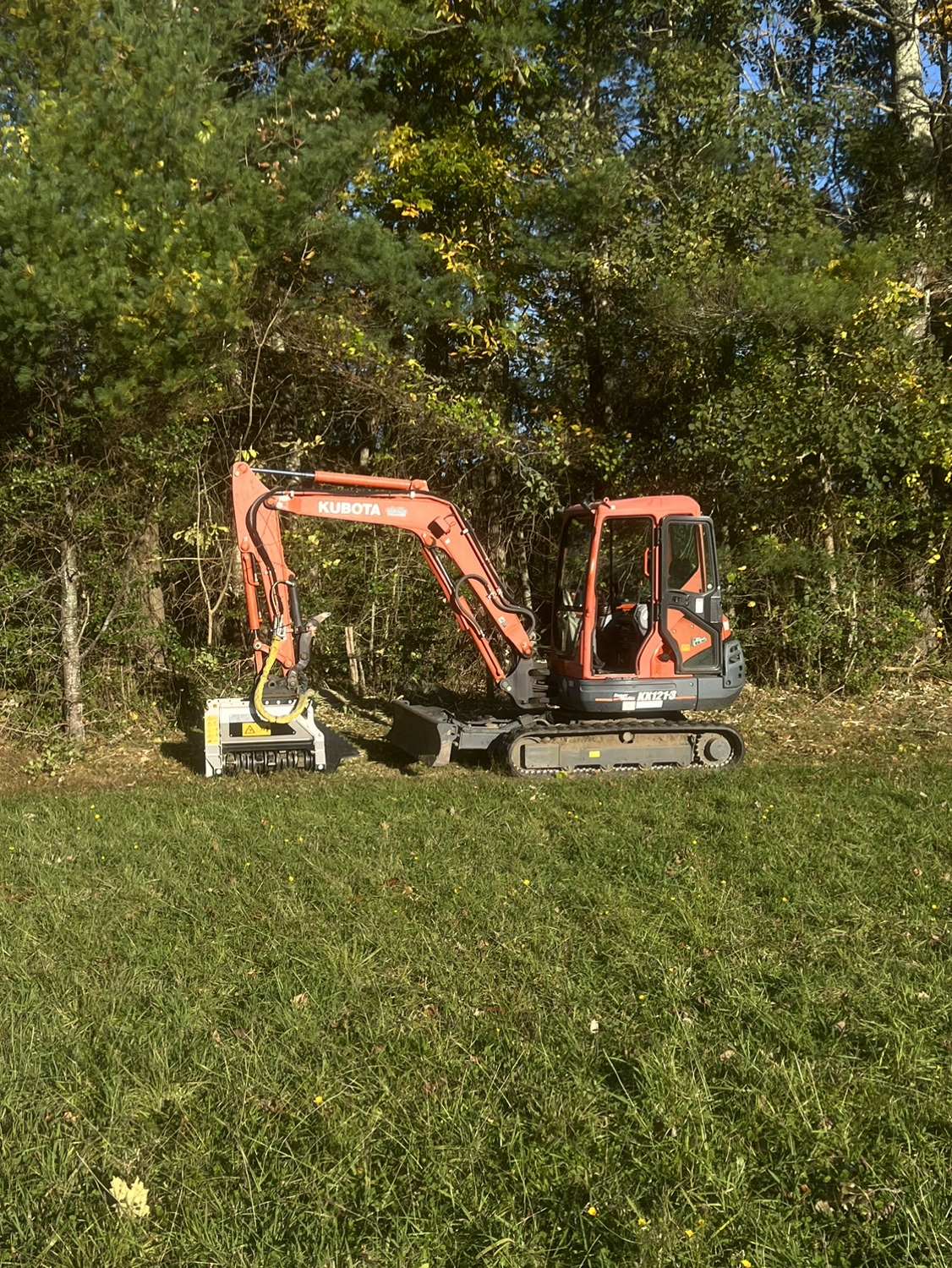

I’ll revive this thread. I finally got myself a mulching head. It’s a 2022 FAE BL1/EX 075. I’m running it on a 2011 Kubota KX121-3 with 1200hrs. I’ve got about 12 hours on the head so far, you definitely know it’s out there, but after getting used to it, it works very well. I can reach all the way out and up with it, just need to go easy. I’m real happy with it! Far better than my 3 point hitch Ferri TD42 boom mounted flail head on the tractor. Apples to oranges as to heads, I’m just saying the control you get with the excavator. I may add a bolt on quick attach plate to my Ferri TIL100 flail head and seeing about running it on the excavator. It would be perfect for grass, weeds and light brush. I need to look into flow requirements etc.

That's a real nice mulcher head. About $25k? Are you able to use your thumb while the mulcher head is running?

I paid $21k just for the head as it sits. I only have one set of auxiliary hydraulics, so no, it’s one or the other. If I ever get a new machine it’ll definitely have two sets of auxiliaries!

Your machine has 1 GPM more hydraulic flow than mine, weight should be about the same. The machine handles the weight of the head fine, but you have to go easy with it. I got the non VT head, because of flow requirements, 13 GPM for non VT, 17 GPM for VT. One dealer highly recommended VT, the other non VT. I spoke to FAE’s service department directly and made my decision based on that discussion. A friend of mine has the same head as mine on a KX057, he’s very happy with it as well. It has the hydraulic rear door (controlled through a diverter), no front door.

I’m using the two lines for the thumb and I had to run a case drain back to the hydraulic tank, there’s also a wiring harness to run.
