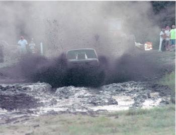

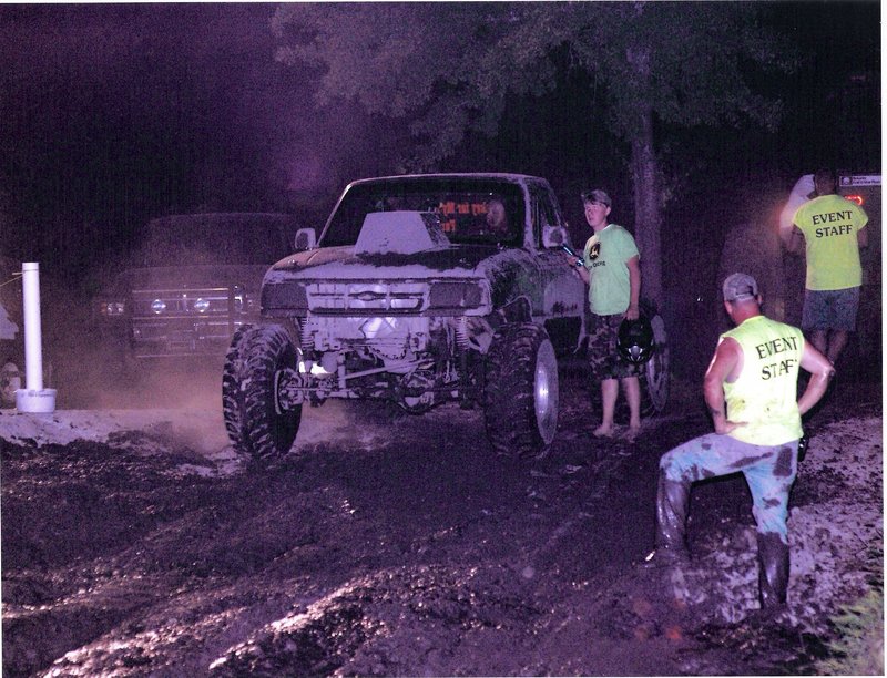

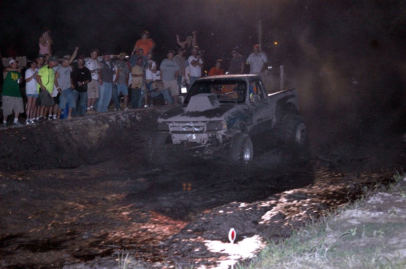

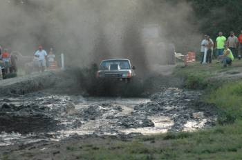

I have been known to do a little mud slinging myself. My style.

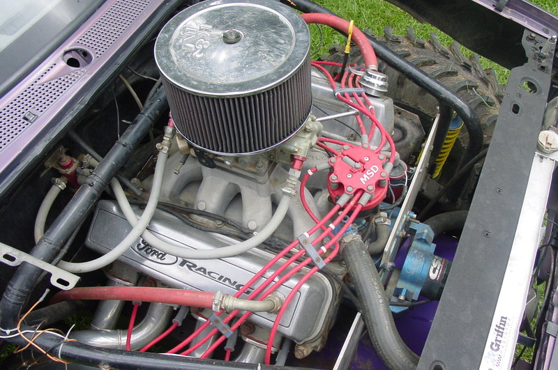

Well…. It’s a 97 Ford Ranger body and chassis but from there it’s pretty much all custom built. It has a Dana 44 front axle and a 9 in Ford under the rear. A highly modified C6 trans with reverse valve body and trans brake. The stall is a 8 in 6,500 RPM and we use a 208 aluminum transfer case. We have different tire combo's but usually in the deep mud I run 38 cuts up front and 39.5 cuts on the rear. The engine is currently a 557 cid BBF we custom built (it’s not a create motor) with a lot of extras aluminum parts. I plan on moving up to something in the 632 + range with a power glide but haven’t just yet.
I included a picture of the 557 so you can see some of the “slight” modifications..

That looks like a "Beast". Slight mods is a understatement! How many HP do you think it is putting out? Is the Power glide common in the muddin' sport? Ken Sweet

Sweet,
Yes, the racing powder glides are popular in both mud racing and bogging. They have a lot of advantages over the 3 speeds in weight and gear ratio’s.
