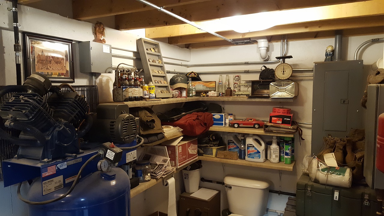

I really like the idea of lights off/compressor off... gonna have to think how I can do this simply/safely.
   / Must Have Shop Items #172

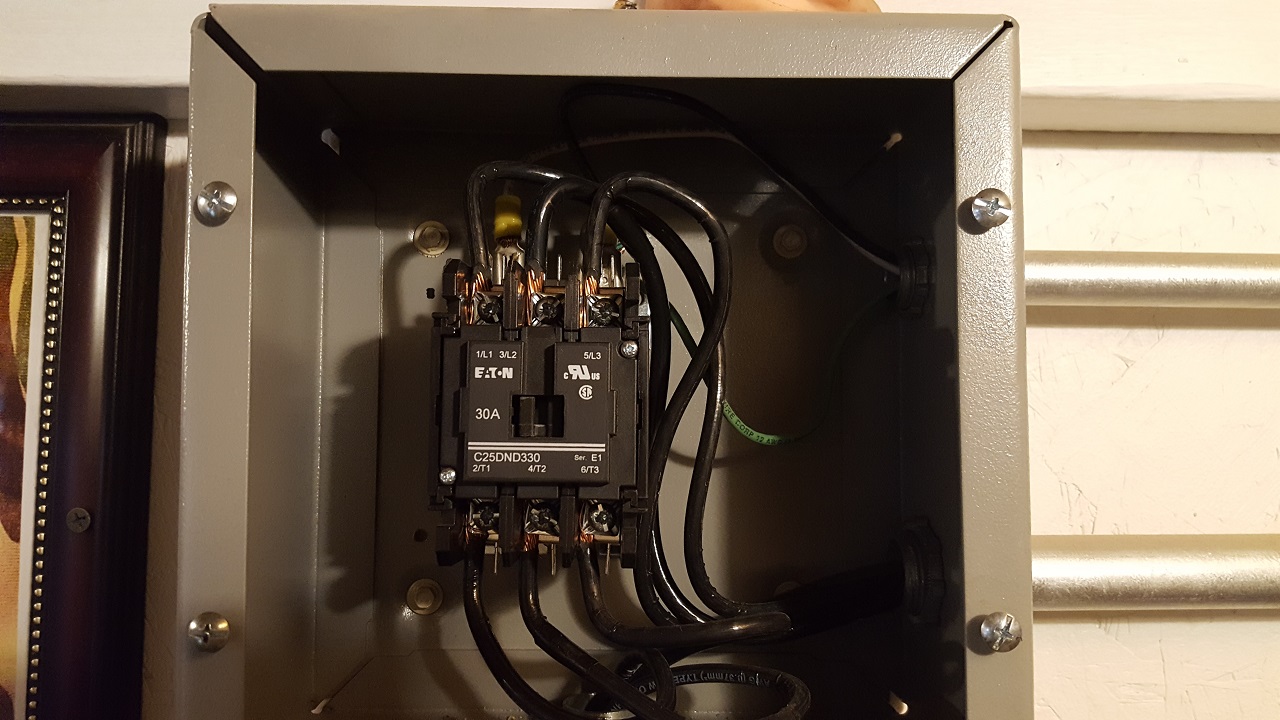

Mark, I think I paid $40 for the contactor, another $10 for the box. The box is between the power source (fuse box) and the compressor. Then add a circuit from the nearest light to the box. All of that was pretty simple for me since the compressor is in the bathroom and so is the fuse box. The light circuit was about 20ft away.
   / Must Have Shop Items #174
Yeah, I don't have any leaks either.
Good friend of mine left his on all the time. Line busted in the middle of the night. Compressor ran until it caught on fire. Was awakened by a neighbor saying his shop was on fire. He was able to crawl in on his belly and hook a chain to his Grandpa's 1970 Cadillac that he had just finished restoring. Lost everything else.
Oh, good point! Thanks for that. Never thought of a fire.

When I wired my 220V Air Compressor I ran it thru this contactor. When I turn on my shop lights the Compressor has power. Turn the lights off and the Compressor is disconnected.
I was thinking about doing something similar to your idea about 10 years ago. But instead I opted for a switch and pilot light combo right besides the man door. When switch is on so is a green pilot light. This reminds me to turn it off before leaving.....had all the parts in stock.
   / Must Have Shop Items #178
How did you wire it? Did you use a contactor to handle the 220V, triggered by a 110V toggle switch?
