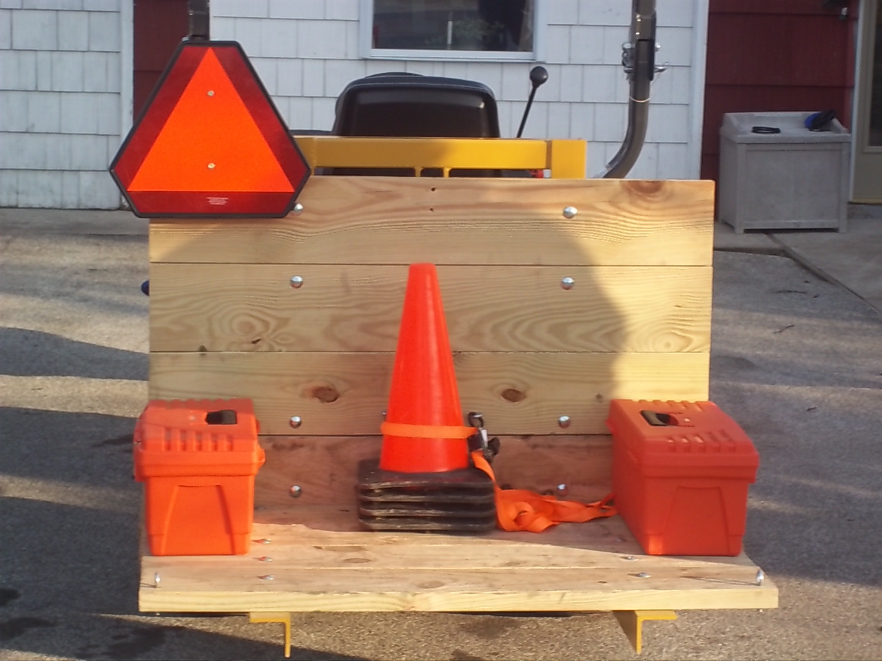

Here is the latest pic of the carryall. I moved the SMV sign to the side.

The main use of mine is for firewood. Both sides and the front are removable for other applications. Sometimes I stack cinder blocks in it for rear ballast. Put my generator in it for transporting to work area, etc. In this pic its on my previous tractor.
   / My Carryall Project #50
Thanks for the pictures. Good thread
