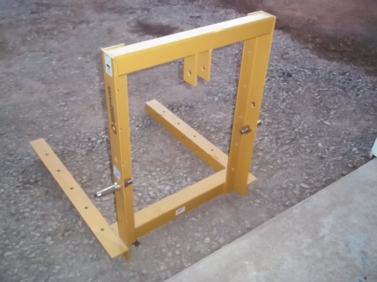

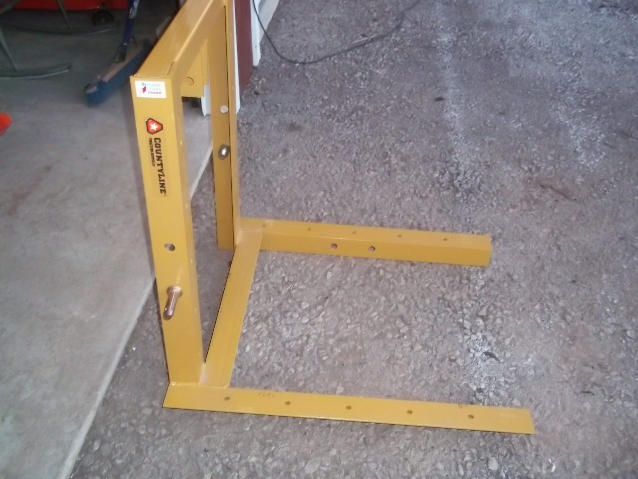

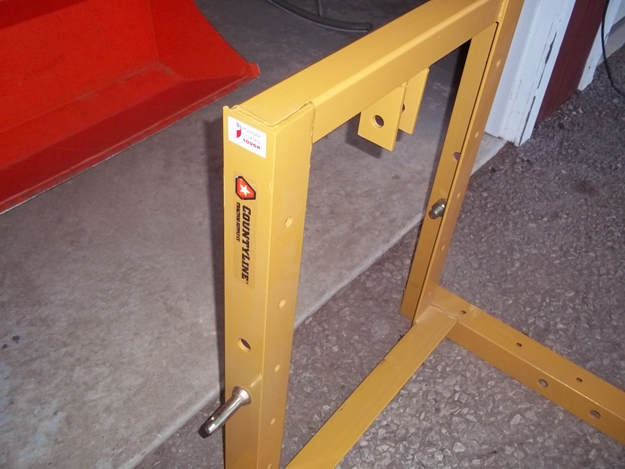

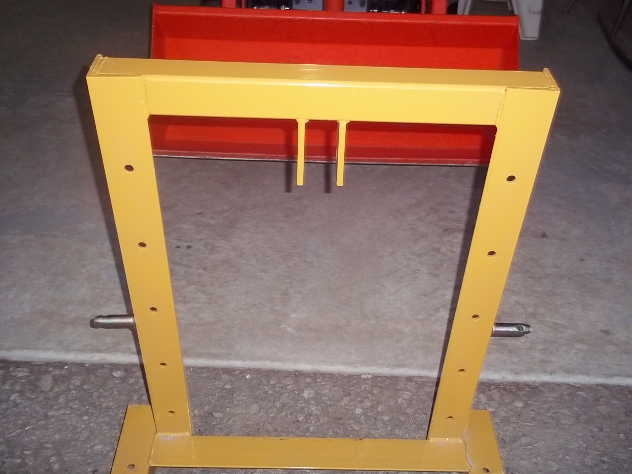

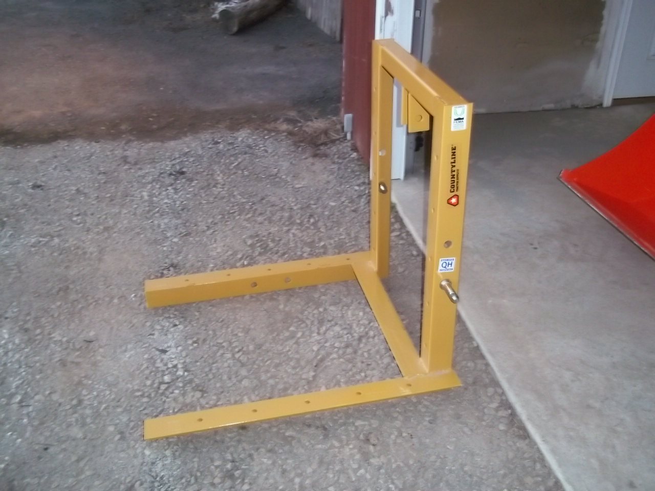

Here are some pictures of the carryall:

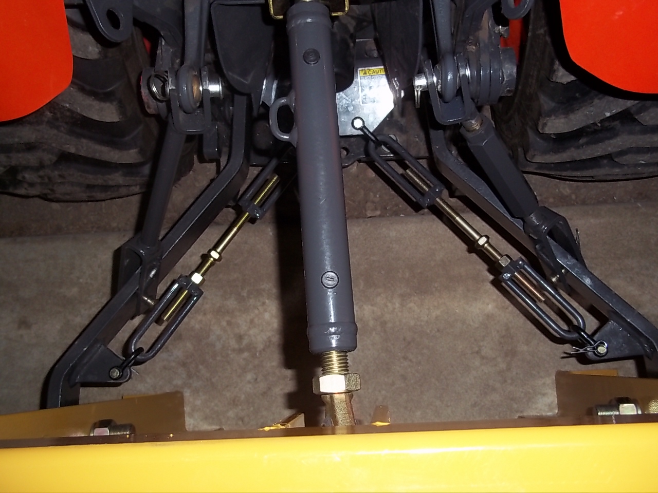

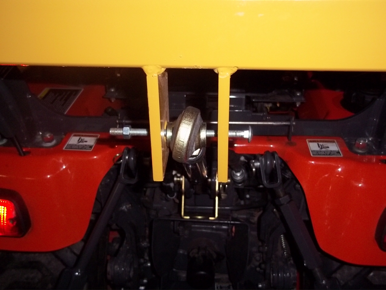

I was able to get it on after jury rigging a bolt where the top link goes. What kind of hardware do I need here? :confused:

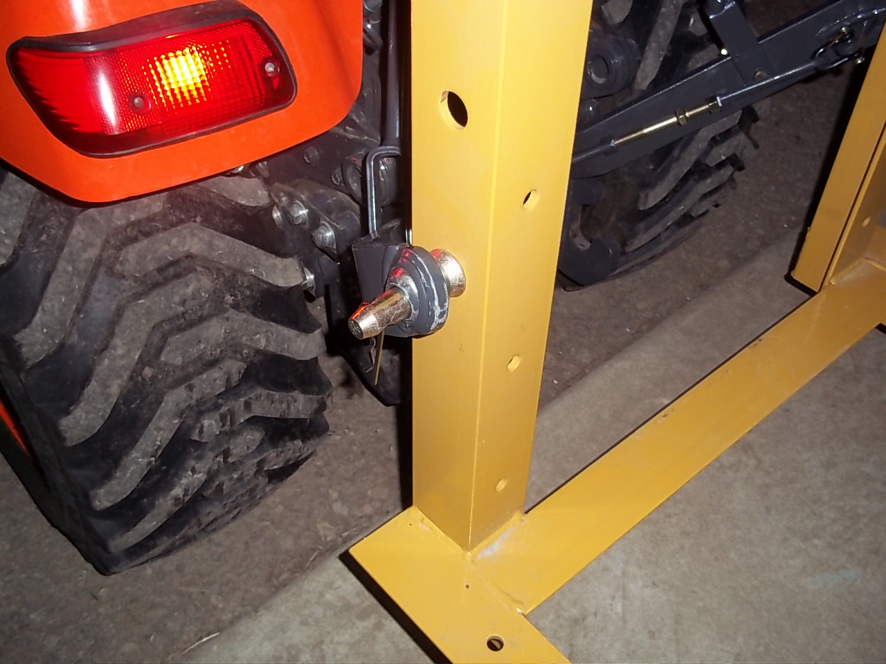

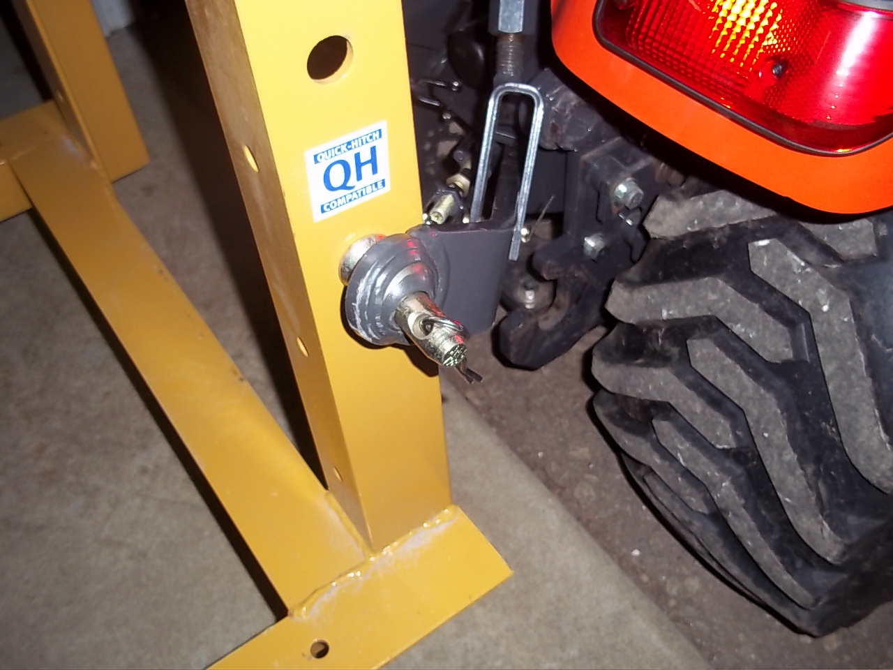

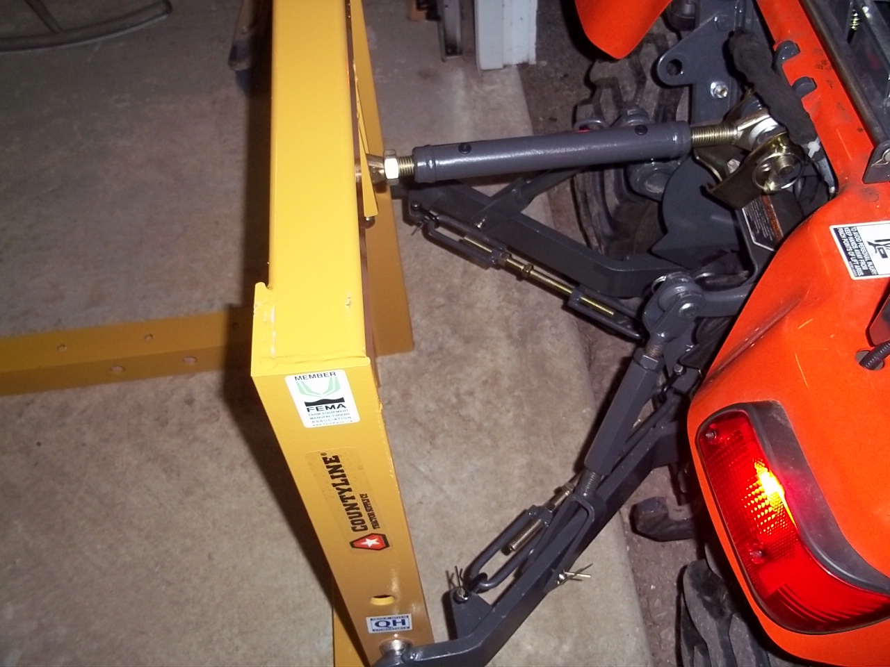

Also, what kind of hardware goes through the parts that attach to the lift arms? :confused: I'm just using some hitch pins I had laying around.

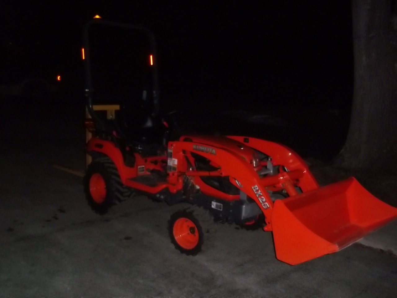

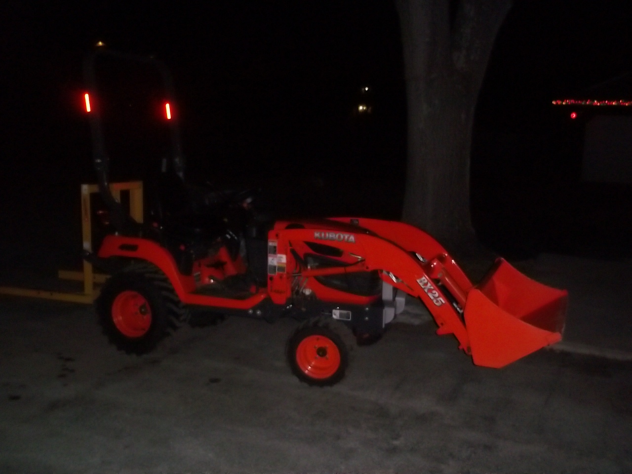

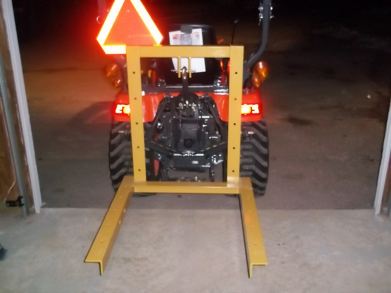

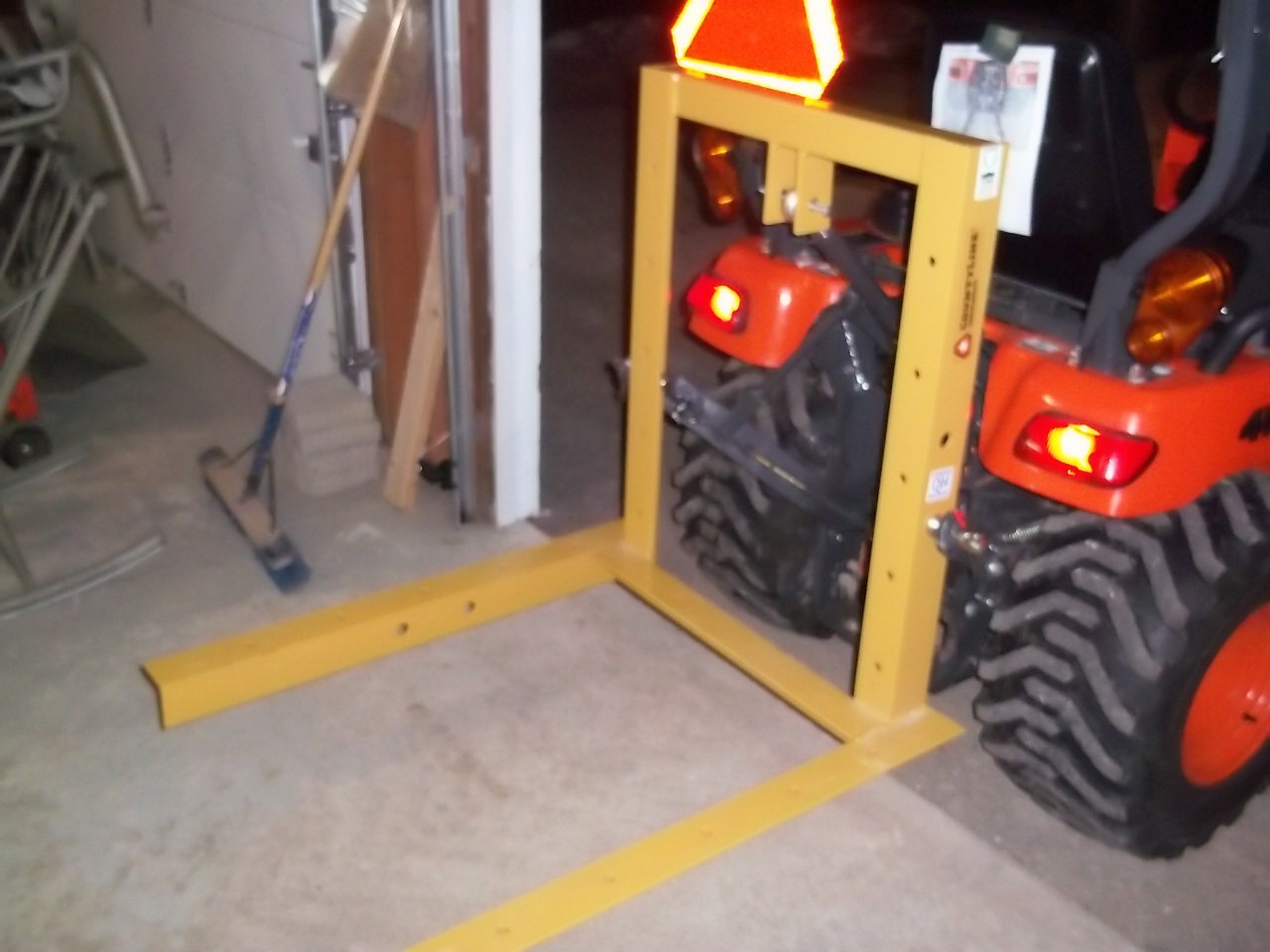

Here it is after I got it hooked up:

You need a Cat 1 top link pin. TSH has them but that means another trip. Looks like you need a long one.
Extra Long Top Link Pin, Cat 1 - 0265147 | Tractor Supply Company
The lower pins have a hole that a special bolt-like thing with a round spring on it - a lynch pin. Looking at TSC online should get you the pictures.
SpeeCo Lynch Pin, 7/16 in., 2 pcs. - 1834062 | Tractor Supply Company
Thanks! Actually both of them are also parts that are used to attach the toplink to the tractor.

Now all I need to do is buy some wood to make a platform...
   / My Carryall Saga... #11
Thats pretty slick Kyle. :thumbsup: I got to say, now that you bought your first implement, You will start looking for your next one. :laughing: With your carry all, get some lynch pins and a category 1 pin for the top. With the deck you want to put on it, It really would depend on what you plan to use it for. If it is more heavy duty used Than i would opt for the treated 2x8s. Plywood would really depend. I would recommend 3/4" thick so you still have the capacity that you will desire but it doesn't come cheap. To line up the holes when drilling, remove the carry all from the tractor and flip it up so the half facing the tractor when attached is flat on the ground. Then use "C" clamps and hold the lumber to the carry all so you can mark where the holes are to be drilled. When you get them drilled, use carriage bolts (flat heads) so you can slide things easily across the deck and tighten them down (using washers recommended).

Thanks!!! Already looking for more! (I think my parents are going to get a Trac Vac next year) Even though I will not carry very heavy loads on it (I think it is rated 500#), I'm leaning toward the 2x8's...Thanks for the mounting info! :thumbsup:

I was thinking of either doing that or using a piece of plywood. Would that work?
A piece of waterproof subflooring should work. It is expensive though and will eventually delaminate in the weather.
The 2x8 idea is worth consideration for long term durability.
