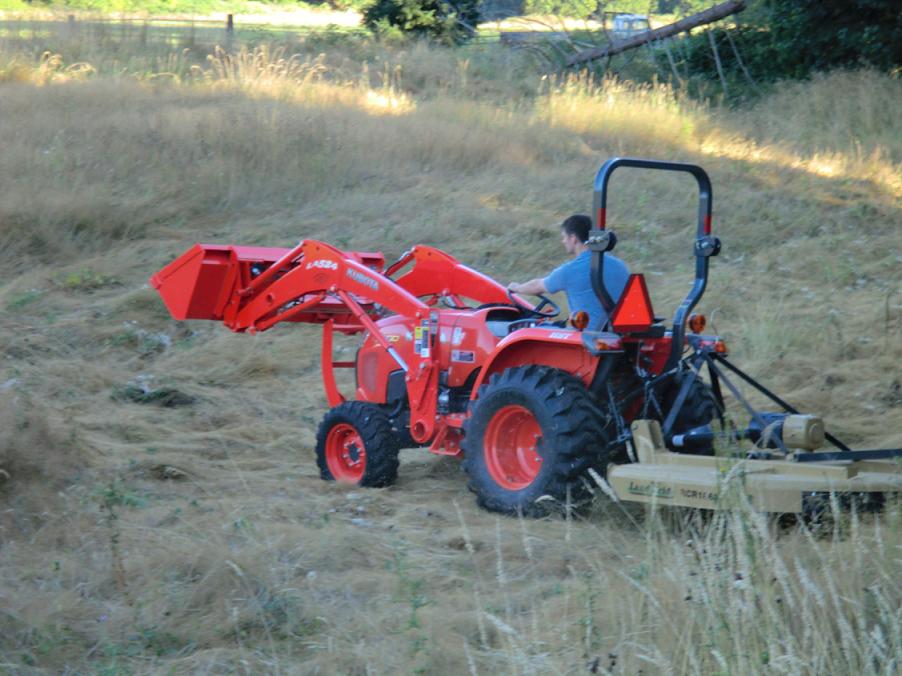

Today I had my new Kubota L3200 delivered. Though I have owned a Farmall Cub that I restored over 10 years, this new tractor is my first experience with a modern tractor with 3 point hitch or front end loader.
So I am looking forward to learning all I can about the possibilities that are now available to me that have been lacking in my trusty old Cub.
I have an overgrown 5 acre pasture that has very little level ground that I will be making more useable.
My package included a Landpride 60" cutter and a 72" Landpride box blade.
My seat time so far has been limited today, but I took a pic of my son mowing some of the tall grass in my pasture and it's attached.

Congrats to the new tractor. I had to laugh when I saw the "dirty" picture, you are not keeping a garage queen there. :thumbsup:
That tall grass really does a number on the radiator. Be sure to clean it out good.

I would recommend mowing with the bucket closer to the ground. It lowers the center of gravity and is your first line of defense for objects hidden in the weeds.

+1 what easygo says. Same applies to the air filter. When you do a bunch of really dusty work like that (after all, that's what it's for, right?), make a mental note that an air filter replacement should be done at an upcoming service, if not sooner. These little Kubota diesels are known for their longevity, but ingesting grit will shorten the life of any engine.

You might want to lower the FEL to just above ground level or so. That way the bucket will find any stumps/rocks 1st.
Also over time the lower the bucket is the longer it'll take to round out the 'O' rings that work your bucket.
No big thing but something you'll want to know about.

Thanks for the tips, I think I had the bucket lower most of the time, but have some steep hills that interfere, so raised it -- will make a point of it after hearing the collective wisdom.
I cleaned the radiator screen 3 times during my mowing. Watching the temp gauge carefully.
