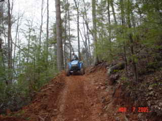

I am cutting some roads on my property in the mountains of NC. This is the first roads I have every built. Lots of hills and trees. Check out the pic.
Sherpa

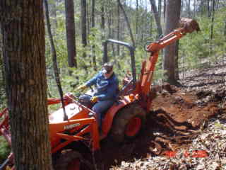

Big stump pic!

Finishing touches with the TC33 on the first road.

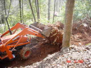

Another pic of kubota

That looks pretty fun. Nice job. Definitely put in some water bars or culverts to keep heavy rains from washing that fine work.

The first thing I thought when I saw your post was about drainage. For me, it's my biggest concern. Are you going to ditch the inside and use culverts to get it out, or slope the surface?
/ My first road
I havent decided about drainage at this point. I suppose I will slope the roads and see how that does. I was really nervous at first doing the road but man it was fun to see it take shape. I am really nervous about some down hill stuff I got to do. I have had the little backhoe for 2 years and just now got to do what I really bought it for. Its very exciting! I guess as long as I am nervous It will make me be careful.

Yes, I did all the work on this NC mountain slope with the little kubota B20. The only thing I did with the TC33 was run the pulveriser over the finished road to smooth it out.

I started to rent a dozer at $1150.00 per week. Then I thought to myself, this is the reason I bought the Kubota B20 TLB to start with. I started a road a year ago and couldnt get it turned right. I logger came to look at my timber and as he walked past my tractor he ask, why dont you cut your own road? I explain to him that I had started a road and showed it to him. He said follow me. We walked back up into the woods and he started marking limbs with ribbon. He said follow the ribbons and you can build your road. I took off on the tractor the next day and I been digging ever since. He said a dozer would do it faster but I already had the tractor and all the time in the world so I decided to do it myself. I also wanted small narror roads not big wide roads. I am very pleased with my progress.

I'm wondering about the method u used to do this. I assume you back up the road and use your back hoe to dig out what you need to, then what. Move the dirt off with backhoe or turn the tractor around and use the loader?
I have been using my loader w/ toothbar and box blade. A lot of times I will tilt the box blade to get the angle on the trail I need. What has been the most time effective way for you, and how long does it take you to go 20 or 30 yards? Never even really thought about using my back hoe.

I back up the road and dig with the backhoe off the high side of the slope and place and or drag the dirt to the lower side to form a ledge on the side of the mountain. I continue doing this for awhile and then I get my other tractor and go over it with the box blade or pulverisor. It turns it into a nice road. It goes very quickly as long as I dont hit rock or large tree roots. It really slows down if I have to cut a tree and dig up the stump. Its a real reward being able to do this yourself.
I am now driving on land that I had to walk, crawl or climb to just last week! I will post some more pics when I get back out there.
