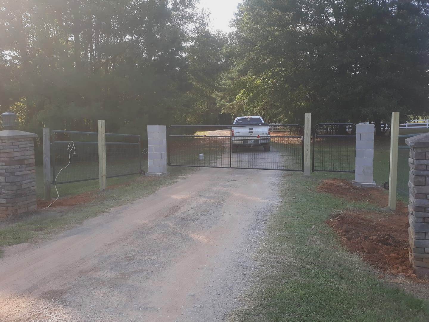

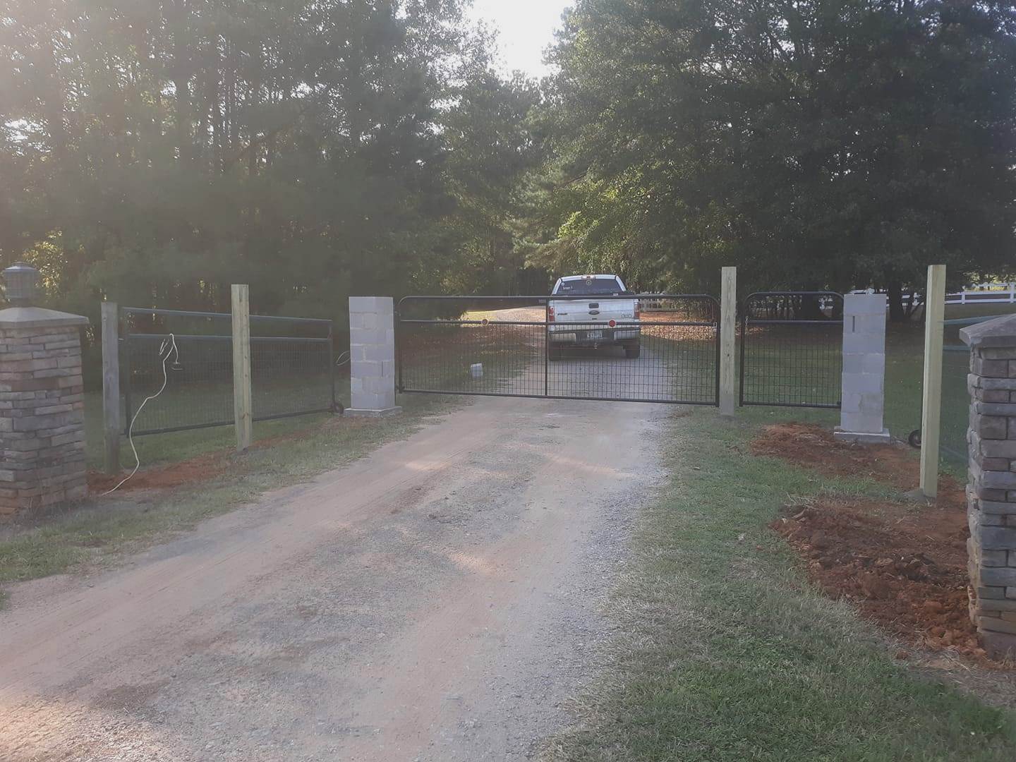

Wife was out of town for a dog show, so I tiled our bedroom floor. While waiting for the tile and then the grout to dry, I got a few things done on the front gate. The big gate is 14 feet and the small gate is 4 feet. I wanted it to be easy to walk through to get the mail. Eventually I'll put gravel down for the walk through gate and tie it into the driveway. Once the gates where installed, I set my post for the gate chains. I also set my posts for the 3 rail wood fence that will go on either side of the driveway. And since it was so nice out, I dug the trench and buried my electrical lines on both sides of the driveway.

I see that you've went with two separate gates; that eliminates the problems that I was envisioning with a double gate system.
I built an offset double gate frame for my neighbor to replace the wood gates that were coming apart. These are far lighter and stronger, a 2x4 top and bottom rail allows the existing dog ear fence boards to be reused. A drop rod holds the left leaf stationary in a socket concreted in, and the right leaf is just wide enough for a wheelie bin or pressure washer to get through. Works flawlessly.

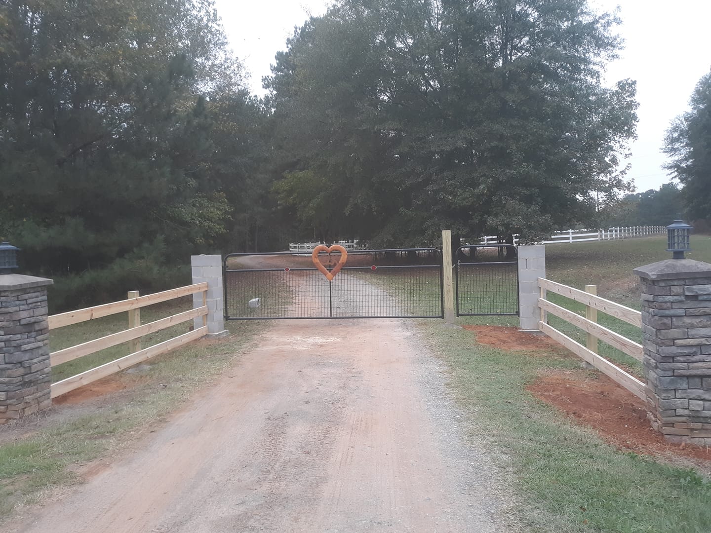

To dress up my gate a little, I decided to make a heart out of cedar for our farm logo.
I drew it out on a piece of half inch MDF, then cut that out for a template.
Then I glued some scrap pieces of cedar 2x6 together
Then I cut out some rusted metal that I thought would give me some nice contrast for the letters. It took 3 brand new blades to cut it out. I screwed the metal into the back of the Cedar Heart.
I drilled 4 holes into the gate and used self tapping screws to attach it to the gate. Then I coated it with Sherwin Williams oil based clear finish.

It's been a few weeks since I installed the opener. The instructions hurt my brain. I bought the basic unit, and then added featurs to it like the opener on the inside that you drive past and it opens the gate when you are leaving, and the button to push to open the gate from the outside, along with the remote controls to open the gate from our vehicles. The little screws that you tighten down for each wire are tricky. If you don't get it just right, the don't work. That was very frustrating to me. A week after having it all working, it stopped working and I found out that one of my power lines wasn't done right and it had worked itself out. My fault, but I really thought I had checked each wire real good before moving on to the next.
To attach the opener to the gate, they provided a stainless steel bracket and bolts. The bolts where fine thread. I used my impact driver to get them tight, which bent to bottom tube of the gate. I thought that was pretty tight, but it came loose that first week of using it. The threads where all stripped from me over tightening them, and I replaced them with some Grade 5 bolts and lock nuts. I also noticed that the gate is bending there, so I'm going to add a length of angle iron to the pipe to strengthen it.
Overall, we are very pleased with how it works.
To finish off the columns, I built two caps the same way I did the other columns a dozen years ago, give or take. I let the concrete cure in the form for a week, then did the other one and let it cure for a week. I used a sack and a half for each cap, which put them at 120 pounds, or so. I used my hay spears and a pallet to carry them to the columns and get them up high enough to slide them onto the columns. I have a bunch of almost empty sacks of Thinset mortar from tile jobs that i do, so I used that to anchor the caps on top of the columns.
I have two more LED post lights on order from Home Depot that I will install as soon as they get here.
