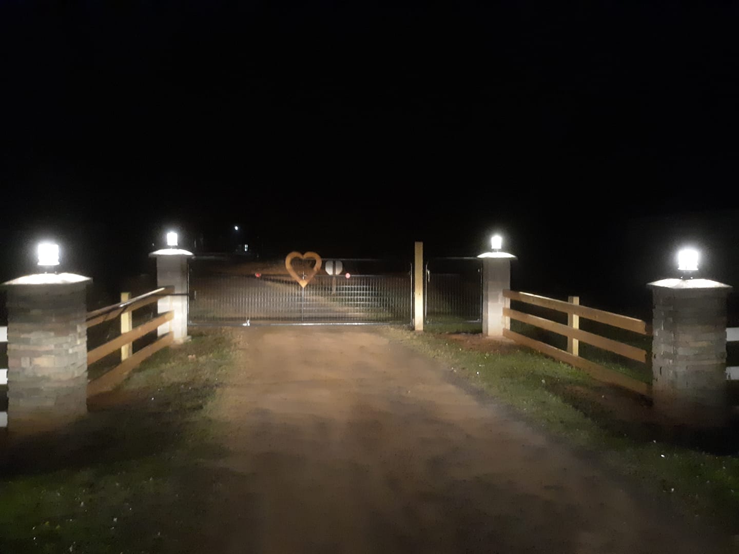

Before deciding on which opener to buy, I did a bunch of online searches to read as many reviews as I could, and watched more Youtube videos then I can remember. What's funny is that I never heard of the GTO opener. It never came up in any of my searches.
I think they bought Mighty Mule but might be mistaken. The GTO version like I have is much faster and is definitely heavier and better built. My best friend has the mighty mule setup on dual gates. Takes much longer to open but they still work well. The unit I have is more like entry level commercial verses residential grade.

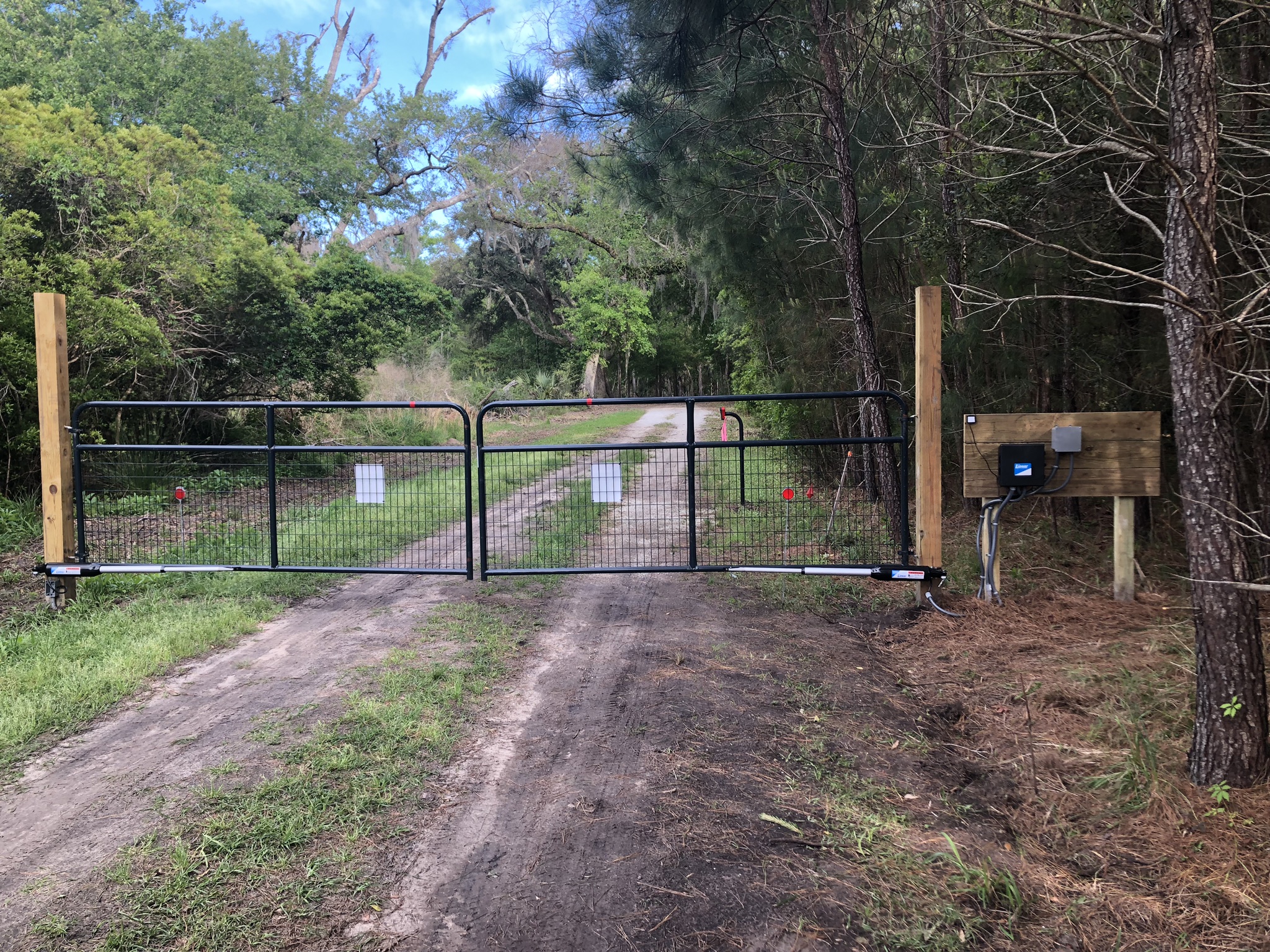

Took the gate cylinders apart this weekend. There was more than a cup of water in both of them. Cleaned out the weep holes, greased and put back together. My son also leveled one of the gates. Gates now open a lot faster. I hope they don't freeze but will have to wait for a few days to check. So guys remember to check the weep holes on everything this winter. I am lucky it didn't crack the plastic cases.

My mighty mule looks like a hydraulic cylinder on the outside, but it's just a tube over the screw. Ice had mine - definitely slow - for about 8 years; I replaced the motor with something off of eBay for about $50 last year.
I'm interested in this thread because I'm replacing my outer fence, going from 5' to about 7' and will be redoing our gate as well - moving it and going from a single ?10' to something like two 7' gates, custom design (... I need to find a crafter, my welding skills are not for public view!). Obviously I'll be replacing the opener as well.
Thanks for the link. For me, I decided that I did not want a hydraulic cylinder type of opener. Once I learned about the screw type openers, I felt that was a much better design for the long term. Only time will tell if I made the right choice.
